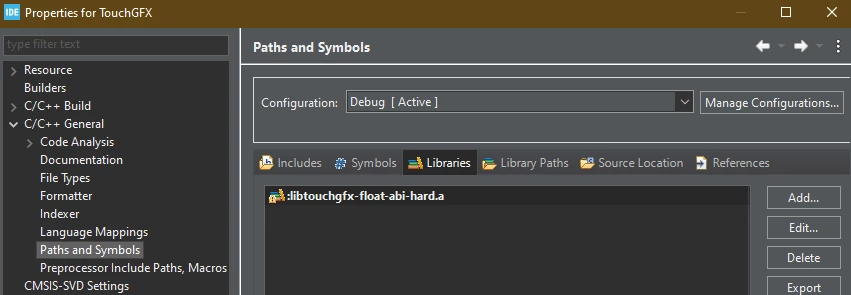

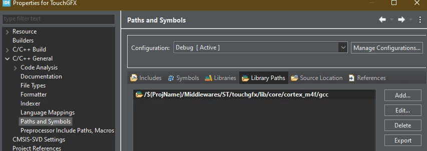

Could you post what you have in  :
  • your project properties ->c/c++ general -> paths and symbols ->library paths
  • your project properties ->c/c++ general -> paths and symbols ->libraries

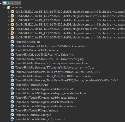

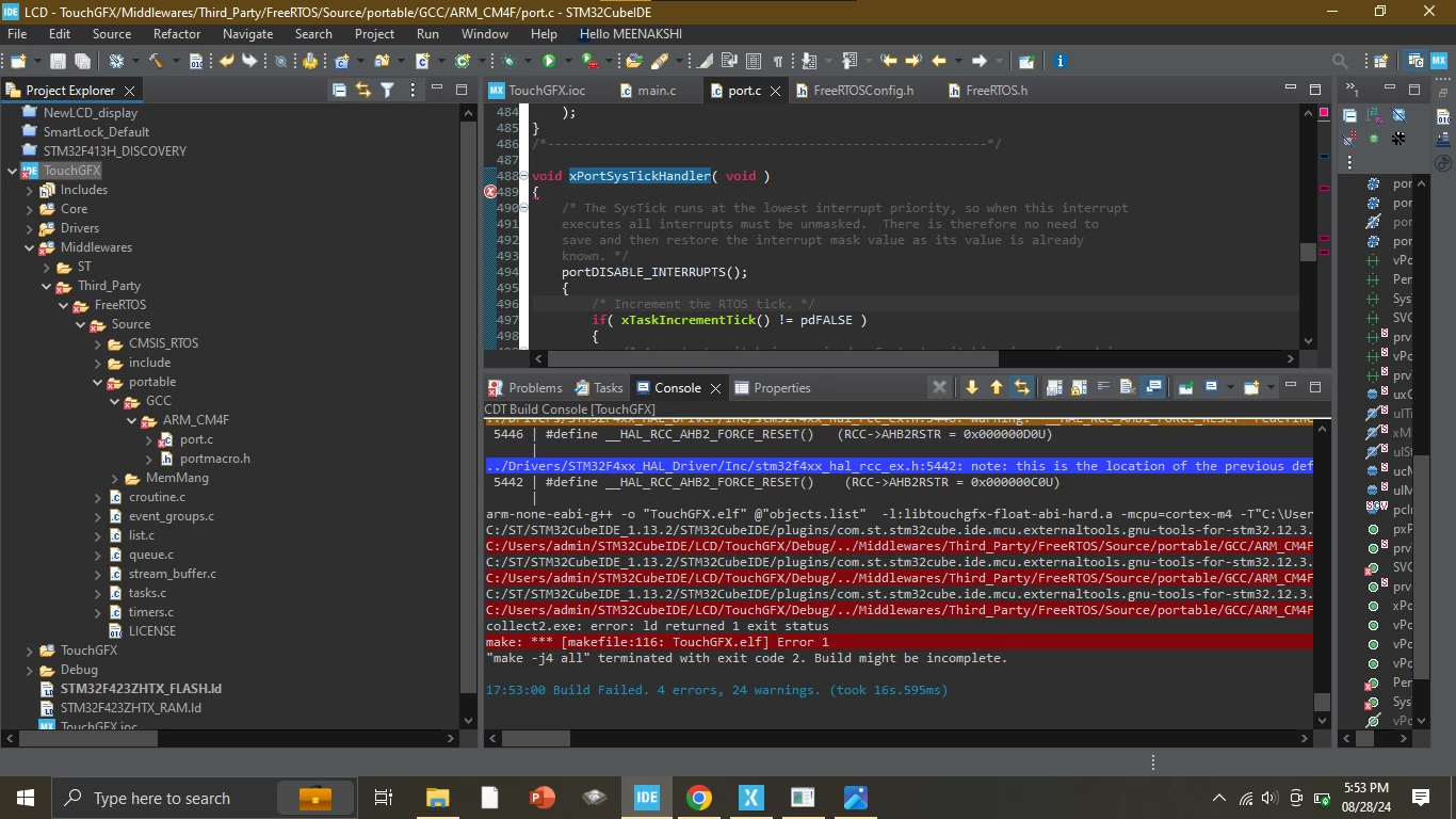

But still I got some errors:
There are my includes

Hello @Meenakshi ,
Did you regenerate in CubeMX and then regenerate in Designer ?
