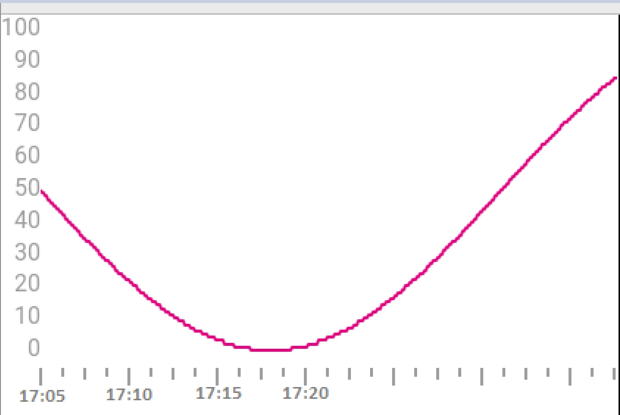

Good day everyone,
I am trying to use the existing dynamic graph in such a way, that the x-axis labels are using a timestamp rather than a simple incrementing number. This is what I currently have:
_legacyfs_online_stmicro_images_0693W00000bjbOmQAI.pngAnd this is what I need:

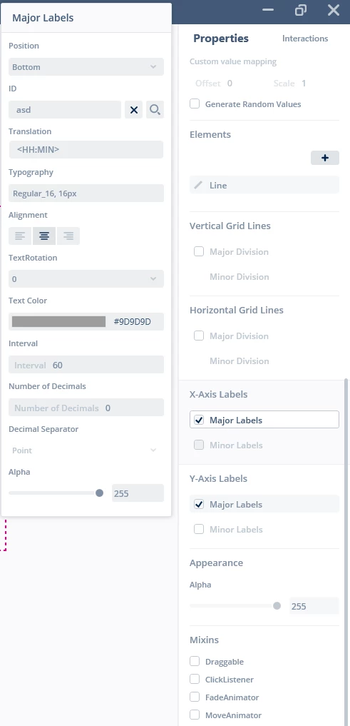

_legacyfs_online_stmicro_images_0693W00000bjbP1QAI.pngI guess I haven't fully understood the concept of wildcards, but this is currently the settings I have:
_legacyfs_online_stmicro_images_0693W00000bjbPBQAY.pngAny hint is highly appreciated as I found several posts like this in this forum but none of them got answered properly, so I hope that this post would clarify how to properly use the X-Axis Labels

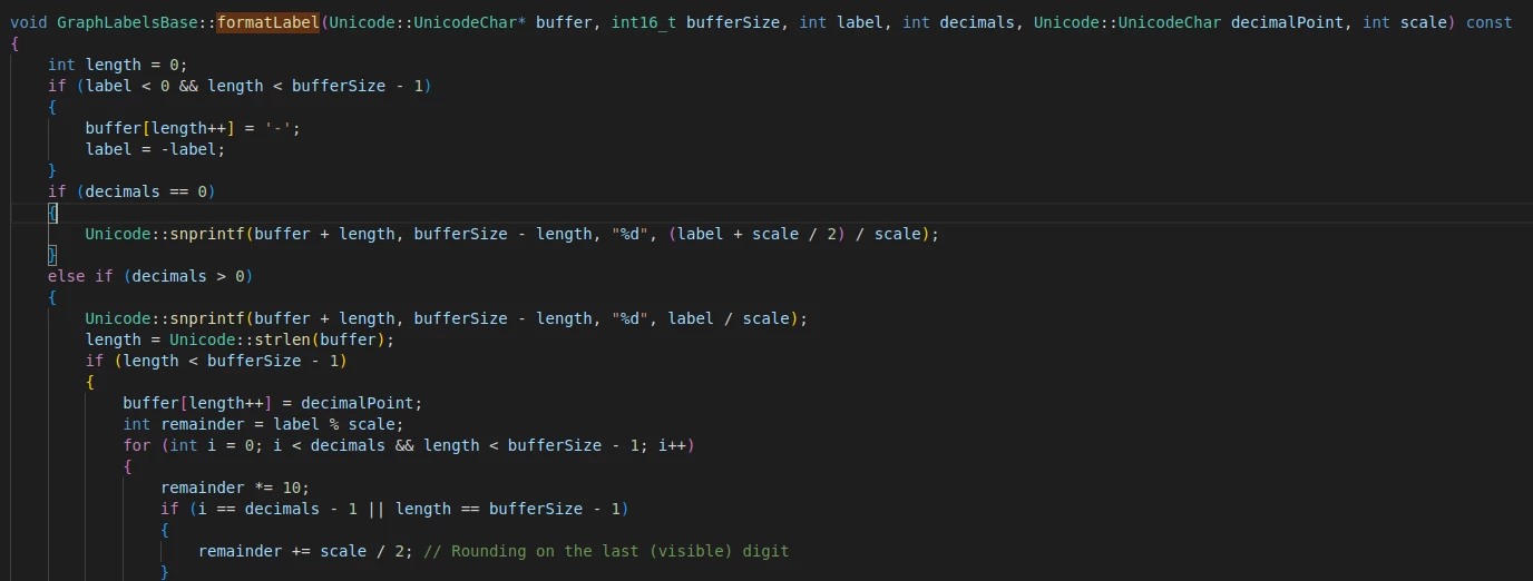

I probably found the place where the formatting of the Axis is done:
_legacyfs_online_stmicro_images_0693W00000bjbWvQAI.pngBut due to the fact, that the "formatLabel" method is not virtual, it seems that using the existing widget will no work for me, correct?
