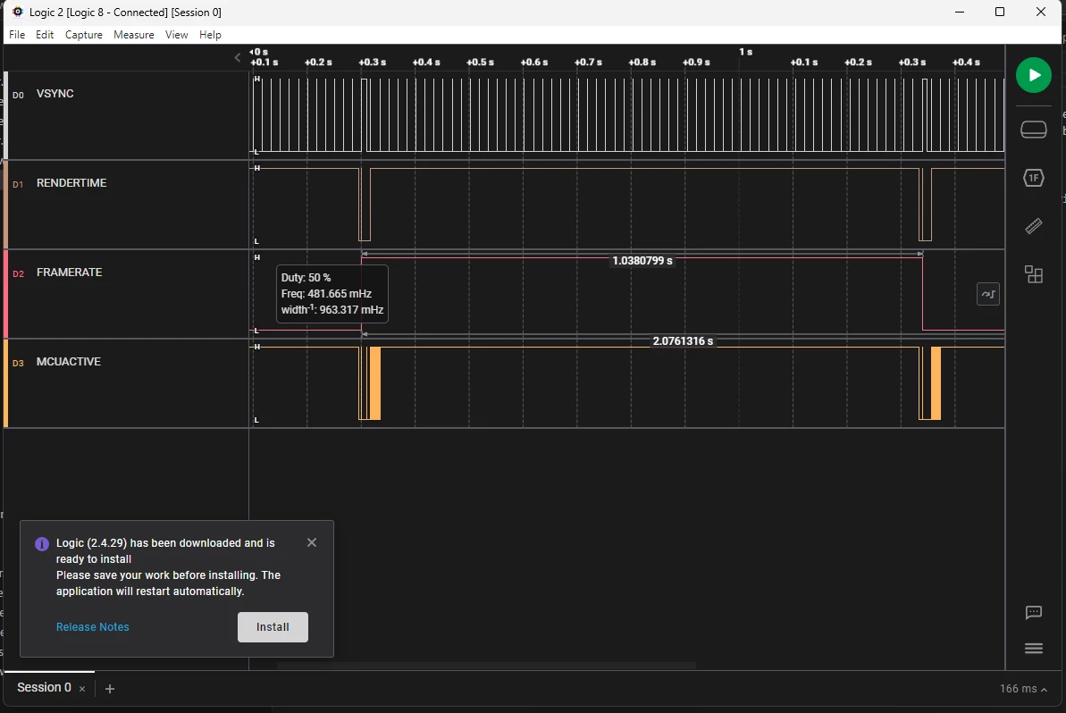

Here are some performance measurements from that:
This shows that for me, the acutal rendering of each screen takes almost 1 second when adding a data point every other tick. At the same time, the MCU is active during that entire period.
So basically, the MCU cannot handle the graph.
As I state earlier, the graph widget is surprisingly heavy to render, because all the points need to be connected. When using the scrolling graph mode, this is even worse, because all the points need to be updated every time a new point is added.

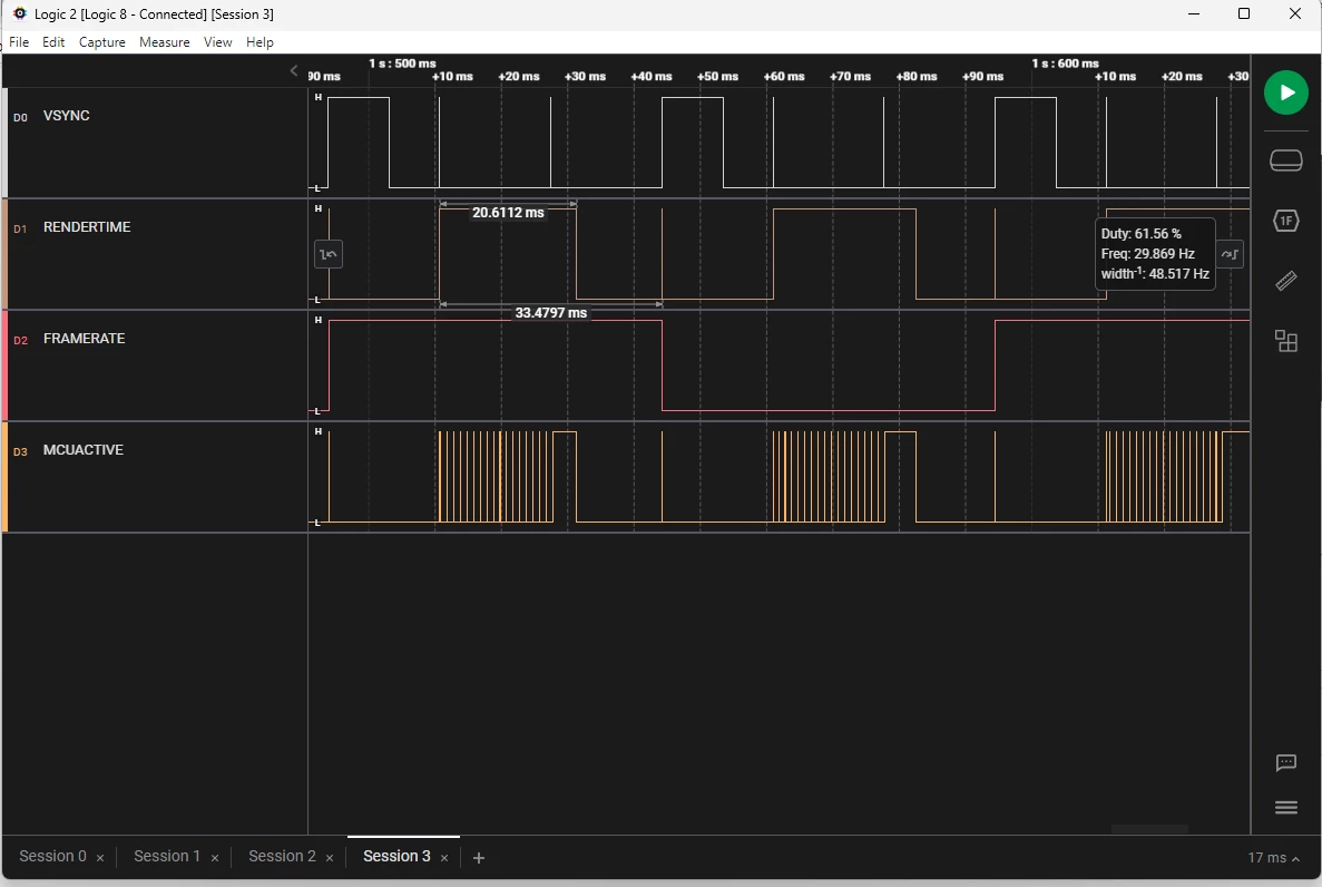

When using dots instead of lines in the "Elements" section of the graph, perfomance increases significantly, but the graph is pretty much ureadable with 300 points in the graph, and performance is still far from 60 fps:
Going back to lines, and using the "wrap and overwrite" mode of the graph and using a vertical frontline with a width of 4 pixels to make it easier to determine where new data is input, it gets pretty close to the 16 ms you need for 60 fps:
In this mode, there is practically no gain to be had from changing to points or altering the number of elements.

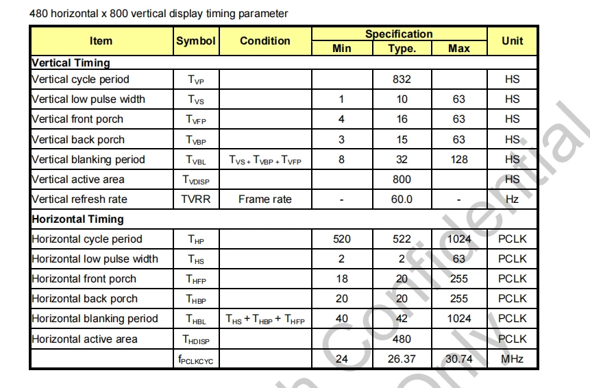

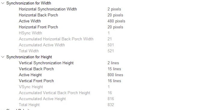

Other than that, your LTDC is not set up according to your table, which may be the reason you only see 40 fps when not adding points to the graph. What you want is this:
And an LTDC clock of 26.37 MHz. If you cannot get that clock, you can lower the porches as long as they are above the minimum values specified in your table until the timing is right.

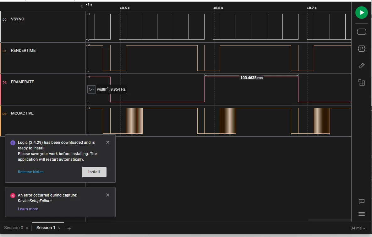

    2. second requires adding 50 - 100 points to the graph. I need to ensure 25 fps (In the DSI - command mode, the 25 fps screen is relatively smooth. However, in the DSI - video mode, the 25 fps screen still flickers. I think the actual screen fps should be higher to ensure no flickering), which means adding at most 2 - 4 points each time.
    3. I did another test and upload video. Do nothing after initializing the graph
