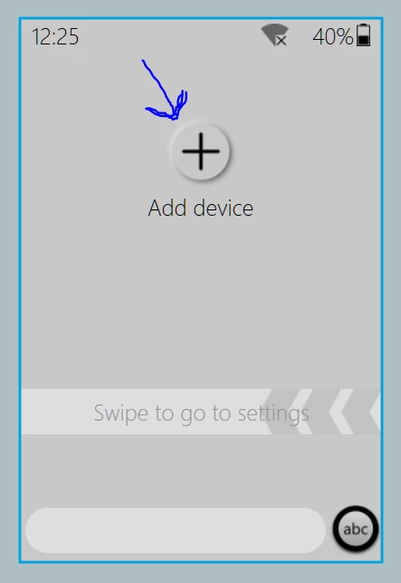

Step 1:
When you open the app, it will send you to the main screen, as you see below.
Press the add button.

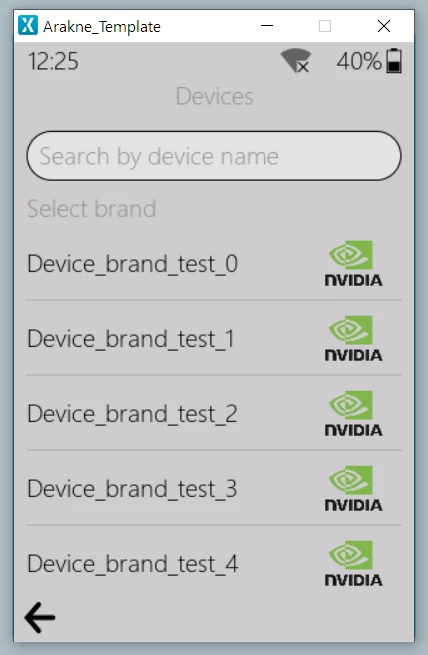

Step 2:
Now the screen below will be shown. Here you can select one of the elements from the list.

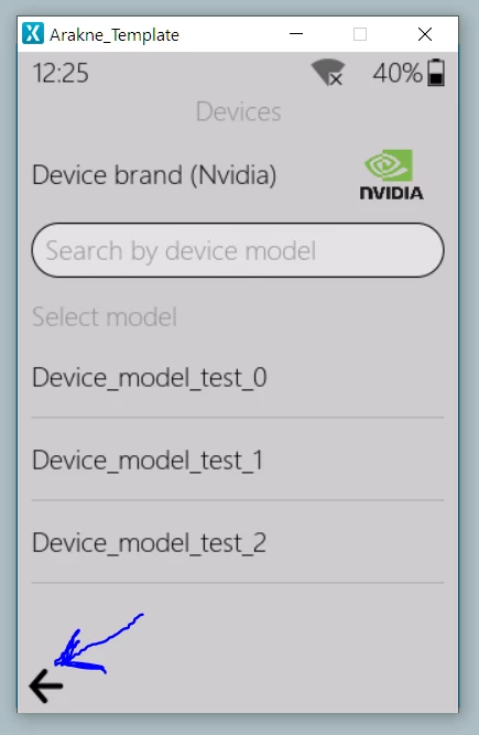

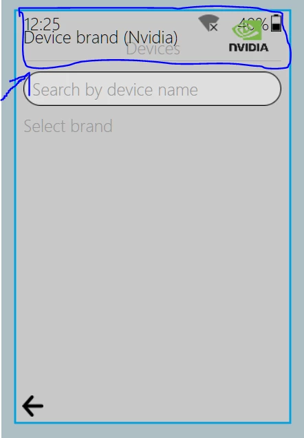

Now the screen below will be shown. The error occurs when you press the "back" button.
I have already found a work around, however I do not have a clue why it works. Let me explain you the work around:
Go to devicesScreen2 and add there the custom container I created which is called "deviceBrandItem", as shown in the figure below:
You can have this "deviceBrandItem" container as visible or invisible. Once you add this component, the error does not happen.
Can you please give me some explanation of what is going on? If I do something wrong, please let me know,
