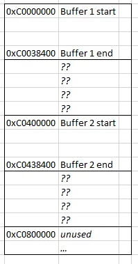

This is what my memory address space looks like (attached).
I've calculated how large my frameBuffer should be (320x240x24bpp/8 = 0x38400 bytes). There seem to be very large blocks of additional data appended to this raw pixel data (see ?? chunks in address space diagram). What is this additional information? Its HUGE.
I'm also noticing a single byte overlap at the end of my second framebuffer. So rather than ending at 0xC07FFFFF, there's a single byte being written into 0xC0800000.
This might explain my UNALIGNED hardfault. But it doesn't explain why it goes away after firing once. The memory misalignment persists, but the hardfaults don't keep happening.
Am I on to something here?
