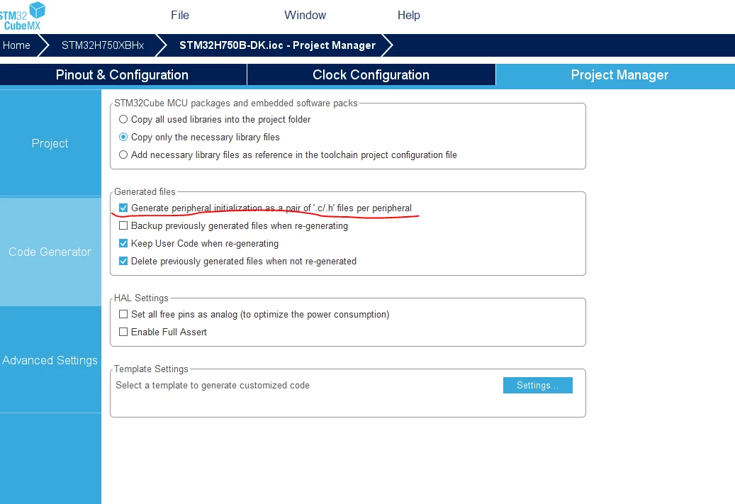

the project from designer is running correctly
then,i open the .ioc with cubeMX, select the option <generate peripheral intialization as a pair of .c/.h files per periphreal >,and re-generated the code , in running, the screen display nothing and checked the value of reg <ltdc->L1CFBAR> ,that is never changed at all

Could you provide some screenshot of your changes in CubeMX ?

Did you enable double framebuffer strategy from TouchGFX Generator? =)

I did
