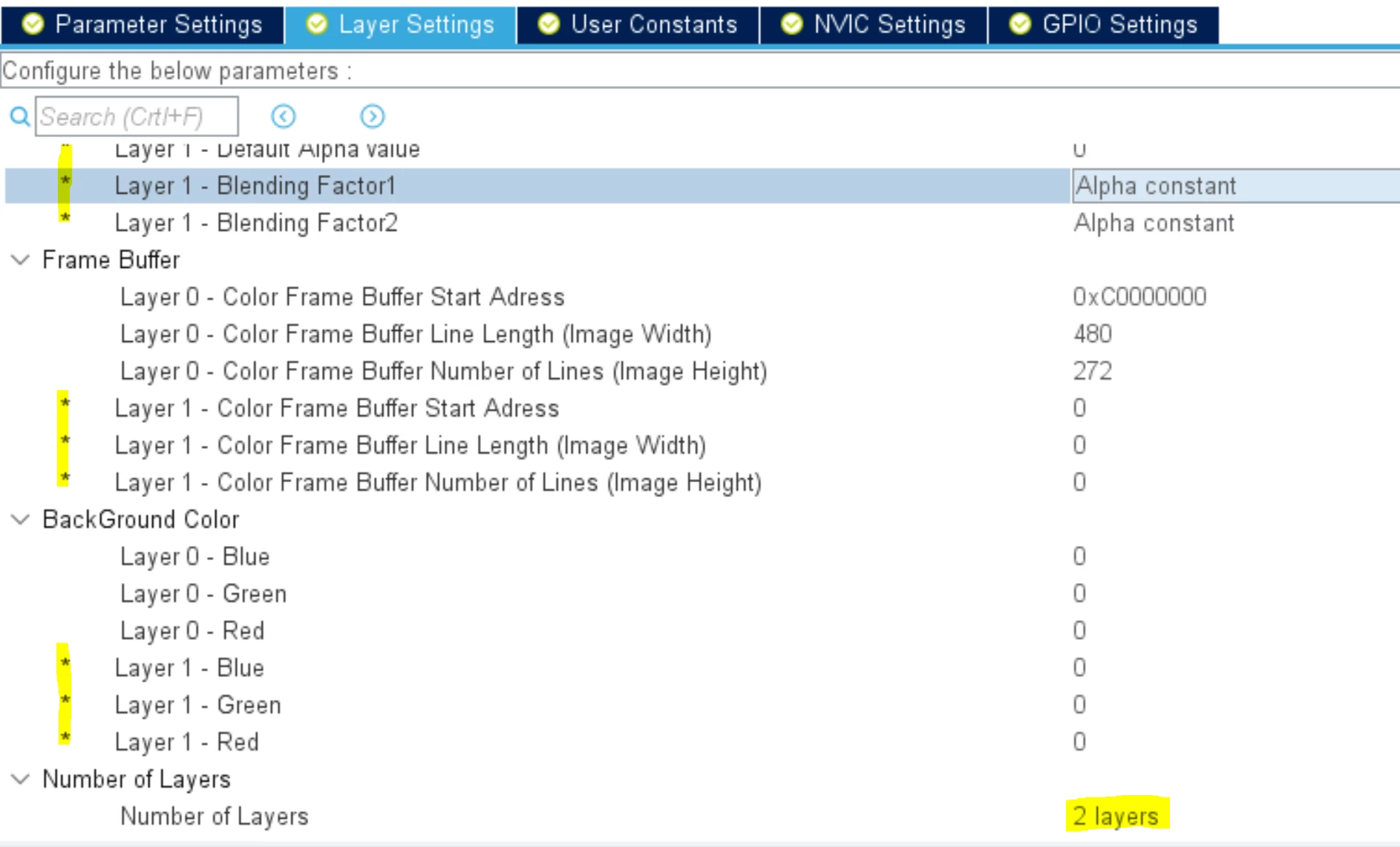

I was able to reproduce your problem (project deletion). I myself struggles a lot with getting things working in general with CubeMX within CubeIDE.
So one big personal advice from my experience : never use CubeMX inside CubeIDE. Using CubeMX within CubeIDE is, in my opinion, the best way to make your project not work.
Instead, use CubeMX, and CubeIDE only as an IDE to compile and debug. I'm confident that doing this works as I did it many times. Moreover, I migrated some projects to CubeMX 6.0.0, TouchGFX 4.14 and CubeIDE 1.4.0 and build/debug worked perfectly.
One thing that might be an issue for some board is that CubeMX generates code for the second layer, which should not be generated. So if you have a problem, set everything to 0 for this layer. It is called Layer 1 (and the first layer is Layer 0). You will find the Layer settings in the LTDC settings.
Please refer to the image below.
/Alexandre
