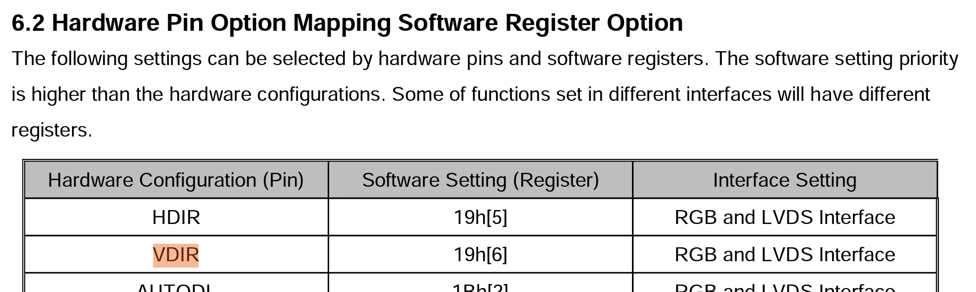

MM..1
Apr 11, 2024 4:05 PM UTC
Hi David, i understand your idea, when i start with TGFX i have project on DSI display , that require 180 swap and i create all gui upside down. Hard to see harder todo. But i mean this isnt part of TGFX job. Orientation on 90% displays is hw issue and registers or hw setup control this over driver. And drivers isnt part of TGFX.
David George
Apr 11, 2024 5:55 PM UTC
The registers you are talking about (Row, Column address increment control) are only used when transferring display data from the internal display RAM in the display controller. The display data in this internal RAM is usually sent using a slower I2C, SPI or a 8/16/18 bit MCU interface.
But when using a RGB video VSync, HSync, DotClk interface the display data bypasses the internal RAM and goes straight to the pixels at the frame rate its clocked in at.
So changing the Row, Column address increment registers will have no effect on the displayed image.
Why do we choose a RGB interface? Because its fast and allows 60Hz frame rates, and this is also the interface required by the LTDC in the STM32.
Sure not all displays are the same, but I bet in RGB video mode they all operate the same way.
MM..1
Apr 11, 2024 6:11 PM UTC
Show your display info and dont waste time with this theory. RGB dont define, that display skips internal memory, and some displays dont have internal memory and accept setups for rotation...
One example ST7262 800x480
David George
Apr 18, 2024 3:43 PM UTC
The display controller I'm currently using (ST7789V) does not have a HDIR or VDIR hardware pin.
But you got me thinking, I noticed the ST7789V does have a "RGB to RAM" mode (instead of sending the RGB data directly to the display shift register as I was), so I enabled this to hopefully send the data to the internal memory in the controller.
  • (B1h) RGBCTRL.WO = 1 (Direct RGB Mode to Memory)
Then I changed the Memory Data Access Control settings that control the RAM to Display addressing.
So to mirror the image I selected to X Swap, Y Swap.
  • (36h) MADCTRL.MX = 1  (Right to Left)
  • (36h) MADCTRL.MY = 1  (Bottom to Top)
Now my RGB image has been flipped 180 degrees just as I needed. Perfect, I learnt something today.
So thank you MM..1 for making me take a second look to solve this.
