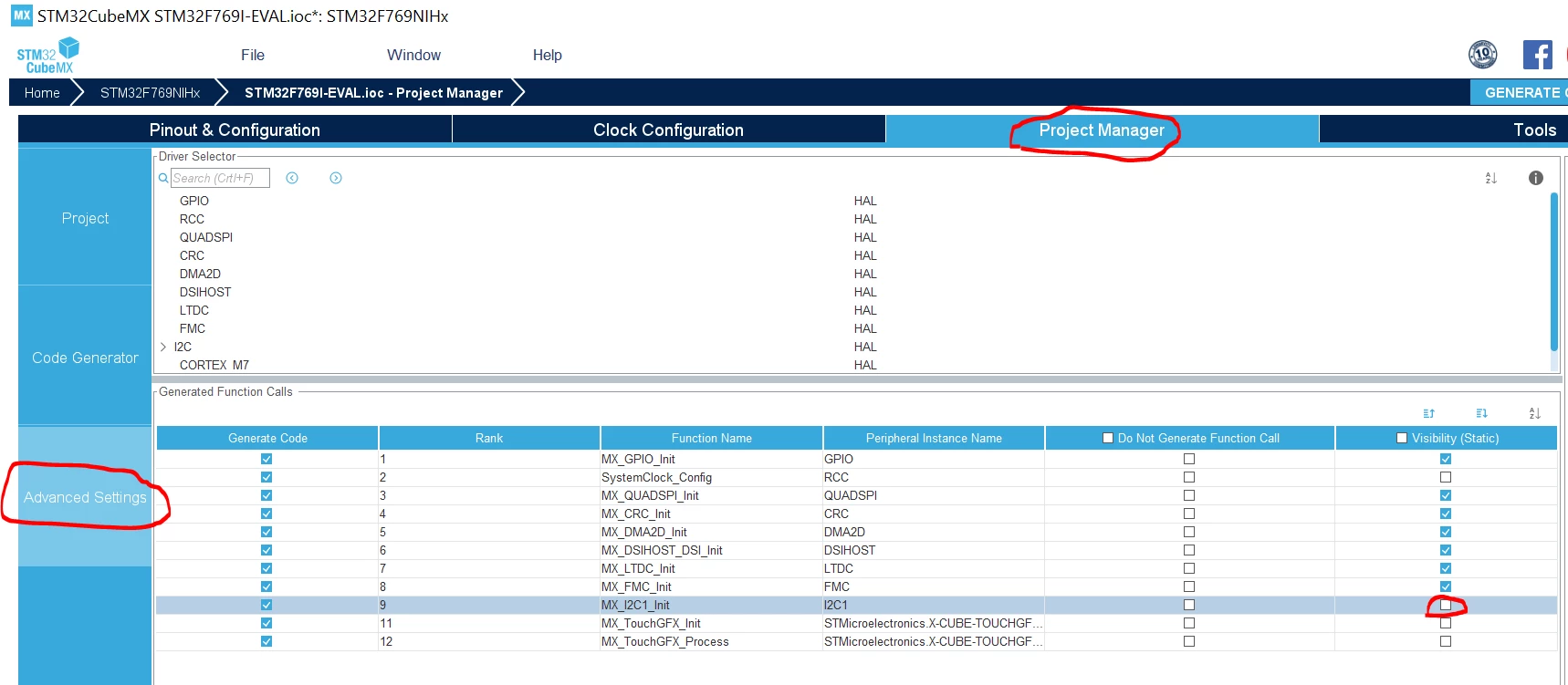

I am working on a project with stm32f769i-eval and touch gfx designer(4.13.0) .
I select my board as application template then I try both using a blank template or any of the examples that are provided.
After generating the code, I try to run the project on my target and even though it doesn't fail my screen is not displaying anything. (If I run on the simulator it works perfectly).
What should I do?
Thx,
Irene
Best answer by Romain DIELEMAN
It is because I actually received the same question earlier today and am working on it right now :grinning_face_with_sweat: There seems to be an issue with the application template available in TouchGFX Designer and the latest revision of the display (the A03) where the board goes to hard fault when the touch panel is initialized.
We are still investigating but in the meantime here is a workaround:
  • replace the STM32TouchController.cpp and hpp files in the TouchGFX/target folder of your project by the files I shared
  • open the ioc file in STM32CubeMX and go uncheck the box like in the screenshot to remove the "static" property of the MX_I2C1_Init() function.
/Romain

Looks like I get a Memory Management Fault here
  virtual void backPorchExited()
    swapFrameBuffers();
    tick();
No source available for touchgfx::HAL::tick() at 0x8008bc4
I tried to run the same project with another board stm32f779i-eval and I get no errors and display is working properly.

Update: When flashing an AT to target from within TouchGFX Designer the LCD Backlight is lit in addition to the blue LED being on.

The Board should be MB1219 J Release B-03 and the display MB1166-A03.

The workaround is working for me. Thank you very much.
