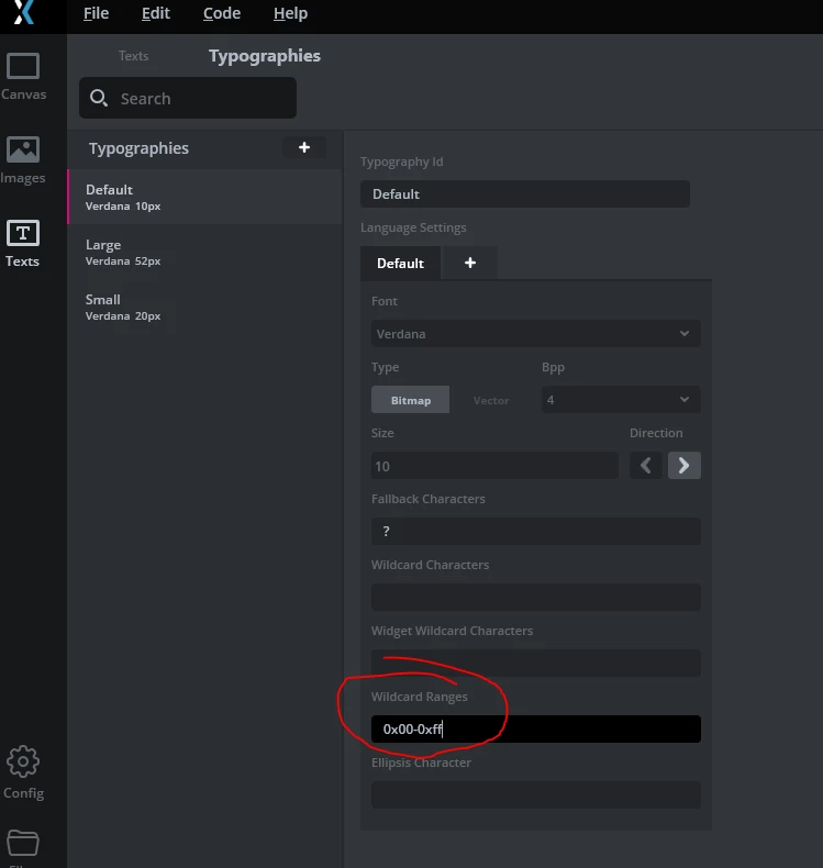

Dear all!
I 'm handle a project using ST7735 with flatform is TouchGFX, in Set2 is ADC value from POT( from -85 to -55) i debug and monitor on Keil C, the value is correct, When i display it to Screen the value is "-?5", i don't how to fix it, please share me why and how to fix.

    Hi @khanhcong861989 . Force including of characters from the font with '0x00-0xff'
    [Texts > Typographies > Default]

    And update the battery text area
    void Screen1View::setvaluetoscreen( int BAT_Val, int16_t pressure, int16_t set2, bool pump1_sta,bool valve1_sta,int16_t temp_pressure)
     Unicode::snprintf ( textArea7Buffer, TEXTAREA8_SIZE, "%d", BAT_Val);
     textArea7.invalidate ();
    Nov 1, 2024 1:15 AM UTC
    many thank @ferro issue was fixed, i can display set2. 1 more. may i add new fonts to touchGFX, how can i do it
