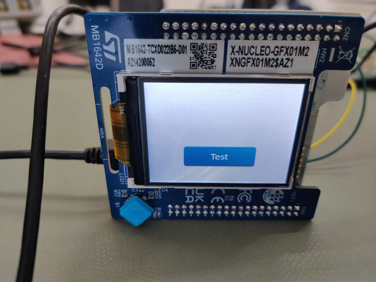

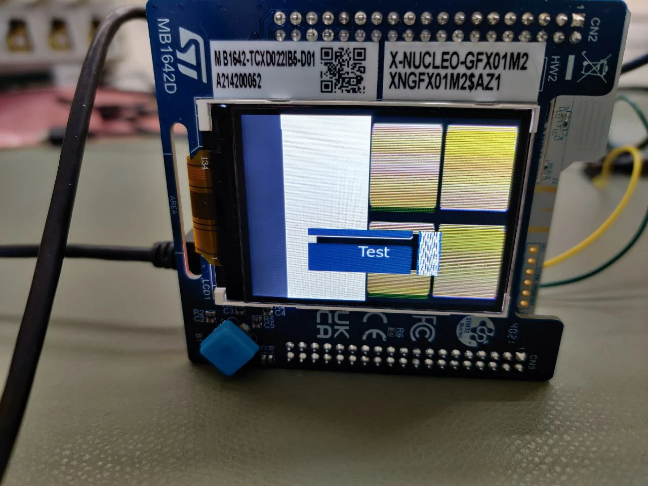

basically I've got myself STM32WB55 evaluation board and NUCLEO-GFX01M2 display module, to test out the TouchGFX Designer.
And right at the start I got a problem I can not solve myself. After I've created a simple project in Designer and flashed it on board, I tried to alter the code and opened the project in STM32CubeIDE, buildet it, and flashed again...and got a surprising picture.
What do I do wrong here?
Pic1: Designer flash.
Pic2: CubeIDE flash.
Thanky you!

Hi Roman,
Did you load the external flash?
RomanKreber
May 16, 2022
Hey egoltzman,
I would say NO. To be fair, I'm new to IDE and GFX.
All I did was "Run"-ing project created in Designer on CubeIDE.
I awaited to see the same window here, what was not the case.

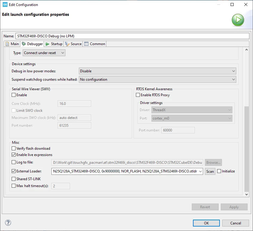

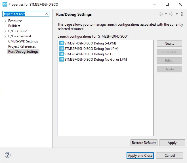

Since you say you are new to this, I thought I'd show you where that external loader is selected and enabled. You need to select and edit a Launch Configuration from the Run/Debug Settings under your Project->Properties:
0693W00000Nq6PwQAJ.pngThen on the Debugger Tab, scroll all the way down and you will see the external Loader option (mine is a different file than yours).
0693W00000Nq6QGQAZ.pngAlso, to optimize loading time, you can copy your Launch Configuration and modify it to NOT enable the external loader. Whenever you make GUI changes and then want to debug, use the configuration with the loader enabled. If no GUI changes have occurred since your last debugging session, use the configuration with the loader disabled. There is no need to have the external loader run if you already have the latest GUI changes in flash.

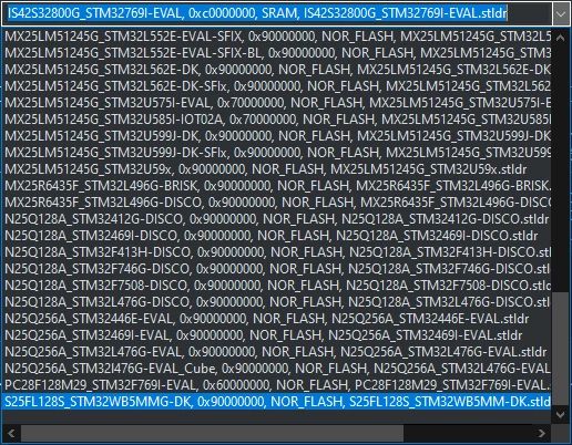

RomanKreber
May 18, 2022
Hey egoltzman,
thanks for your replay. I can't evene find this kind of external QSPI. I chosed another one, at the very beginning, and it seems to not work properly:
I've had S25FL128S_STM32WB5MMG-DK, 0x90000000, NOR_FLASH, S25FL128S_STM32WB5MM-DK.stldr selected.
