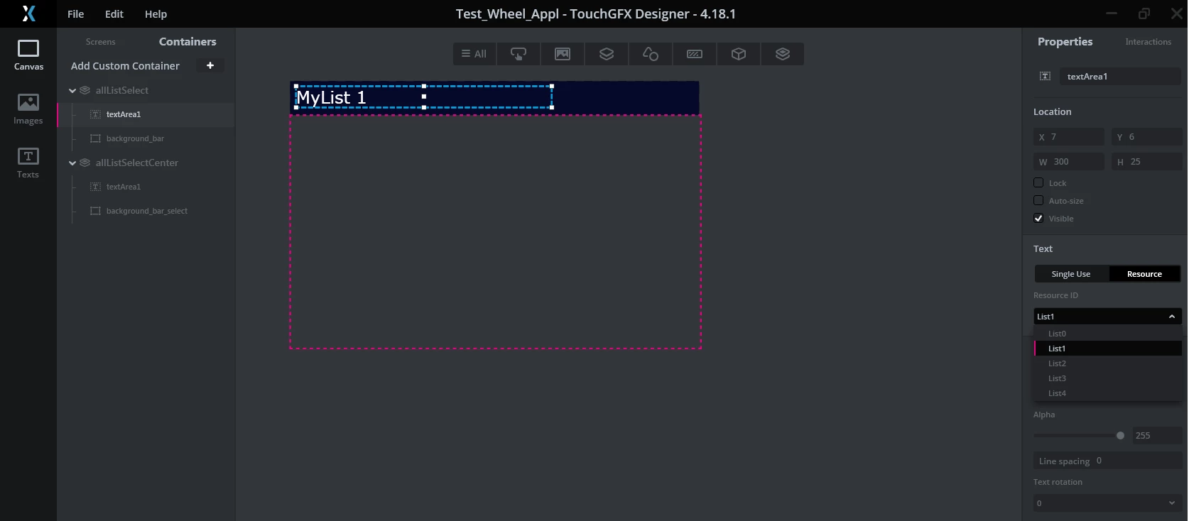

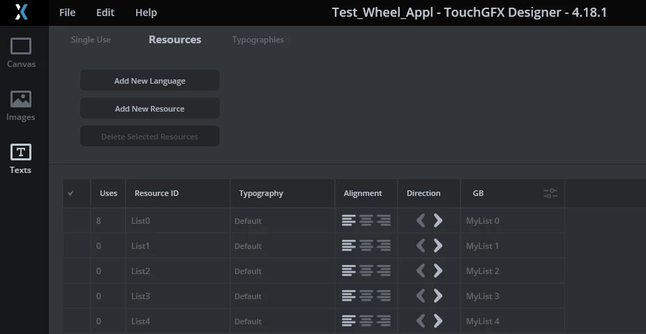

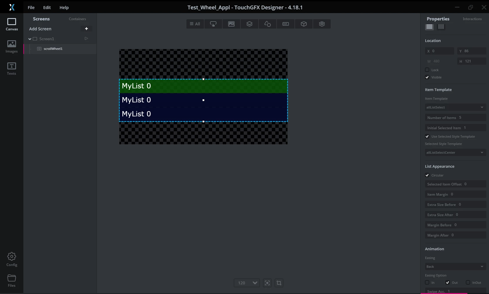

2) I use Scroll wheel in a simple project to show different elements... i configure the custom container with the different elements written in resources.. (my LIST 0, my LIST 1 etc.. until 4) so 5 elements.
When i use the scroll in the simulator i don't see the wheel scroll, i see always the first element. I check the config about scroll wheel i select 5 elements.. but nothing i don't see the scroll change. I attach the screenshots and also the projects.
maybe i forget to configure something.. i review this projects several ties but i don't understand what i have to change.

From your empty screen cpp code seems , as you dont understand how use touchgfx.
This isnt paintbrush, need write some code ...
Try read docu or examples Tutorial 4: Creating a Scroll Wheel with Custom Behavior | TouchGFX Documentation

Yes, i have modified the user code files like described in the link that you have attached and now it works correctly.
I have modified custom_container and screenView files like described in the link above.
Thanks. SOLVED.
