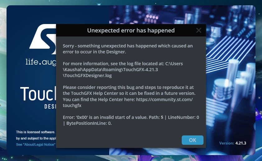

 last time also this problem was occured so I installed it again after that it run for some days now again the problem has occured.
 When I open Touchgfx one msg come
Sorry - something unexpected has happened which caused an error to occur in the Designer.
For more information, see the log file located at: C:\Users\Kaushal\AppData\Roaming\TouchGFX-4.21.3\TouchGFXDesigner.log
Please someone help to give the solution of it.

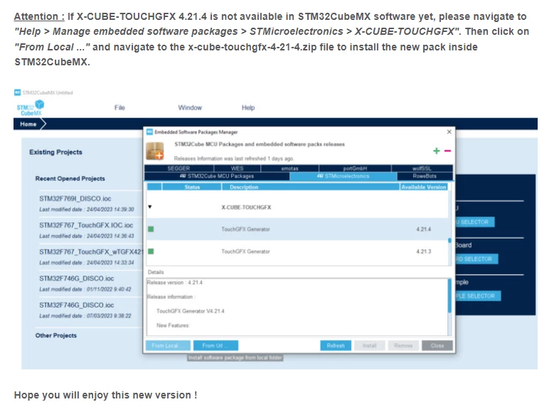

Best answer by Yoann KLEIN
Hello @MPath.4​,
You can manually install the generator, by following the steps described at the bottom of this post.
/Yoann

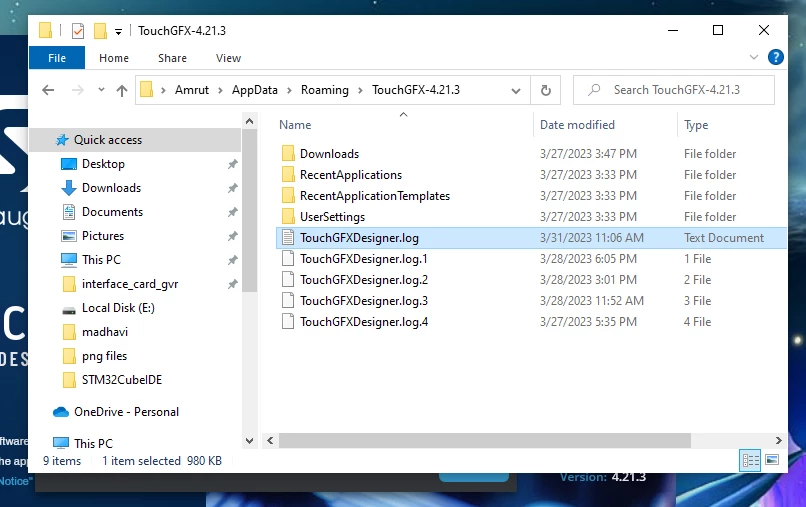

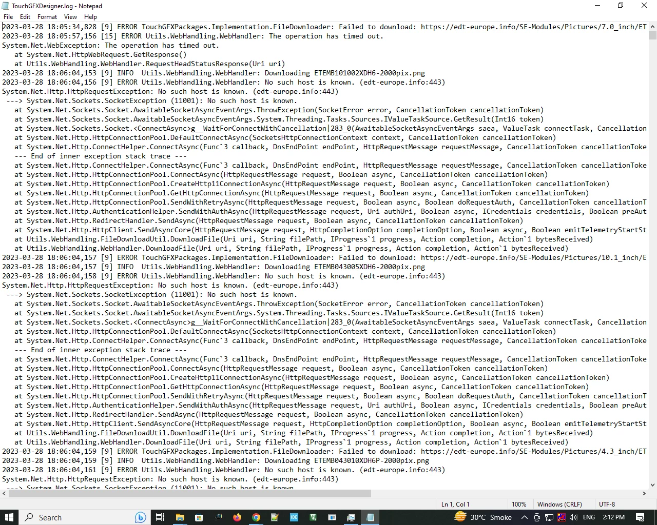

Hello @MPath.4​,
When does that happen? Right after launching TouchGFXDesigner? Or after doing something specific while designing your application?
Could you also share the log file you referred to?
Thank you.
/Yoann

Yoann KLEIN
April 3, 2023
Could you share the whole .log file ? Would be better for debugging.

I download the version 4.20.0 of Touchgfx designer and it's working then why the version 4.21.3 is not working.
Yoann KLEIN
April 11, 2023
I discussed your issue with my colleagues and we think that it could come from something written under a wrong format inside the .touchgfx file of your project.
Could you please share it here so we can check that ?

This file looks empty or erroneous, did you modify it before sharing it ?
/Yoann
