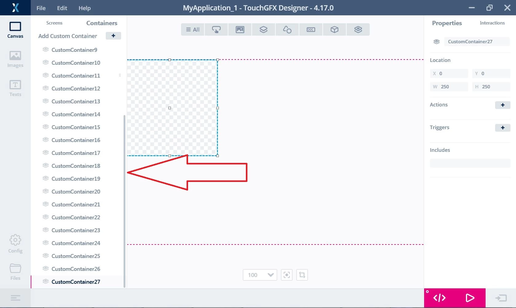

TouchGFX Designer hangs when scrolling.
Hi, I want to report a problem in TouchGFX Designer, when a project has some widgets and containers in the custom containers tab and it needs to scroll down in the left bar, when I scroll down to the end of the list by mouse scroll wheel, the designer doesn't response to anything anymore and has to be terminated by the task manager.

Ok great, we'll try to have that fixed for the next version, I'll keep you updated. Meantime, I can only recommend you to use an other scale than 125%.

Thank you for reporting this. It is a known issue we are working on. Could you share your project ? I cannot seem to replicate this issue, but you are not the first one that face it.

I've found out that this problem is somehow related to GPU driver(Intel(R) HD Graphics 530). When I uninstall the driver the resolution becomes ugly but the problem isn't happening.
I've tested this project on other computers and some of them had the problem.

We have the same problem with version 4.18.1. It seems to appear only with high screen resolutions (2560x1440). With a resolution of 1920x1080 the problem does not occur.

Thanks for these information. We have investigated that issue and we think the issue can be related to the "Scale an layout" parameter on Windows Settings. Indeed, we can reproduce the bug when we have "125%" value for example, but we can't reproduce it with "100%" value. Can I ask you what's your "Scale and layout" value on your Windows settings ?

You are right, using the 125% setting causes the problem. With a scale of 100% it works fine, regardless of the screen resolution:thumbs_up:
