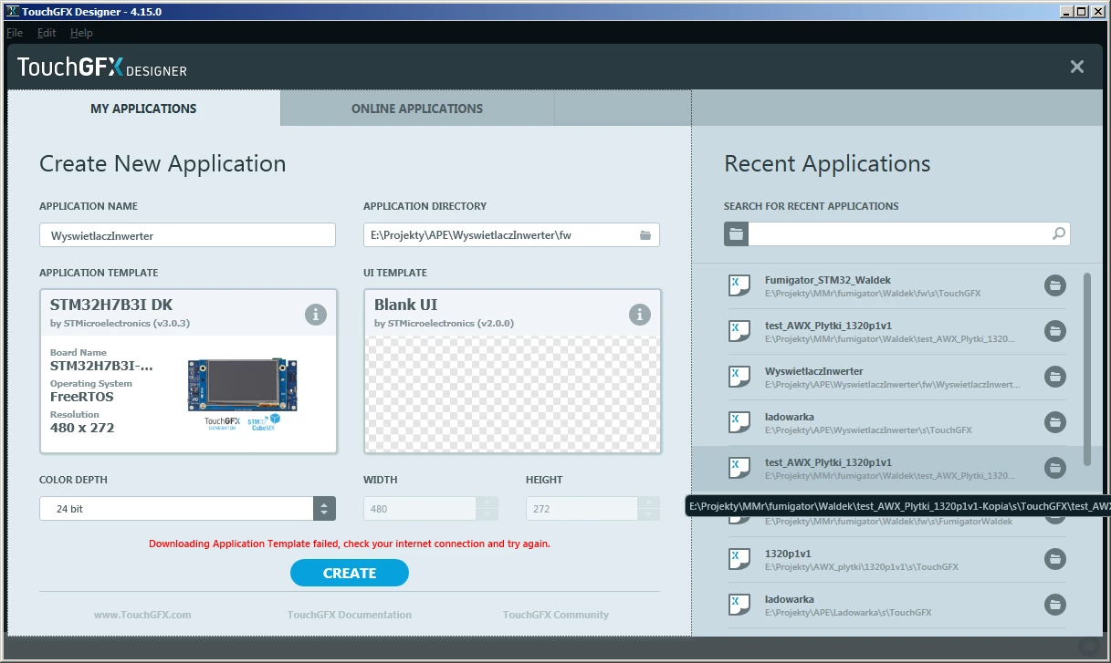

I'm trying to create new project with STM32H7B3I-DK and the following error is reporter. Designer version 4.15.0
Log file contents from today:

Best answer by Alexandre RENOUX
Please load a page on your favorite browser before trying to create your project and tell me if you still have the issue.
/Alexandre

Tomasz Ozon
November 27, 2020
Supprisingly it worked today just fine. I've tried yesterday and the result was not OK, but today it works. I'm sure it was not my internet connection, because I could see TouchGFX downloading some data and after that error message appeared.
Anyway, thank for helping with the issue, I can go back to my project now.

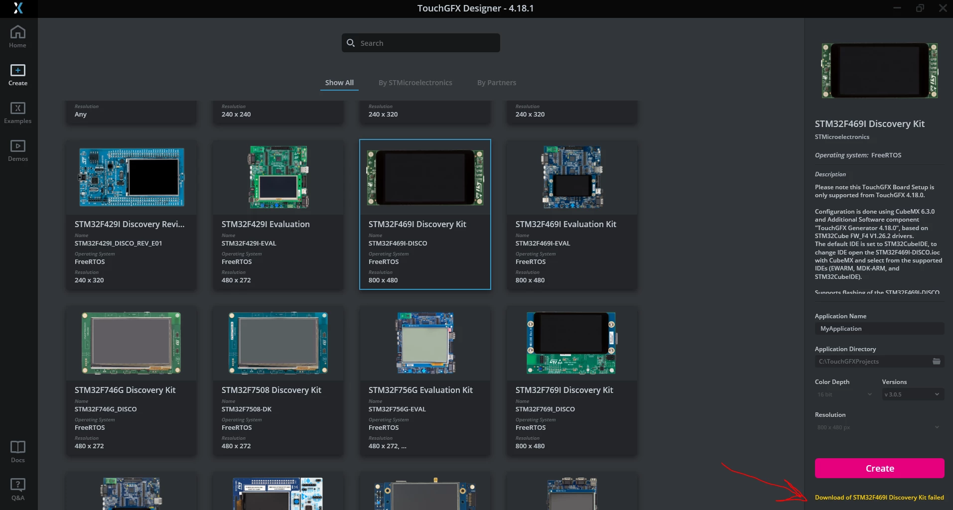

@Romain DIELEMAN​
Hi
I'm having the same problem.
Tried your solutions but I was not successful.
Thanks,
Mas
Romain DIELEMAN
January 25, 2022
Close TouchGFX Designer before opening a browser like Microsoft Edge and reopen it. This error message can also appear when your internet connection struggles downloading the packages due to its size/your internet connection speed. So you might need to try a few times unfortunately or download directly the TBS through this link for the STM32F469I Discovery kit:
https://sw-center-st-com.s3.eu-west-1.amazonaws.com/touchgfx/pacman/4.18.0/STM32F469I-DISCO/STM32F469I-DISCO-3.0.5.zip
/Romain
Mas1
Visitor II
January 25, 2022
@Romain DIELEMAN​
Thanks so much
it is fixed
Thanks for your prompt response
