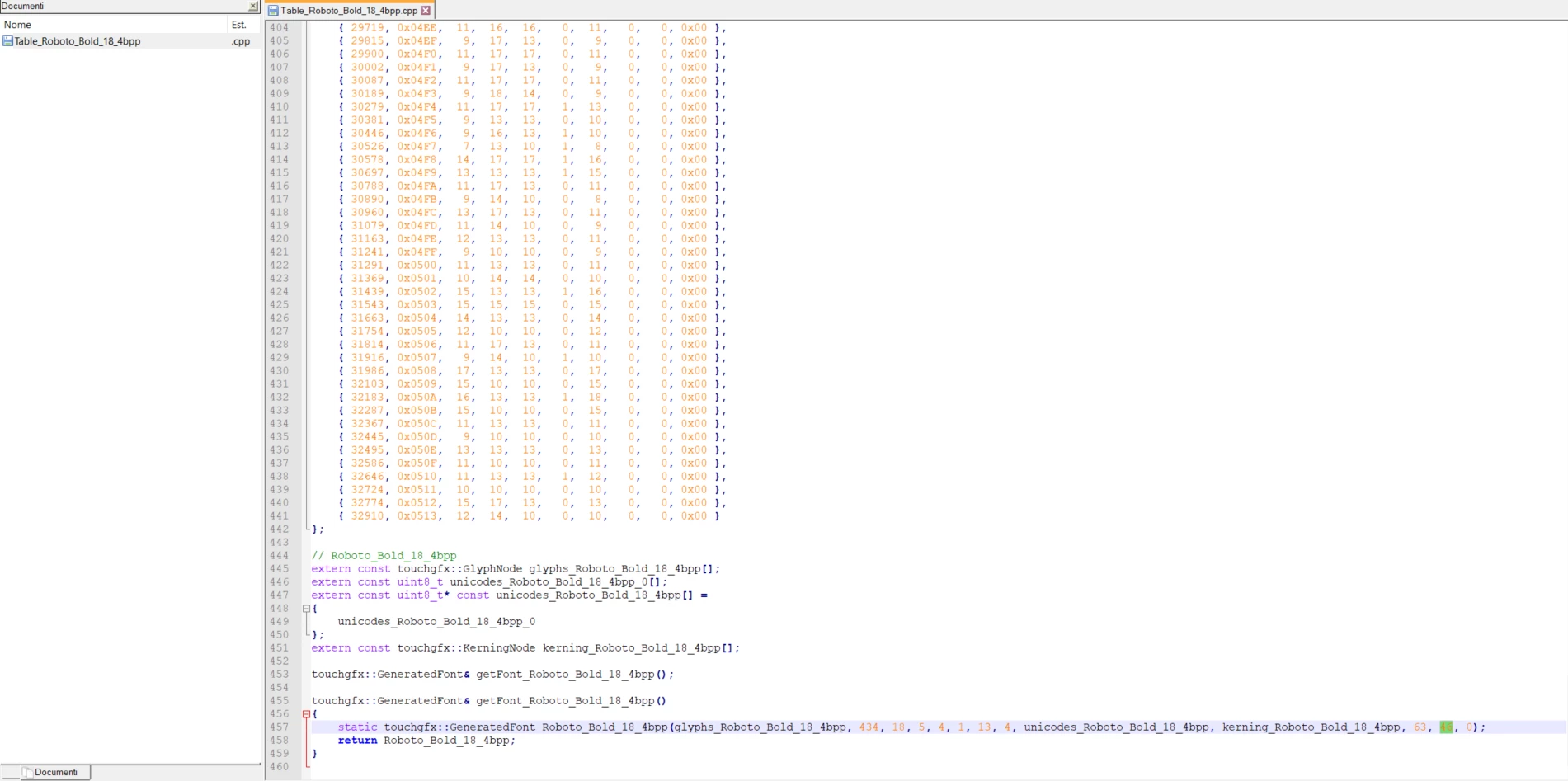

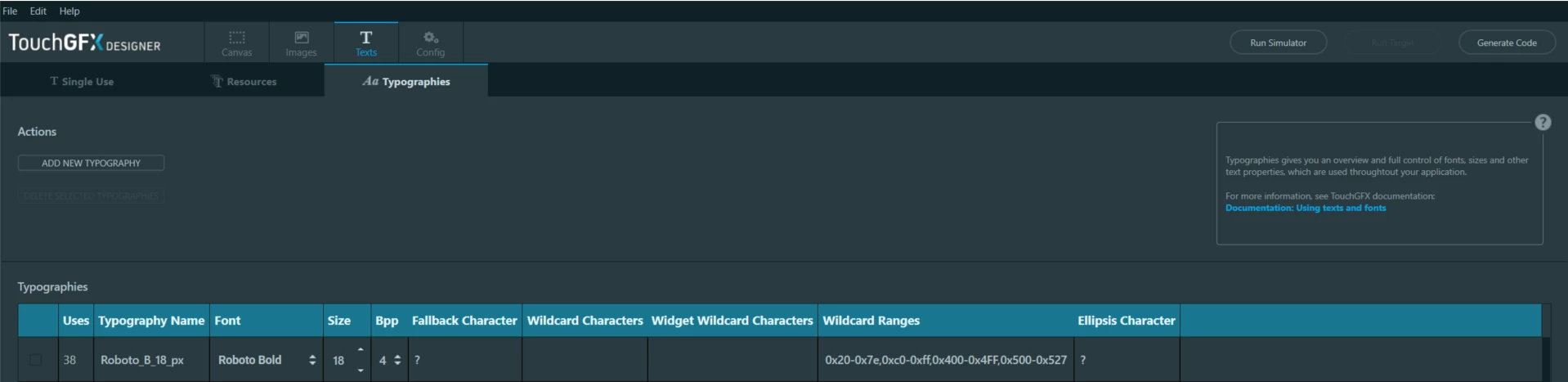

I changed the "Ellipsis Character" from '.' to '?' and generated the code (note that there is no "blue point" beside the "Generate Code" button)
In spite of that, the generated font is still inited with the '.' as the ellipsis character. As you can see in the screenshot below, the twelfth parameter of the
static touchgfx::GeneratedFont Roboto_Bold_18_4bpp
is still equal to 46 == 0x2E == '.'
