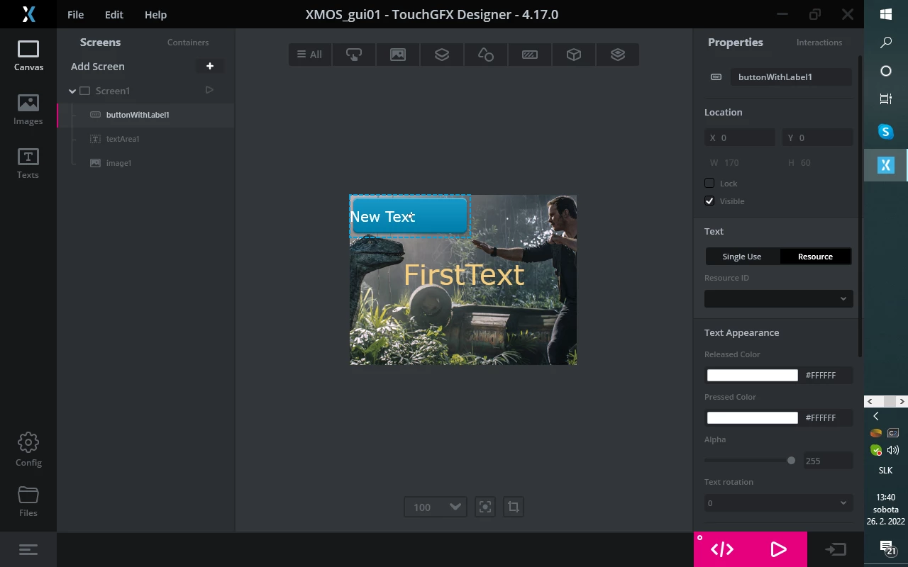

TouchGFX Designer's "Button with Label" does not appear to allow wild card strings for button label. However, "Flex Button" supports text with wildcard strings that also allows setting initial value from resources (as normal wildcard text box does).
Is there a way to have "Button with Label" to include widlcard strings with initial value from resources?
"Flex Button" allows text with proper wildcard string supported, but "Flex Button" does not allow text rotation as "Button with Label" does. It seems that "Flex Button" is designed to be very flexible for including text, icon and background for a button but it does not seem include all of the properties as just text only button has (i.e. "Button with Label").
Is there a way to get around this (text rotation with "Flex Button")?
One more, the "Button with Label" also doe not support setting initial state (pressed) as "Flex Button" does.
