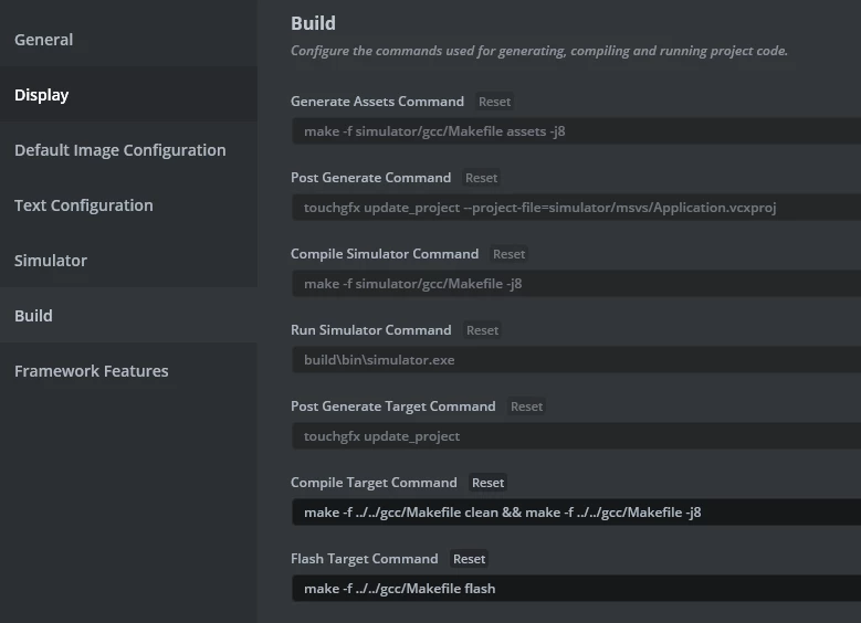

I just installed TouchGFX Designer 4.21.3 yesterday and now whenever I try to run simulator or run target I get these errors:
 gcc/makefile_cm7:403: recipe for target 'CM7/TouchGFX/build/STM32H745I_DISCO/CM7/TouchGFX/gui/src/main_screen/mainView.o' failed
 make[3]: *** [CM7/TouchGFX/build/STM32H745I_DISCO/CM7/TouchGFX/gui/src/main_screen/mainView.o] Error 1
 make[3]: Leaving directory 'c:/Users/o.sang/Documents/TouchGFX/MyApplication_3'
 gcc/makefile_cm7:368: recipe for target 'generate_assets' failed
 make[2]: *** [generate_assets] Error 2
 make[2]: Leaving directory 'c:/Users/o.sang/Documents/TouchGFX/MyApplication_3'
 makefile_cm7:49: recipe for target 'all' failed
 make[1]: *** [all] Error 2
 make[1]: Leaving directory 'C:/Users/o.sang/Documents/TouchGFX/MyApplication_3/gcc'
 ../../gcc/Makefile:10: recipe for target 'flash' failed
 make: *** [flash] Error 2
 Failed
 Failed
I check other posts in the ST community but there were no answers to solve my problem. I used STM32 Programmer and was able to connect with my STM32H745I-disco board, so ST-Link is working fine!
This is my configuration for the build:
_legacyfs_online_stmicro_images_0693W00000bilnzQAA.pngCould someone please help solve this problem?

I've tried on my side to run a project based on the  STM32H745I-disco board and it works fine both on the simulator and on target.
Your build configuration looks ok to me (doesn't seems that you changed from the default value did you?). Also, have you tried with an empty project?
/Osman

Hi @Osman SOYKURT​
I did not change anything in the build configuration. I do not dare to touch these, because I know something bad will happen.
I have tried with another new project and it works fine. Actually the problem still exists. I opened a demo example and try to run it on target and the same problem occurs. This error about recipe for target 'all' failed has happened multiple times since I started using TouchGFX. And I am sure that I will face this problem again in the future, therefore a solution to this problem will be highly appreciated! :pensive_face: Any advice?
