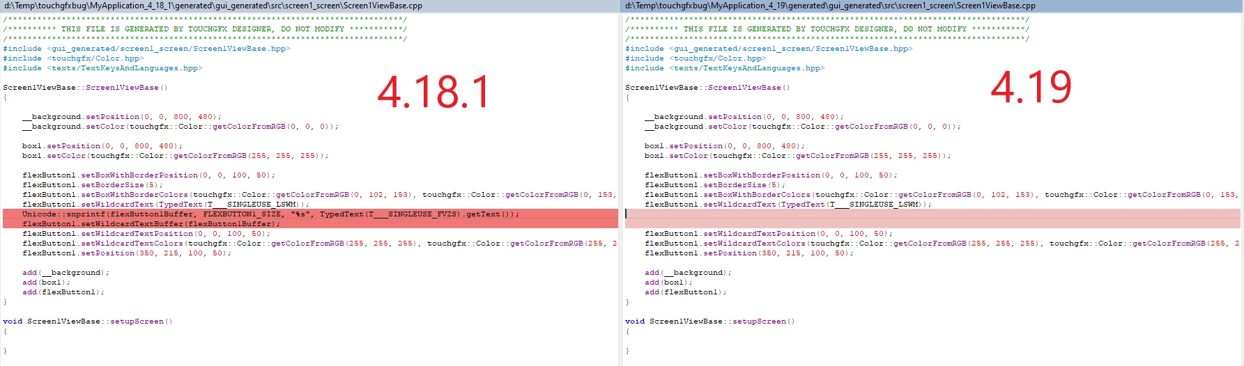

Hey @Martin KJELDSEN​ ,
today I updated touchgfx in my project from version 4.18.1 to 4.19. As soon as I updated, regenerated and compiled my project I noticed that all of my wildcard texts in flexbuttons are missing:
Example code:
#include <gui/screen1_screen/Screen1View.hpp>
Screen1View::Screen1View()
void Screen1View::setupScreen()
 Screen1ViewBase::setupScreen();
 Unicode::snprintf(flexButton1Buffer, FLEXBUTTON1_SIZE, "HELLO");
void Screen1View::tearDownScreen()
 Screen1ViewBase::tearDownScreen();
Result 4.18.1:
0693W00000KdgusQAB.pngResult 4.19:0693W00000Kdgv2QAB.png
I compared generated files (v4.19 vs. v4.18.1) and found out that new touchgfx designer does not generate line setWildcardTextBuffer (also line for sample value snprintf is missing):

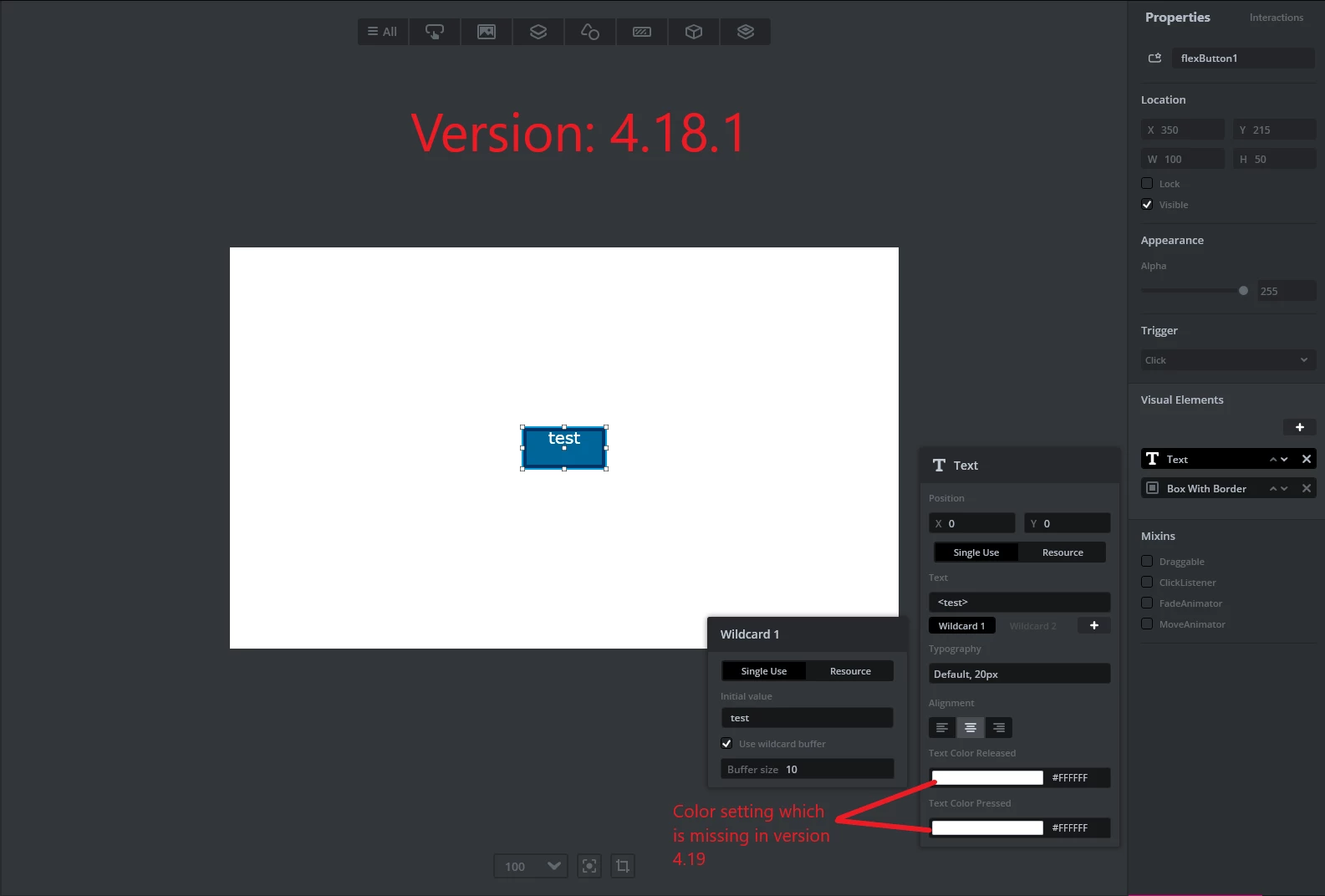

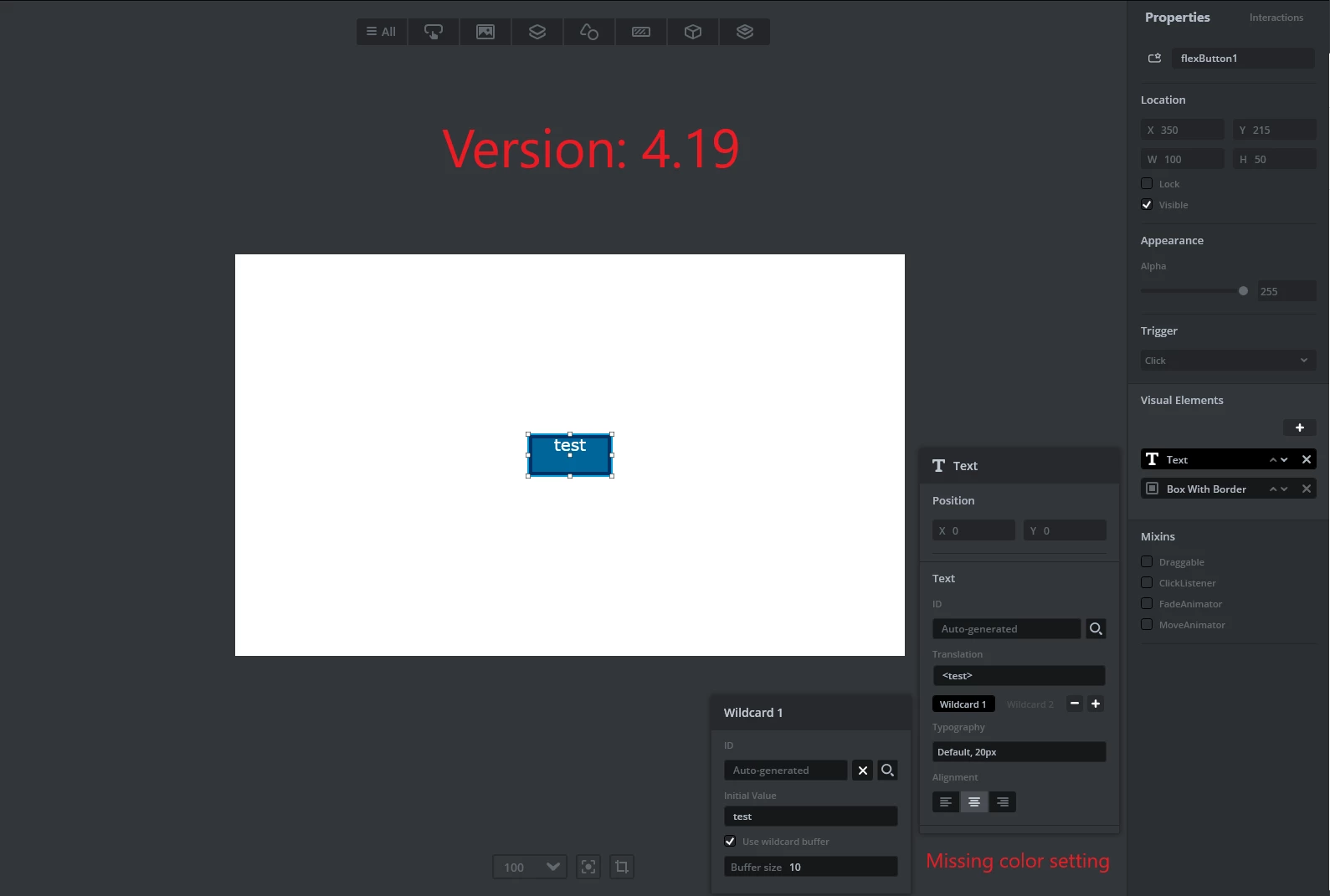

0693W00000KdgyBQAR.pngFurther more I noticed that color setting for flexButton text is gone in designer:
You can find application examples in zip attachment.
1 reply

Hi JureL,
Thank you very much for the thorough description. This is for sure a bug that we need to correct as soon as possible. Expect a patch release soon (within a week or so).
