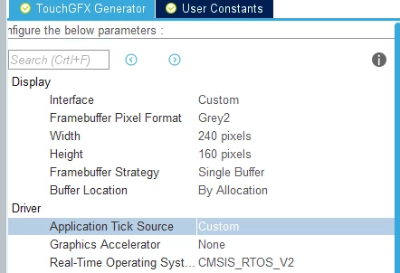

I want to run TouchGFX on STM32F413VGTX MCU. It Doesnt not have LTDC nor DMA2D so I want to make it run using FSMC without graphic accelerator with my ST7529 LCD controller. The problem is I can not make it run.
I created a project with ToucGFX and custom driver:

I'd like to ask you if TouchGFX_TickHandler routine is written well according to my settings which are: custom driver (fsmc- data is flushed into LCD when flush routine is called), custom tick source, no DMA, single framebuffer. TouchGFX_TickHandler is copied from some example and I do not really know if it is good.
And how often do I need to call TouchGFX_TickHandler? 60 Hz will be enough?
