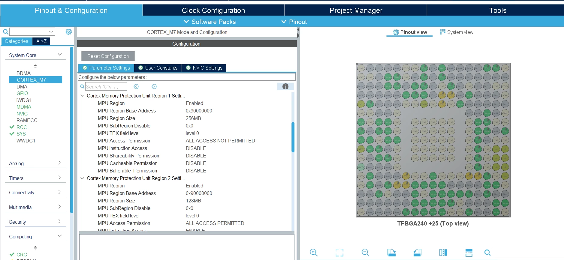

I’m new to STM32 TouchGFX and trying to create a custom TouchGFX application following How to integrate TouchGFX in a custom board (The long way round) - YouTube
After setting everything up, I encountered the following error during the build:
`.text' will not fit in region `FLASH' region `FLASH' overflowed by 296512 bytes
I understand that my MCU has only 128KB of Flash, which is insufficient for TouchGFX. I want to configure TouchGFX to use only SDRAM instead of Flash. How does TouchGFX utilize SDRAM, and how can I correctly set it up for this purpose?
Additionally, when comparing my custom application to the STM32H7 Dev Board example, I noticed different memory configurations in the Cortex-M7 section under System Core. Specifically, I don’t fully understand how QSPI Flash is mapped as two memory regions starting from 0x90000000.
I've attached a screenshot for reference. Kindly guide me on resolving the FLASH overflow issue and understanding the QSPI memory setup.
Thanks in advance!

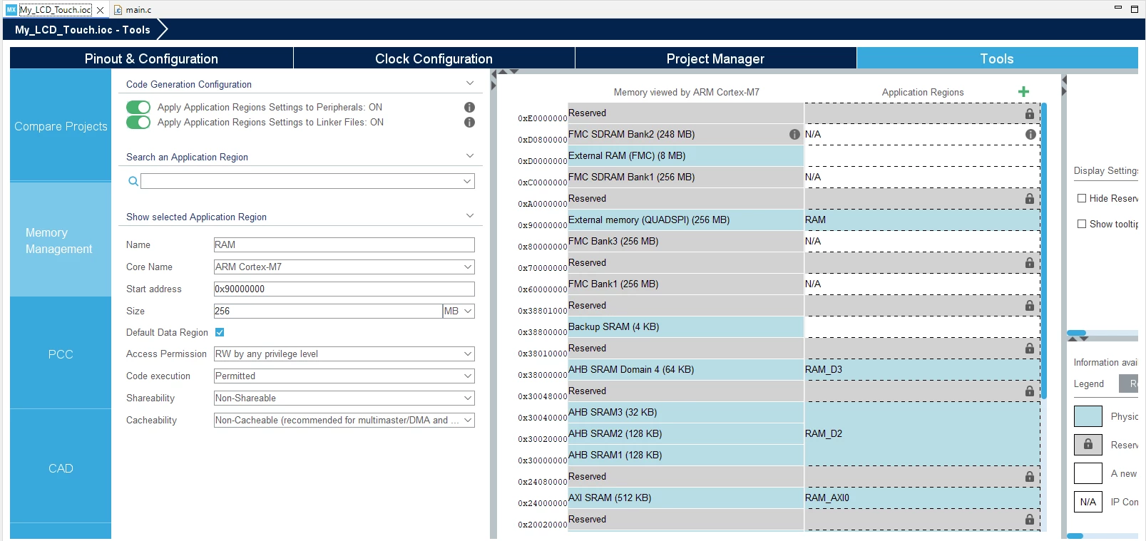

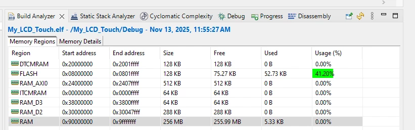

Nov 13, 2025 1:51 PM UTC
Hello !
This looks like a promising solution, I am also on this STM32H750b - DK , however, I am using a custom display via the LTDC /1024x600, 24bit and Touch GFX  ...
The memory is enabled, namely "External memory" QUADSPI 256MB, I can see this memory starting at the 0x90000000 in the Cube IDE, namely 'Build analyzer' and its 'Memory Regions'
So far so good, however, when compiling, I am getting the following error when the Touch GFX is enabled :
14:13:25 **** Incremental Build of configuration Debug for project My_LCD_Touch ****
make -j4 all
arm-none-eabi-g++ -o "My_LCD_Touch.elf" @"objects.list" -l:libtouchgfx-float-abi-hard.a -mcpu=cortex-m7 -T"C:\Users\Administrator\STM32CubeIDE\LCD_SCT\My_LCD_Touch\STM32H750XBHX_FLASH_MMT_TEMPLATE.ld" --specs=nosys.specs -Wl,-Map="My_LCD_Touch.map" -Wl,--gc-sections -static -L"C:\Users\Administrator\STM32CubeIDE\LCD_SCT\My_LCD_Touch\Middlewares\ST\touchgfx\lib\core\cortex_m7\gcc" --specs=nano.specs -mfpu=fpv5-d16 -mfloat-abi=hard -mthumb -Wl,--start-group -lc -lm -lstdc++ -lsupc++ -Wl,--end-group
C:/ST/STM32CubeIDE_1.13.2/STM32CubeIDE/plugins/com.st.stm32cube.ide.mcu.externaltools.gnu-tools-for-stm32.13.3.rel1.win32_1.0.0.202411081344/tools/bin/../lib/gcc/arm-none-eabi/13.3.1/../../../../arm-none-eabi/bin/ld.exe: My_LCD_Touch.elf section `.text' will not fit in region `FLASH'
C:/ST/STM32CubeIDE_1.13.2/STM32CubeIDE/plugins/com.st.stm32cube.ide.mcu.externaltools.gnu-tools-for-stm32.13.3.rel1.win32_1.0.0.202411081344/tools/bin/../lib/gcc/arm-none-eabi/13.3.1/../../../../arm-none-eabi/bin/ld.exe: region `FLASH' overflowed by 192116 bytes
collect2.exe: error: ld returned 1 exit status
make: *** [makefile:106: My_LCD_Touch.elf] Error 1
"make -j4 all" terminated with exit code 2. Build might be incomplete.
14:13:27 Build Failed. 3 errors, 0 warnings. (took 2s.121ms)
I am very optimistic about it; I got down from 9 to 3 errors :) learning curve!
As far as I have understood the 'Memory Management Tool' this is my 'Default Data Region'? My memory setup so far:
So, this is what I know so far about how to go around this... indeed, the Linker has not been addressed, I guess the Linker does not know about the available memory, wondering, if that is an issue or is something else?
Any comments, ideas, solutions how to get around this problem are more than welcome and of course appreciated!
Best.
