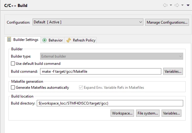

I've also been trying to setup a working CubeIDE configuration for the STM32F469-DISCO board and encountered similar problems. Being a novice in this area I was making little to no progress so decided to try the suggestion in this tread. I appreciate this is probably any easy task for most but I'm still struggling to get a working build, let me explain what I have done:
1) Used the STM32F469-DISCO application target from the TouchGfx designer.
2) Created an empty project in CubeIDE from (makefile project from existing code) that points to the projected created in step 1.
3) Selected 'Build project' but get the following errors
'wc' is not recognized as an internal or external command,
operable program or batch file.
Converting images
Compiling gui/src/screen1_screen/Screen1Presenter.cpp
The syntax of the command is incorrect.
target/gcc/Makefile:333: recipe for target 'build/ST/STM32469IDISCO/gui/src/screen1_screen/Screen1Presenter.o' failed
make[2]: *** [build/ST/STM32469IDISCO/gui/src/screen1_screen/Screen1Presenter.o] Error 1
target/gcc/Makefile:300: recipe for target 'generate_assets' failed
make[1]: *** [generate_assets] Error 2
target/gcc/Makefile:42: recipe for target 'all' failed
make: *** [all] Error 2
This is the build settings for the project
Have I missed a step?
Also will I be able to use the debug option to step through the code when deployed on the target?
Thanks
Robin
ScubaBoy
June 18, 2019
OK Resolved make errors just need to update the version of make used by CubeIDE but not sure how to setup debug settings?

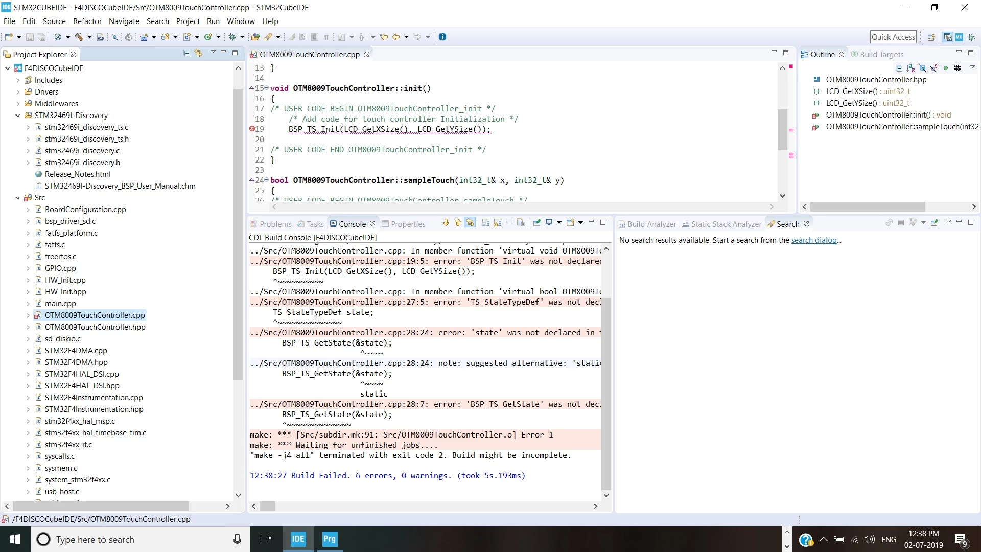

senthil
July 2, 2019
When Compile STMF4DISCOCubeIDE in github
i got the Error
How can i solve that ?
20:11:45 **** Incremental Build of configuration Debug for project F4DISCOCubeIDE ****
make -j4 all
arm-none-eabi-g++ "../Src/OTM8009TouchController.cpp" -mcpu=cortex-m4 -std=gnu++14 -g3 -DUSE_HAL_DRIVER -DSTM32F469xx -DDEBUG -c -I../TouchGFX/gui/include -I../TouchGFX/generated/fonts/include -I../Drivers/BSP/Components/ts3510 -I../TouchGFX/generated/texts/include -I../Drivers/CMSIS/Device/ST/STM32F4xx/Include -I../TouchGFX/generated/images/include -I../Middlewares/ST/STM32_USB_Host_Library/Class/CDC/Inc -I../Middlewares/Third_Party/FreeRTOS/Source/portable/GCC/ARM_CM4F -I../Middlewares/ST/TouchGFX/touchgfx/framework/include -I../TouchGFX/generated/gui_generated/include -I../Middlewares/Third_Party/FreeRTOS/Source/CMSIS_RTOS -I../Middlewares/Third_Party/FreeRTOS/Source/include -I../Drivers/BSP/Components/exc7200 -I../Drivers/BSP/Components/stmpe811 -I../Drivers/STM32F4xx_HAL_Driver/Inc -I../Src -I../Drivers/STM32F4xx_HAL_Driver/Inc/Legacy -I../Middlewares/ST/STM32_USB_Host_Library/Core/Inc -I../Inc -I../Drivers/CMSIS/Include -I../Drivers/BSP/Components/otm8009a -I../Drivers/BSP/Components/Common -I../Middlewares/Third_Party/FatFs/src -I../Drivers/BSP/Components/ampire480272 -I"D:/Work/STM32CUBEIDE/SMT32F7LCDDisco-master/STMF4DISCOCubeIDE/STM32469I-Discovery" -I"D:/Work/STM32CUBEIDE/SMT32F7LCDDisco-master/STMF4DISCOCubeIDE/Drivers/BSP/Components/ft6x06" -O0 -ffunction-sections -fdata-sections -fno-exceptions -fno-rtti -fno-threadsafe-statics -fno-use-cxa-atexit -Wall -fstack-usage -MMD -MP -MF"Src/OTM8009TouchController.d" -MT"Src/OTM8009TouchController.o" --specs=nano.specs -mfpu=fpv4-sp-d16 -mfloat-abi=hard -mthumb -o "Src/OTM8009TouchController.o"
arm-none-eabi-g++ "../Src/STM32F4DMA.cpp" -mcpu=cortex-m4 -std=gnu++14 -g3 -DUSE_HAL_DRIVER -DSTM32F469xx -DDEBUG -c -I../TouchGFX/gui/include -I../TouchGFX/generated/fonts/include -I../Drivers/BSP/Components/ts3510 -I../TouchGFX/generated/texts/include -I../Drivers/CMSIS/Device/ST/STM32F4xx/Include -I../TouchGFX/generated/images/include -I../Middlewares/ST/STM32_USB_Host_Library/Class/CDC/Inc -I../Middlewares/Third_Party/FreeRTOS/Source/portable/GCC/ARM_CM4F -I../Middlewares/ST/TouchGFX/touchgfx/framework/include -I../TouchGFX/generated/gui_generated/include -I../Middlewares/Third_Party/FreeRTOS/Source/CMSIS_RTOS -I../Middlewares/Third_Party/FreeRTOS/Source/include -I../Drivers/BSP/Components/exc7200 -I../Drivers/BSP/Components/stmpe811 -I../Drivers/STM32F4xx_HAL_Driver/Inc -I../Src -I../Drivers/STM32F4xx_HAL_Driver/Inc/Legacy -I../Middlewares/ST/STM32_USB_Host_Library/Core/Inc -I../Inc -I../Drivers/CMSIS/Include -I../Drivers/BSP/Components/otm8009a -I../Drivers/BSP/Components/Common -I../Middlewares/Third_Party/FatFs/src -I../Drivers/BSP/Components/ampire480272 -I"D:/Work/STM32CUBEIDE/SMT32F7LCDDisco-master/STMF4DISCOCubeIDE/STM32469I-Discovery" -I"D:/Work/STM32CUBEIDE/SMT32F7LCDDisco-master/STMF4DISCOCubeIDE/Drivers/BSP/Components/ft6x06" -O0 -ffunction-sections -fdata-sections -fno-exceptions -fno-rtti -fno-threadsafe-statics -fno-use-cxa-atexit -Wall -fstack-usage -MMD -MP -MF"Src/STM32F4DMA.d" -MT"Src/STM32F4DMA.o" --specs=nano.specs -mfpu=fpv4-sp-d16 -mfloat-abi=hard -mthumb -o "Src/STM32F4DMA.o"
arm-none-eabi-g++ "../Src/STM32F4HAL_DSI.cpp" -mcpu=cortex-m4 -std=gnu++14 -g3 -DUSE_HAL_DRIVER -DSTM32F469xx -DDEBUG -c -I../TouchGFX/gui/include -I../TouchGFX/generated/fonts/include -I../Drivers/BSP/Components/ts3510 -I../TouchGFX/generated/texts/include -I../Drivers/CMSIS/Device/ST/STM32F4xx/Include -I../TouchGFX/generated/images/include -I../Middlewares/ST/STM32_USB_Host_Library/Class/CDC/Inc -I../Middlewares/Third_Party/FreeRTOS/Source/portable/GCC/ARM_CM4F -I../Middlewares/ST/TouchGFX/touchgfx/framework/include -I../TouchGFX/generated/gui_generated/include -I../Middlewares/Third_Party/FreeRTOS/Source/CMSIS_RTOS -I../Middlewares/Third_Party/FreeRTOS/Source/include -I../Drivers/BSP/Components/exc7200 -I../Drivers/BSP/Components/stmpe811 -I../Drivers/STM32F4xx_HAL_Driver/Inc -I../Src -I../Drivers/STM32F4xx_HAL_Driver/Inc/Legacy -I../Middlewares/ST/STM32_USB_Host_Library/Core/Inc -I../Inc -I../Drivers/CMSIS/Include -I../Drivers/BSP/Components/otm8009a -I../Drivers/BSP/Components/Common -I../Middlewares/Third_Party/FatFs/src -I../Drivers/BSP/Components/ampire480272 -I"D:/Work/STM32CUBEIDE/SMT32F7LCDDisco-master/STMF4DISCOCubeIDE/STM32469I-Discovery" -I"D:/Work/STM32CUBEIDE/SMT32F7LCDDisco-master/STMF4DISCOCubeIDE/Drivers/BSP/Components/ft6x06" -O0 -ffunction-sections -fdata-sections -fno-exceptions -fno-rtti -fno-threadsafe-statics -fno-use-cxa-atexit -Wall -fstack-usage -MMD -MP -MF"Src/STM32F4HAL_DSI.d" -MT"Src/STM32F4HAL_DSI.o" --specs=nano.specs -mfpu=fpv4-sp-d16 -mfloat-abi=hard -mthumb -o "Src/STM32F4HAL_DSI.o"
arm-none-eabi-g++ "../Src/STM32F4Instrumentation.cpp" -mcpu=cortex-m4 -std=gnu++14 -g3 -DUSE_HAL_DRIVER -DSTM32F469xx -DDEBUG -c -I../TouchGFX/gui/include -I../TouchGFX/generated/fonts/include -I../Drivers/BSP/Components/ts3510 -I../TouchGFX/generated/texts/include -I../Drivers/CMSIS/Device/ST/STM32F4xx/Include -I../TouchGFX/generated/images/include -I../Middlewares/ST/STM32_USB_Host_Library/Class/CDC/Inc -I../Middlewares/Third_Party/FreeRTOS/Source/portable/GCC/ARM_CM4F -I../Middlewares/ST/TouchGFX/touchgfx/framework/include -I../TouchGFX/generated/gui_generated/include -I../Middlewares/Third_Party/FreeRTOS/Source/CMSIS_RTOS -I../Middlewares/Third_Party/FreeRTOS/Source/include -I../Drivers/BSP/Components/exc7200 -I../Drivers/BSP/Components/stmpe811 -I../Drivers/STM32F4xx_HAL_Driver/Inc -I../Src -I../Drivers/STM32F4xx_HAL_Driver/Inc/Legacy -I../Middlewares/ST/STM32_USB_Host_Library/Core/Inc -I../Inc -I../Drivers/CMSIS/Include -I../Drivers/BSP/Components/otm8009a -I../Drivers/BSP/Components/Common -I../Middlewares/Third_Party/FatFs/src -I../Drivers/BSP/Components/ampire480272 -I"D:/Work/STM32CUBEIDE/SMT32F7LCDDisco-master/STMF4DISCOCubeIDE/STM32469I-Discovery" -I"D:/Work/STM32CUBEIDE/SMT32F7LCDDisco-master/STMF4DISCOCubeIDE/Drivers/BSP/Components/ft6x06" -O0 -ffunction-sections -fdata-sections -fno-exceptions -fno-rtti -fno-threadsafe-statics -fno-use-cxa-atexit -Wall -fstack-usage -MMD -MP -MF"Src/STM32F4Instrumentation.d" -MT"Src/STM32F4Instrumentation.o" --specs=nano.specs -mfpu=fpv4-sp-d16 -mfloat-abi=hard -mthumb -o "Src/STM32F4Instrumentation.o"
../Src/OTM8009TouchController.cpp: In member function 'virtual void OTM8009TouchController::init()':
../Src/OTM8009TouchController.cpp:19:5: error: 'BSP_TS_Init' was not declared in this scope
   BSP_TS_Init(LCD_GetXSize(), LCD_GetYSize());
../Src/OTM8009TouchController.cpp: In member function 'virtual bool OTM8009TouchController::sampleTouch(int32_t&, int32_t&)':
../Src/OTM8009TouchController.cpp:27:5: error: 'TS_StateTypeDef' was not declared in this scope
   TS_StateTypeDef state;
../Src/OTM8009TouchController.cpp:28:24: error: 'state' was not declared in this scope
    BSP_TS_GetState(&state);
../Src/OTM8009TouchController.cpp:28:24: note: suggested alternative: 'static'
            static
../Src/OTM8009TouchController.cpp:28:7: error: 'BSP_TS_GetState' was not declared in this scope
make: *** [Src/subdir.mk:91: Src/OTM8009TouchController.o] Error 1
make: *** Waiting for unfinished jobs....
"make -j4 all" terminated with exit code 2. Build might be incomplete.
20:12:01 Build Failed. 6 errors, 0 warnings. (took 15s.552ms)
Martin KJELDSEN
Principal III
July 2, 2019
You have to include touch related .c files in your project for compilation. _discovery.c, _ts.c, i believe, from the cube firmware pack.
/Martin
senthil
July 3, 2019
Already Included
Here i enclosed the Image
