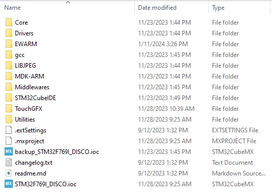

  • An exemple of a project folder structure :
An exemple of a project/TouchGFX folder structure : TouchGFX Designer Project | TouchGFX Documentation

Thank you Louis. For the example you provided does that cover a dual core stm32? I've found that I have to start with cubemx to generate the project including getting touchgfx in before generating the project code otherwise the directory structure is wrong and touchide fails to generate code because it can't find the .cproject which is located within the directory for the specific core running touchgfx. My working directory structure does not look like yours as I have a CM4 and CM7 directory in the project root seemingly to placate Touchgfx(?). I'm still not clear if what has been generates is actually correct for long term stability of the project.

With dual core you have two folders for each cores (CM4 and CM7). It's the same as for single core, except that the TouchGfx related folders will be placed on the context (core) you set in CubeMX.
