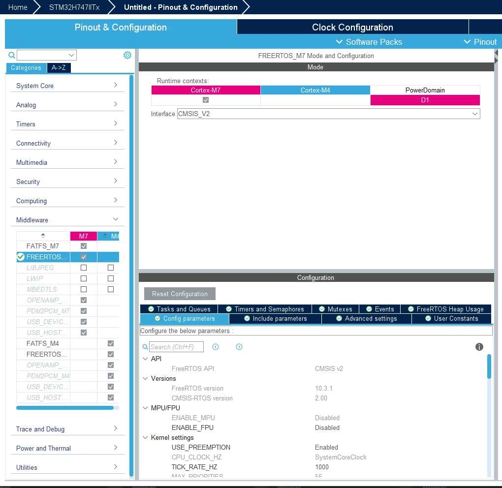

The steps looks fine to me. The file you need to modify is OSWrappers.cpp. This one contains the definition of all functions that works with the OS. So you need to remove FreeRTOS functions and use your function to make them work with ChibiOS. You can get help from this document which explains which function do what.
/Osman
Martin KJELDSEN
Principal III
May 23, 2022 1:17 PM UTC
The TouchGFX Generator in CubeMX supports CMSIS V1 and V2 interfaces. Looking at github it looks as if chibiOS is cmsis OS compliant:
ChibiOS/cmsis_os.c at master · ChibiOS/ChibiOS (github.com)
This means you can use the OSWrapper.cpp you get from us (By choosing CMSIS OS V1/2 in the TouchGFX generator interface).
Since CubeMX cannot help you with ChibiOS, you just have to add the files to your project manually, and also start a new task for TouchGFX to run in. You can get some inspiration by looking at how we do it for FreeeRTOS (Check one of the board packages from the designer).

Thanks for the help! Do you recommend using ChibiOS in the CubeMX IDE or should I do all my work in CubeMX and then copy all of the file to the ChibiOS dev environment and then build from there?
If moving ChibiOS into the CubeMX dev environment is the way to go, is there a guide on how to do that?
Thanks!
Daniel
DOkaz.1
DOkaz.1Author
Jun 5, 2022 1:21 AM UTC
@Martin KJELDSEN​ @Osman SOYKURT​ Just to confirm, I need to choose FREERTOS in the code generator (as well as configuring everything needed), enabling CMVIS_V1/CMIS_V2 (Probably will go with V2 since it seems cross-compatible and if I go multi core it'll be required) and then manually moving the needed generated files into ChibiOS (removing the FreeRtos specific stuff) and starting a new TouchGFX task for it?
Once I have the CubeMX configuration, i can generate TouchGFX applications using that config and also add it to the ChibiOS.
Is there any steps that I'm missing?
Thanks!
Osman SOYKURT
Jun 7, 2022 7:48 AM UTC
Hello DOkaz.1,
Yes it seems to fine with this steps. @Martin KJELDSEN​ can you confirm ?
/Osman
