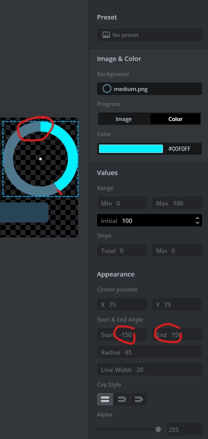

Why it is not possible to make a circle progress much like a car dashboard would have. Zero is at about 7 o'clock and full is at 4 o'clock.
The circle progress always starts at 12:00. No mater what parameters I enter.
Is there another method of achieving similar effect?

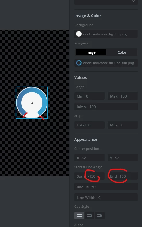

    Just downloaded v4.18. Although the design there is a little different(even more options???) this one seems to be working. Adjusting the "Start" angle actually changes the start position. So it seems that 4.22 has a bug.
    Oh why always after having so much work to get it to work you discover some bug that makes it unusable :face_with_tears_of_joy:
    See comparsion images attached.

    Ok did some more tests with 4.21.4. This one also has the same bug. Am I missing something? How have people used this widget in past? Could it be corrected in STMCube?
