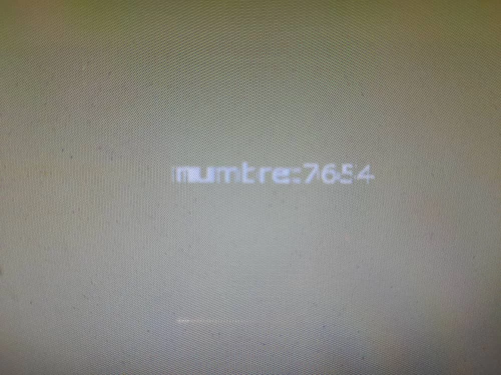

TouchGFX_characters in the text area is not readable

0693W00000HoeKTQAZ.jpgHi
I use touch gfx wildcard to show characters and variables in the text area but the characters are shown like the attached photo... I configured the MPU as follows but still does not work.
I would appreciate any help. I will upload the LCD photo and MPU codes.
PS:I use stm32f767ig

MM..1
December 15, 2021
Isnt MPU issue. Seems as fail in LCD driver (you dont define how method) or QSPI write / read

textflashsection and fontflashsection are in IRoM not QSPI.

would you plz explain it a little more? I don't get your point.
I use LTDC to drive my LCD.

LTDC then i will think as RGB 16 and normal RGB 666 for example display. Your PCB or wire lines between MCU and LCD is OK?
Your image show that an electric problem exist and not sw. Try change dot clock...

The wire lines between MCU and LCD seems alright.could it be because of lcd source power filtering ? I doubt that cause I did nt use cap.... در تاریخ چهارشنبه ۱۵ دسامبر ۲۰۲۱،�? ۱۷:۱۶ ST Community نوشت:
