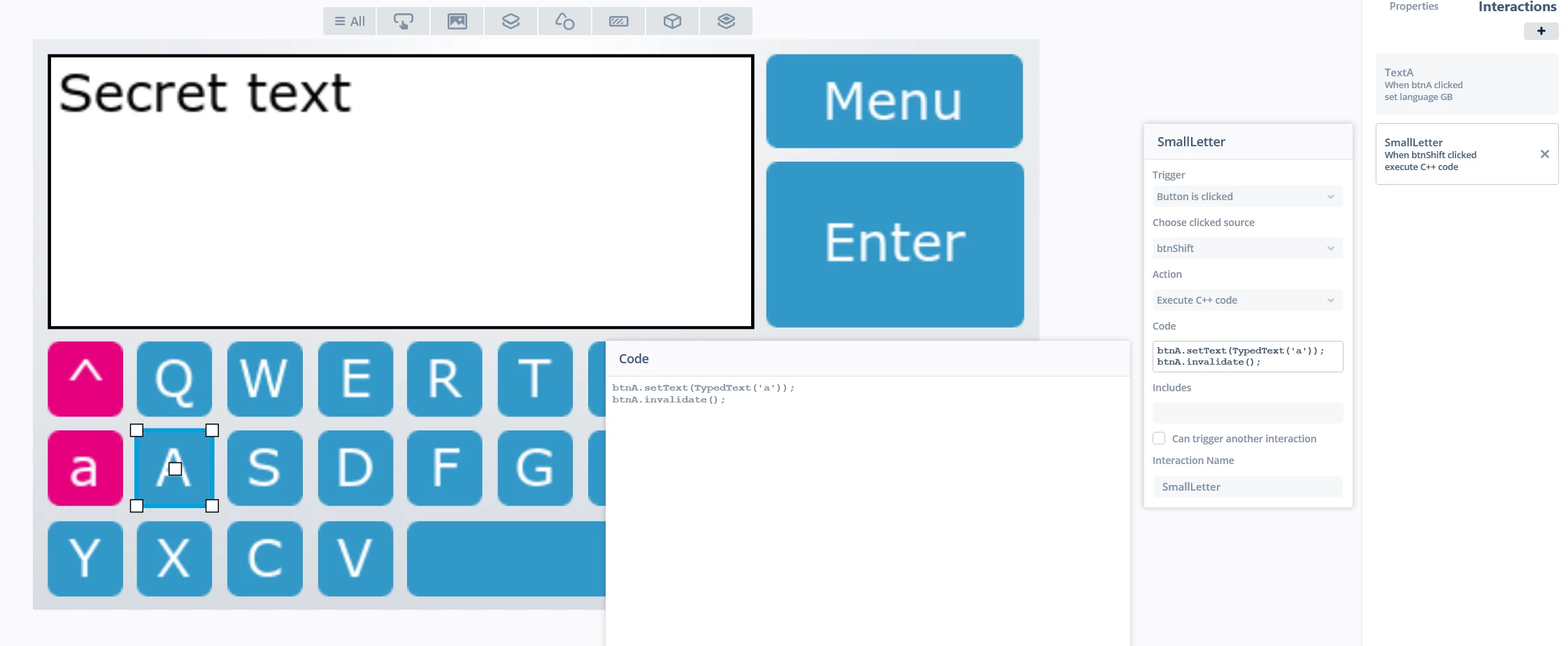

Hello, I try to do my own keyboard.
My idea: when click on shift button (red a, btnShift) i want replace big letters with small. All buttons are FlexButton
Can I use the Action Execute C++ code ?
like this:
btnA.setText(TypedText('a'));
but not woking now :(

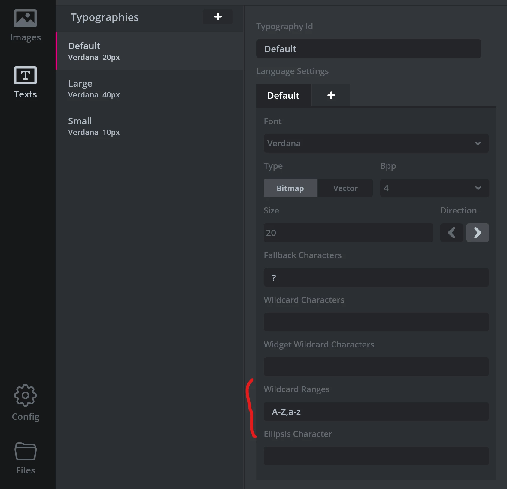

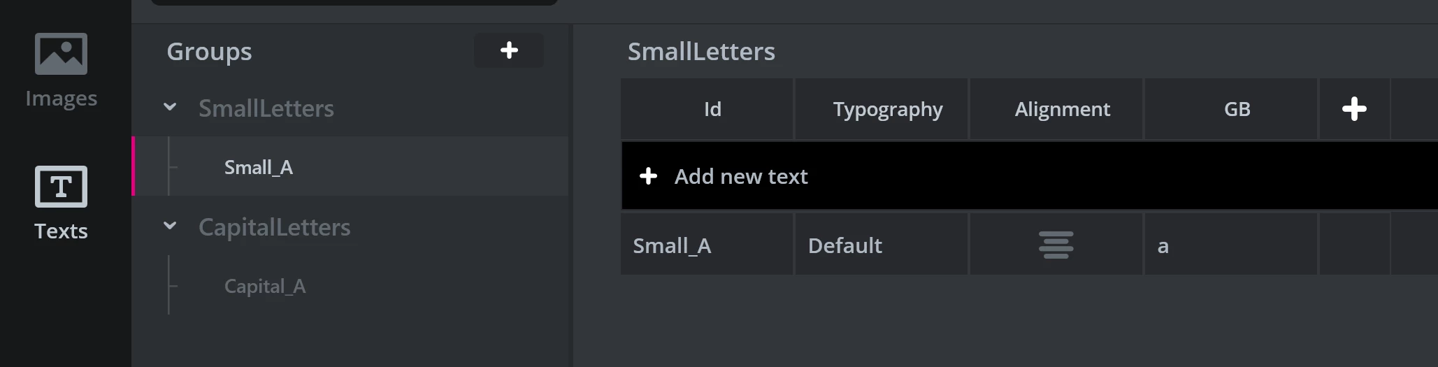

As our friend @Nathan_Xi mentioned, the easiest way would be to define all the texts that you want to use in your GUI inside the TouchGFX Designer -> Texts. And also set the characters you want to use inside the wildcard range.
Afterward, in your code you need to include texts/TextKeysAndLanguages.hpp, then you can use the function you mentioned to change the label of the flex button. Keep in mind that you need to provide the ID that you assigned to your text inside TypedText().
It would look something like this:
Setting Wildcard rangesSetting Wildcard ranges
Text definition inside TouchGFXText definition inside TouchGFX
//Inside your ScreenView.cpp
#include <texts/TextKeysAndLanguages.hpp>
//An interaction set inside the designer for a button click
void ScreenView::changeLetterToSmall()
 btnA.setText(TypedText(T_SMALL_A));
 btnA.invalidateContent();
I hope this helps you, don't hesitate to ask more questions
