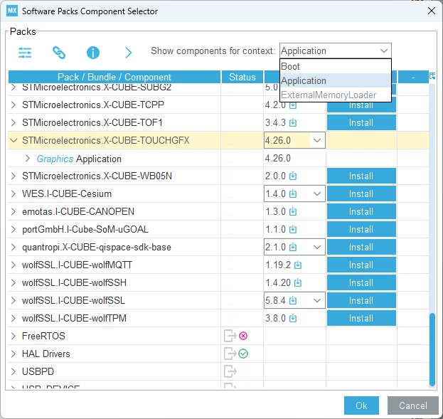

TouchGFX can only be placed in "boot" sub-project; not in "app"
In this IOC, touchgfx can only be placed in the "boot" sub-project. It cannot be placed in the "app" sub-project.

Hello @magicmatrix.
I apologize for the very late reply. I hope you were able to make it work.
For reference, if others encounter the same issue, I assume the problem is that Boot is selected instead of Application in the context menu when adding X-CUBE-TOUCHGFX. Select Application in the context menu to resolve the issue.
Best regards,
Johan
