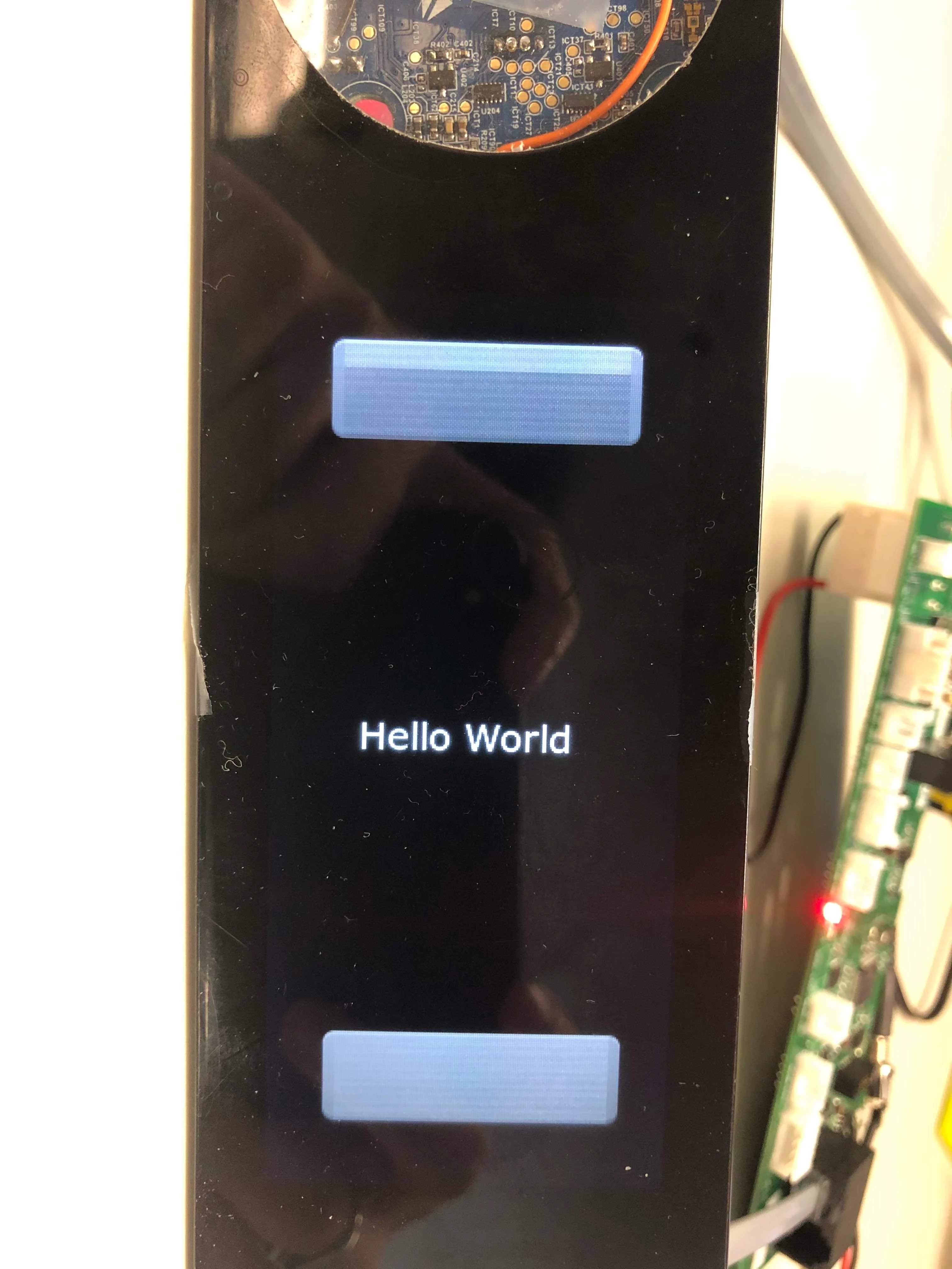

Kpodu.1
Kpodu.1Author
February 27, 2020
Hi Martin,
From that point I modified my code a bit.
Previous code is the part of code in BoardConfiguration.cpp I made a basic touchGFX application with two buttons which alter the text forth and back. Look at the attached image
We are not using the dynamic bitmaps cacheing. We have enough SD ram to copy all the assets during Reboot at once. My plan is to copy the assets from External Flash and put them in RAM and change the TouchGFX config to take assets from that Location of RAM and render. Please correct me if my though tprocess is wrong.
As of now the assets are just 81 KB but before Implementing the logic in our master code I decided to create a new STM cube project and try this out.
So the attached image is if I let the ExtFlashSection to sit in flash(normal configuration). Everything works perfectly without any problem.
