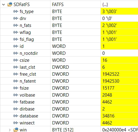

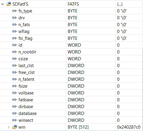

JSext.1
May 11, 2023 3:27 PM UTC
Thanks for the tip. I gave it a try, even around the  MX_SDMMC1_SD_Init();
 MX_FATFS_Init() commands. Had no effect unfortunately. This is what I obtain through debug (all zero's (top)) and what I expect is at the bottom...
JSext.1
May 12, 2023 9:44 PM UTC
Just wanted to share with you a quick update. Disabling and re-enabling D-Cache did actaully resolve the issue, so like to thank you again. I only realised by accident that there was also a secondary factor in parallel which was resulting in the same error. This was SDIOCLK divide factor which only became apparent when I tried another (but unknowingly faster SD card) since the program worked as is. Only by changing the SDIOCLK divide factor to 4 (from 0) did the original SD card work. At least its resolved the problem and very stable now. Thanks
