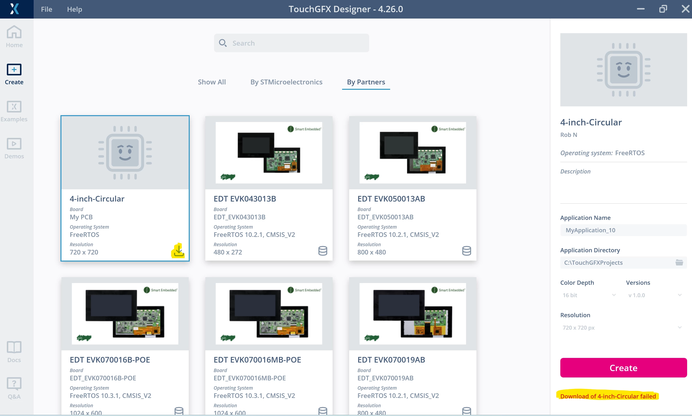

Perhaps someone can help me with regard to creating a TBS please.
I created a TBS following the instructions here https://support.touchgfx.com/docs/development/scenarios/scenarios-create-at
I'm using TouchGFX V 4.26.0 so I altered the instructions given for V.4.25.0 accordingly.
Apart from some confusion over the naming of the JSON file which always reverts to 'MyApplication' following the pack command, the TBS that I created worked.
I then went on to create a second TBS for a different set up. However this one didn't work, and the first TBS that I had created stopped working. (I must add at this stage that I don't recall changing anything that related to the first TBS when I created the second but I honestly can't be sure).

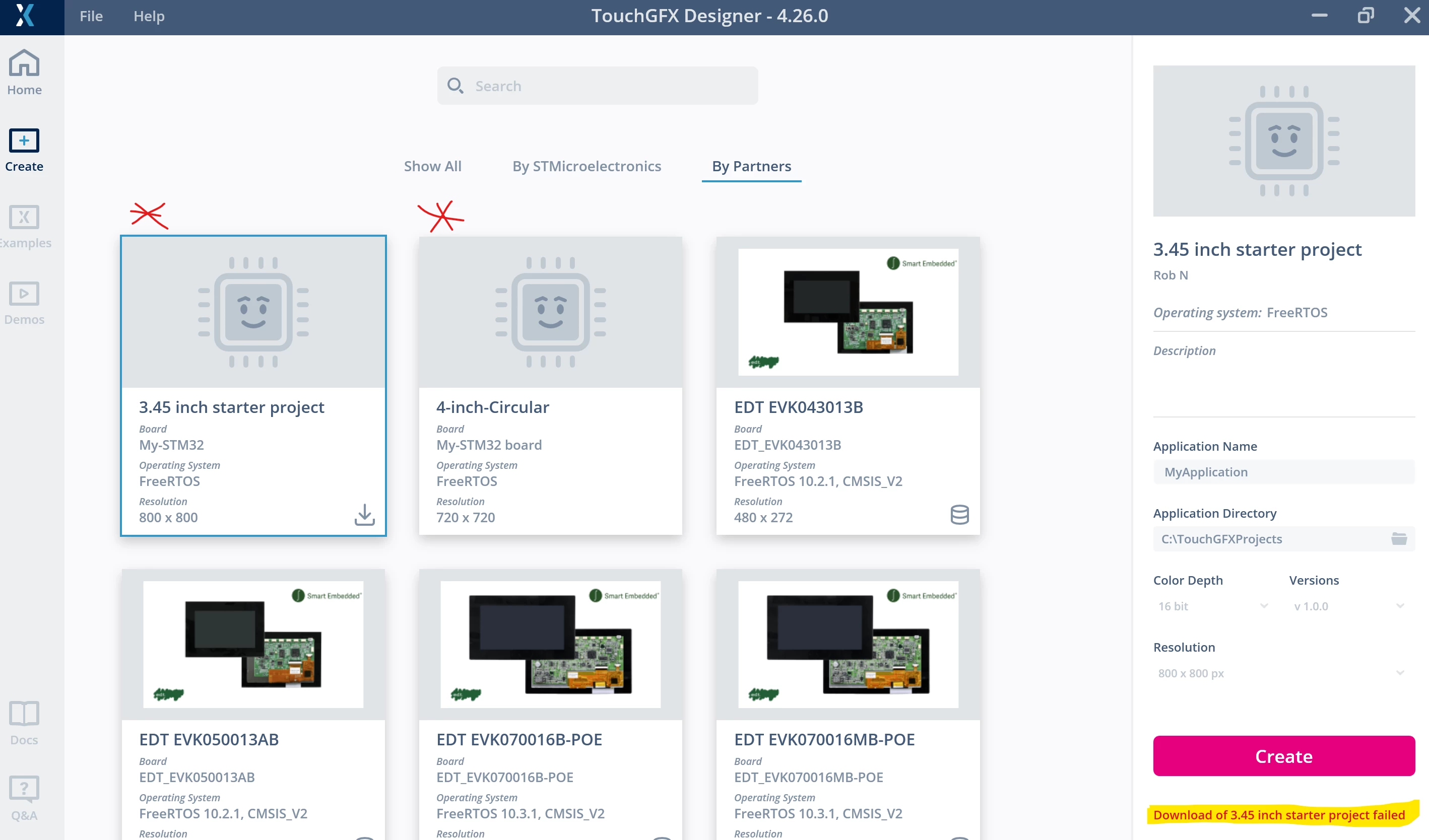

The error I get is 'Download of 'MyAppicationName' failed, this is shown highlighted in the screenshot below at the bottom right. My two TBS's are highlighted with red star. The first TBS I created is named '4-inch-Circular', and the second 3.45 inch starter project.
I think when I created and tested the first TBS, the download icon (down arrow in the bottom right of the TBS icon in the snip) showed as 'available offline', but I can't be sure of this.
.... So that raises the question, where is the TBS expected to be downloaded from as surely its' stored locally in the .tpa file that I created and placed in location C:\TouchGFX\4.26.0\app\packages ?

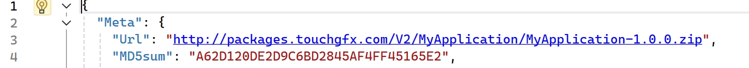

There may be a clue to this in the JSON file which starts out with the following:
"Meta": {
"Url": "http://packages.touchgfx.com/V2/Circular/Circular-1.0.0.zip",
Where is that URL and why is it being referenced at all? there is no information about this in the documentation.

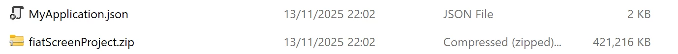

An update on this issue. I re-created my first project TBS which now works.
The second project also works but it generates a JSON file that is literally named 'MyApplication'. It also correctly generates a .zip file that has the correct project name, this file is very large (41,216 KB, I did clean the project as described in the documentation)

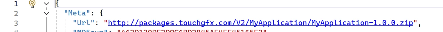

The 'MyApplication.json' file contains metadata for a URL which contains the name 'MyApplication'
Looking at other TBS json files, this should be the project name.

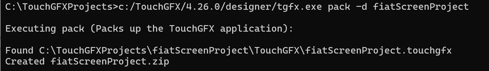

This is the pack command that I used
..and these are the generated files.

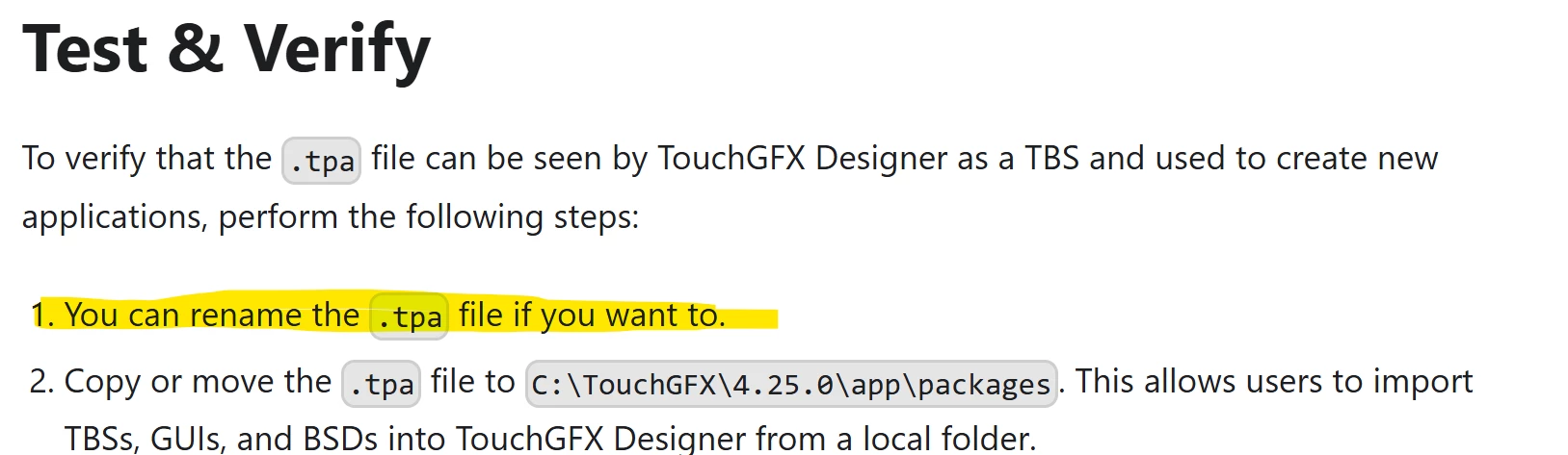

I went on to change the name of the .tpa file (as the documentation says you can). After doing so the TBS failed to work, previously the TBS showed as being available offline but now shows that it is available for download and gives a Download error when the Create button is pressed.
I now believe this explains my original issue.
In summary, I wish to report the following issues with the TBS generation and documentation.
  1. When tgfx.exe pack -d is executed then sometimes the resulting json file is literally named 'MyApplication' and the final .tpa file is also named 'MyApplication'. This may or may not be associated with the size of the donor project.
  2. If the .tpa is renamed then the TouchGFX 'create' seems to look elsewhere for the tpa and tries to download it, resulting in a download error.
  3. Please add to the documentation an explenation of the function of the metadata URL in the JSON file as this appears to be refencing the TBS from a remote location. A security concern would be if the .tpa (i.e. the content of the donor project) is being stored on a remote server.

Thank you for your post, I will try to investigate that. The point 1 seems to be a bug to me, tgfx.exe pack -d  should create your tpa with the provided name. For point 2, I would recommend not to rename manually, but I agree with you that it shouldn't behave in a strange way if renamed. For point 3, we will consider to document it better if its needed.

Hello @Okeskin and @RobNewbury ,
After multiple attempt I couldn't reproduce the described issue. When I launch this command, It always create me the right files with correct names (I'm also using 4.26.0 version of TouchGFX btw) :
It’s possible that the problem may be related to the specific project you are working on. If you’d like, you can share the project with me, and I can try to replicate the issue on my side. Otherwise, I’m afraid I may not be able to provide further assistance.
