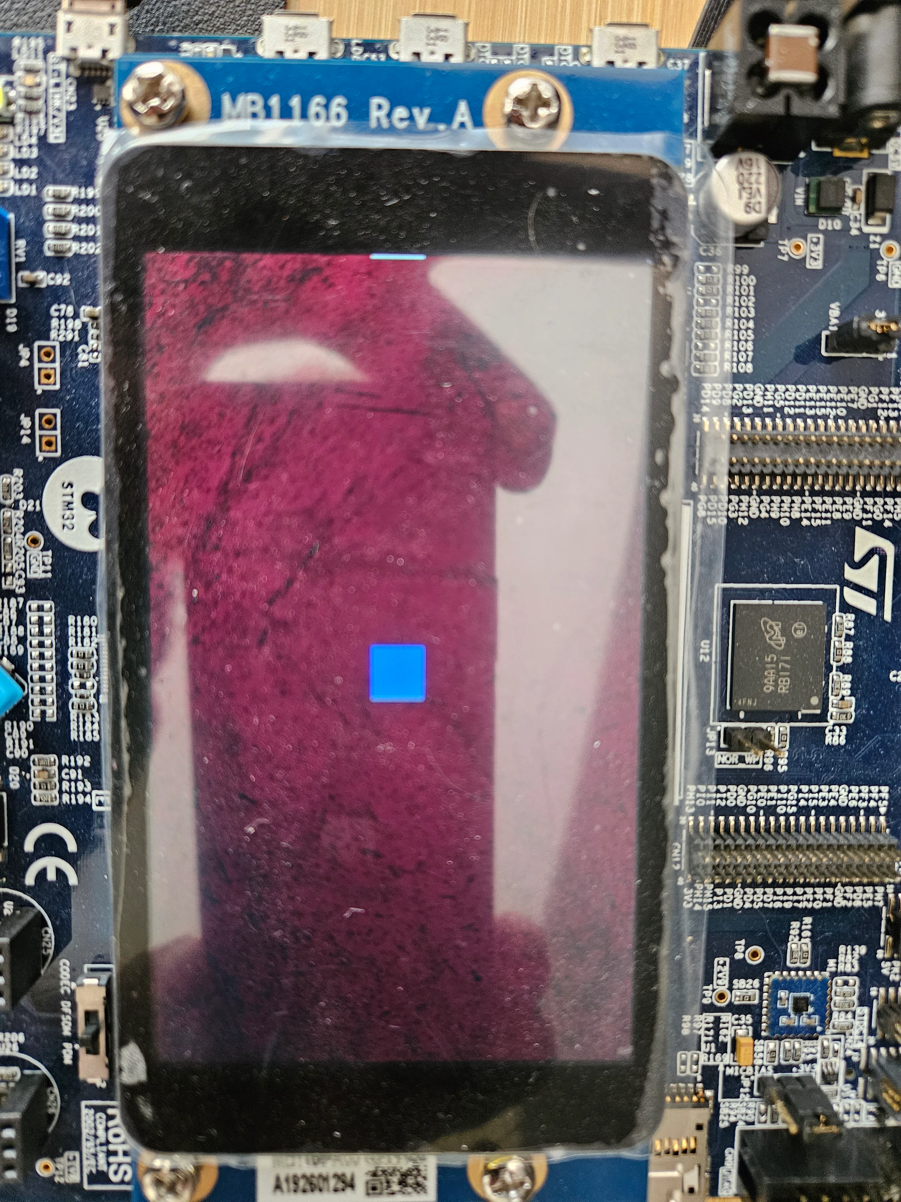

I have an issue that caused me a few hours of troubleshooting. And a few tears.

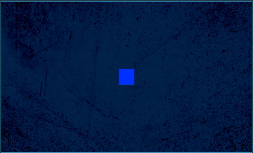

I am using the stock background bitmaps on a few screens. They have a blue color to them:
So, blue background image with a blue box in the center. But, here is what it looks like:
What am I missing? Is there an additional step to get bitmaps with blue to render correctly?

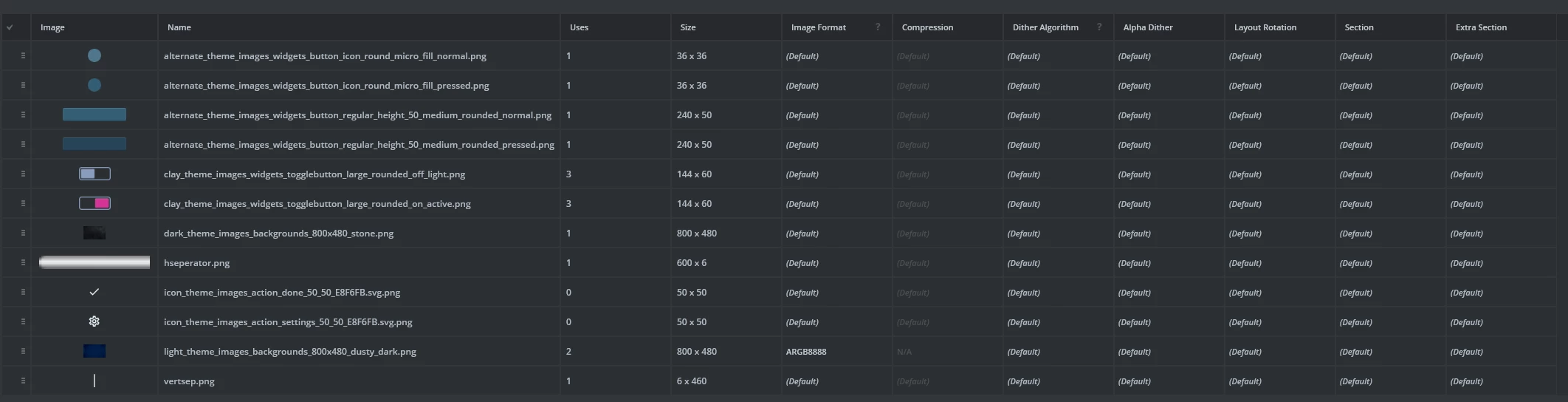

I figured it out. Image format selection in the Images section:

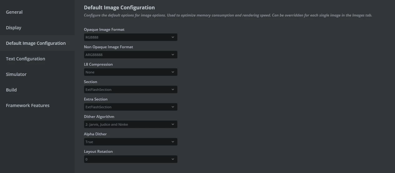

Is there a way to determine the image encoding beforehand?
And, my default configuration is set to ARGB8888. Why manually setting it to ARGB8888 for the image worked, is still a mystery.
