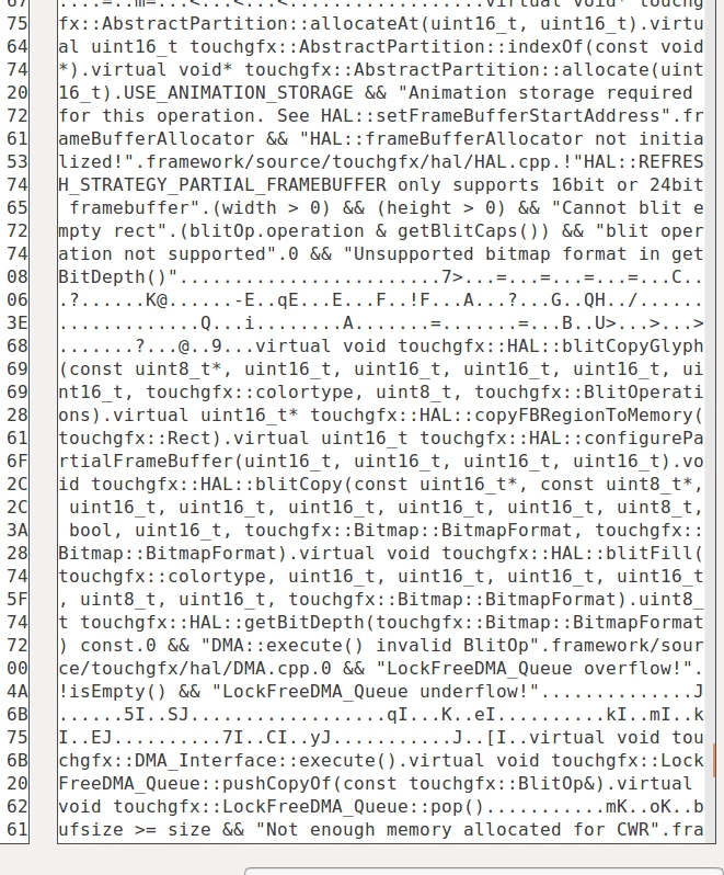

When building my project using touchgfx, I generate a specific binary file for some images. So for the testing purpose I create a section with only one image of one black pixel. So basically this image in binary format should be around 2 bytes in 16BPP. However the binary seems to include in addition to this image some debug information like "GCC: (GNU Tools for ARM Embedded Processors 6-2017-q2-update) 6.3.1 20170620 (release) [ARM/embedded-6-branch revision 249437]" etc.
It does not seems to have a specific release or debug configuration in the makefile. the overhead in the in quite unlikely and in some of the other binary, I also have some absolute path of my own computer. Is there any way to remove all those information ?
Regards,

The GNU toolchain should contain this tool - arm-none-eabi-strip
It can "strip" the debug (and other) symbols from the binary.
Docs: https://www.mankier.com/1/strip

@After Forever​ I have tried strip as objcopy parameter or directly within the tools. It does not change anything :\ I tried strip-all or just the debug, does not change anything. I precise that each time I clean/rebuild my whole program for the testing.
@Community member​ I generate the binary using objcopy with --only-section parameter with the hex file as input. the image itself i generated with the touchgfx tools imageconverter.out.

Ok, so sounds like it is embedded in the code coming from some other libraries or objects. Your options there would be to check if it is using release versions of those objects/libraries, or if any command line settings into the compiler and/or linker are causing these things to appear.

I am using the default Makefile of touchgfx sample projects with just light modification to create stecific binaries for the images.
basically the options are :
linker_options += -g -Wl,-static -specs=nosys.specs -specs=nano.specs \
                 -mno-thumb-interwork \
                 -fno-exceptions \
                 -O0 -fno-strict-aliasing -Wl,--gc-sections
linker_options += -mcpu=cortex-m7 -Wno-psabi $(float_options)
c_compiler_options += -g \
                   -nostartfiles -mthumb -fno-exceptions \
                   -mno-thumb-interwork -std=c99 \
                   -O0 -fno-strict-aliasing -fdata-sections -ffunction-sections
c_compiler_options += -mthumb -mcpu=cortex-m7 -Wno-psabi $(float_options) -DCORE_M7 -D__irq=""
cpp_compiler_options += -g -mthumb \
                   -nostartfiles \
                   -mno-thumb-interwork -fno-rtti -fno-exceptions \
cpp_compiler_options += -mthumb -mcpu=cortex-m7 -Wno-psabi $(float_options) -DCORE_M7 -D__irq=""
I tried to remove the -g option (not so sure about the meaning) but does not change anything. I also try to remove the "-fdata-sections -ffunction-sections" options.
As the imageconverter.out binary is provided by touchgfx, I am not sure about the way it is build.
What I can tell is that the .o of my 1 pixel image already include those "useless?" data. There is no real specs on the imageconverter options except the one in the project example which concerns only image format as I can understand.

Can you show us some examples of what you're experiencing? By default we use arm-none-eabi-strip to strip libtouchgfx.a when building the core library with arm-gcc (And equivalent for gcc).

Sorry for late reply, I was off for a few days. I am sorry to say that I do not find any solutions... I am afraid I will have to deal with it. It is just disapointing to lose so much memory for nothing.

Hello, I know this post it a little bit old, but I'm seeing a lot of code information from the touchgfx library in the microcontroller's binary. I checked optimization, also I stripped debug info, unneeded and other flags, and the same.
Any idea what can be happening?
Here is a picture of what I'm seeing in the binary. I don't think this was compiled as a debug info.
