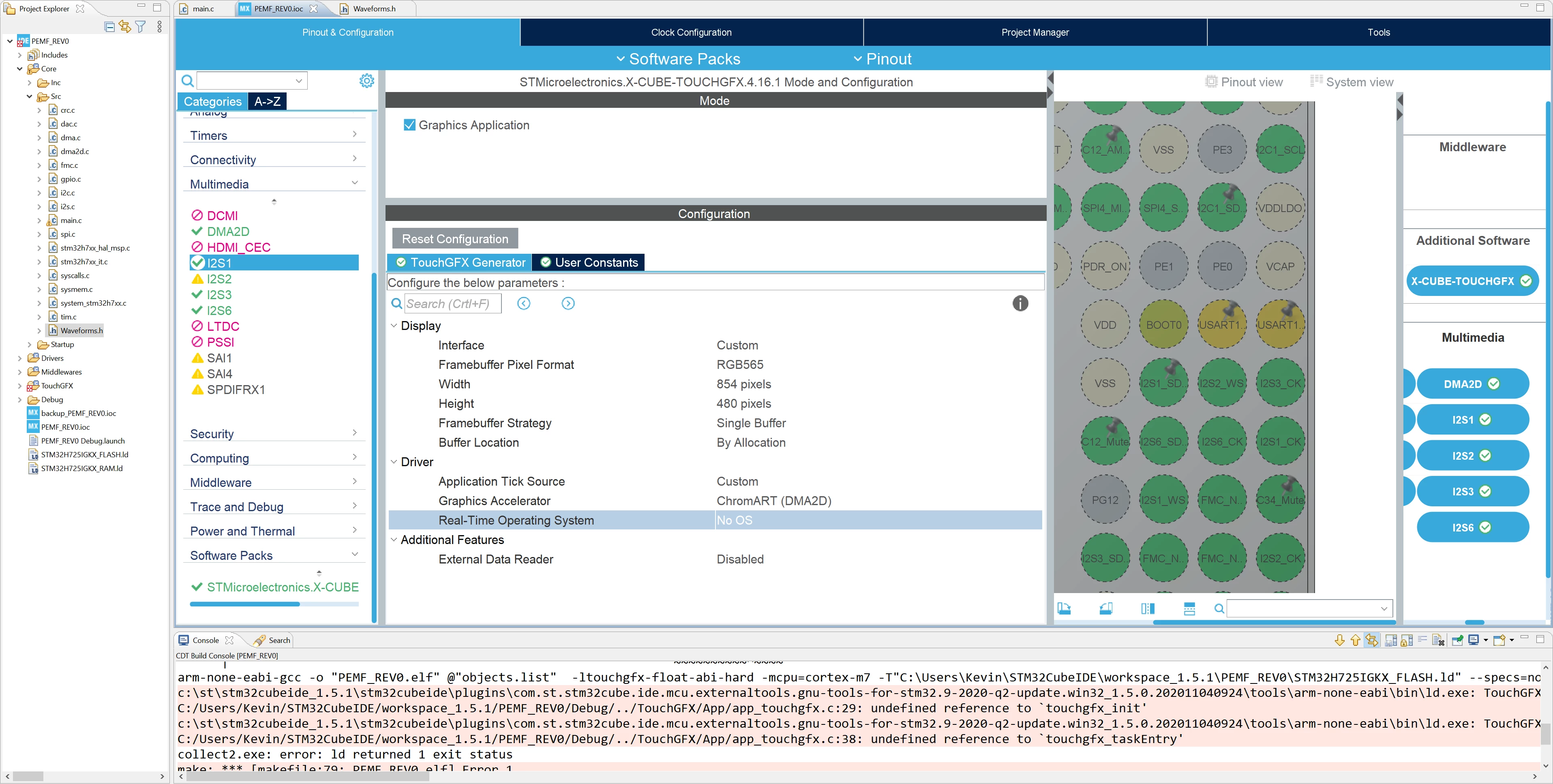

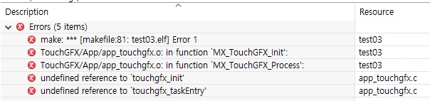

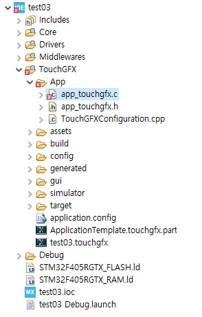

TouchGFX/App/app_touchgfx.o: in function `MX_TouchGFX_Init'
***Settings

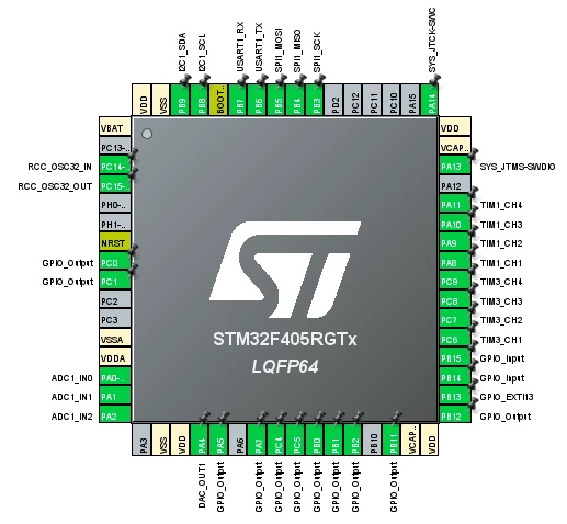

MCU: STM32F405RG
CubeMx: 6.2.0
CubeIDE: 1.6.0
TouchGFX: 4.16.1
Firmware Package: FW_F4 1.26.0
0693W000008y84wQAA.pngI am trying to port a program designed in Windows to firmware.
STM32CubeIDE was the first time I used it, so I studied it through the community.
And, I proceeded the work in the following order.
1.Select MCU via STM32Cubemx
2. Pinout setting
3. Select TouchGFX from software pack
4. generate code
5. Create 1 page with shapes in TouchGFX
6. generate code
7. Run STM32CubeIDE
8. Run Debug
For reference, I haven't written any user code.
Then the following message appeared.

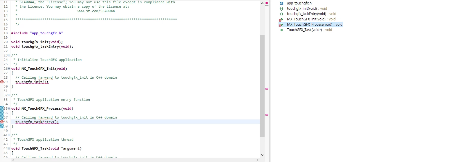

undefined reference to 'touchgfx_init'
Settings related to TouchGFX appear to be a problem, but I haven't been able to find the cause.
Could you please let me know the problem?

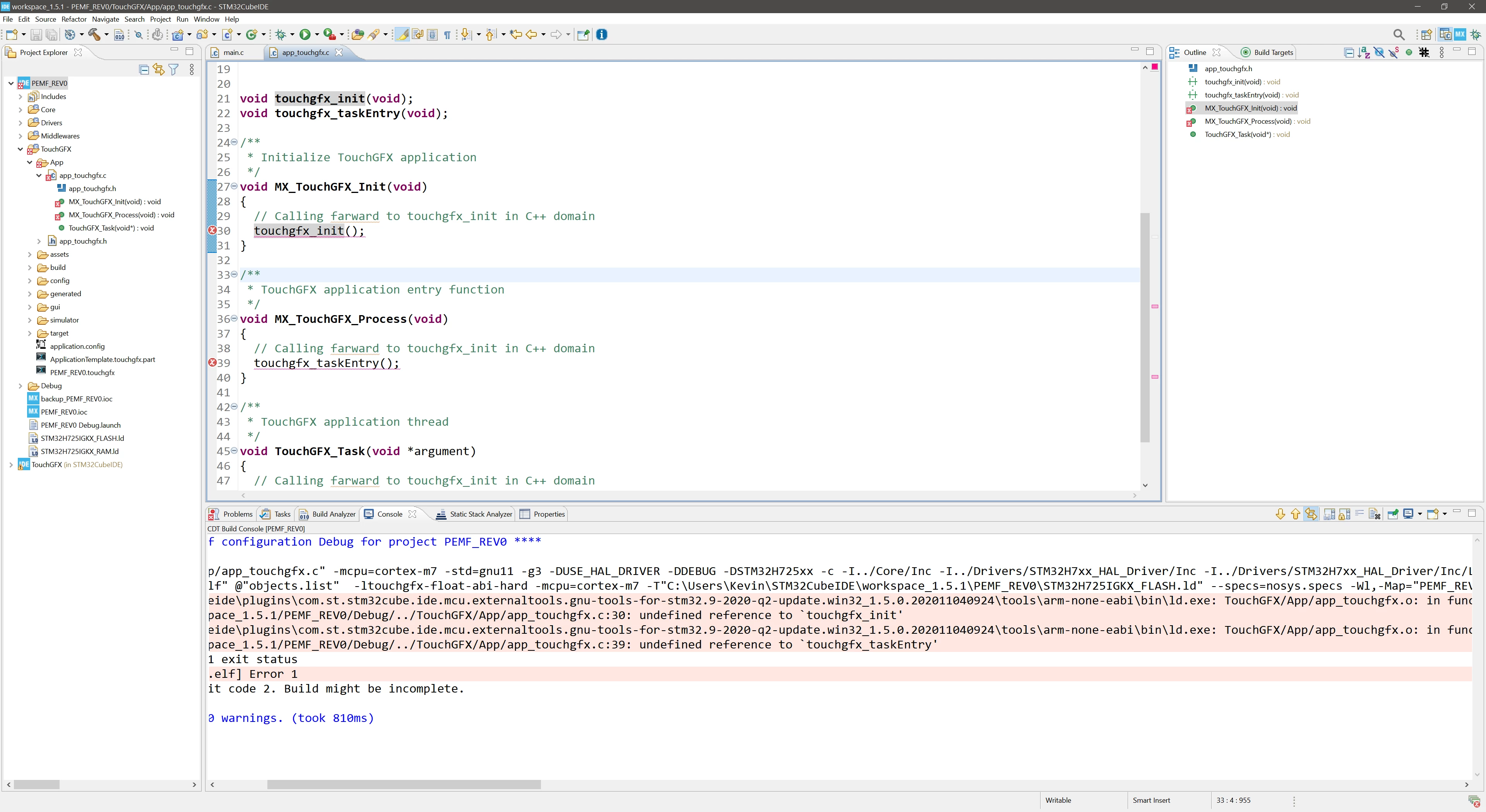

Hi did you ever solve this problem? I'm having the same exact issue...
Kevin

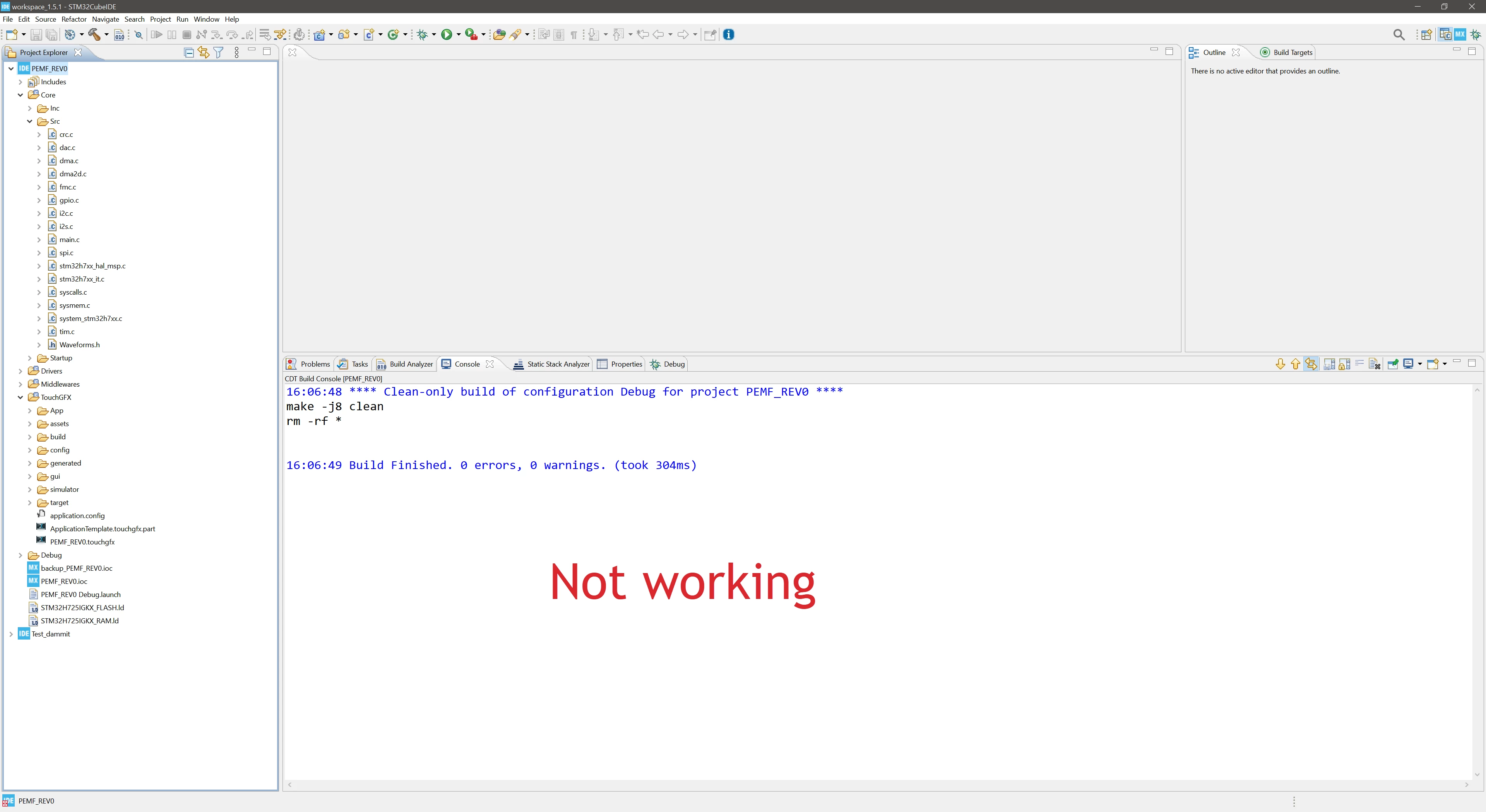

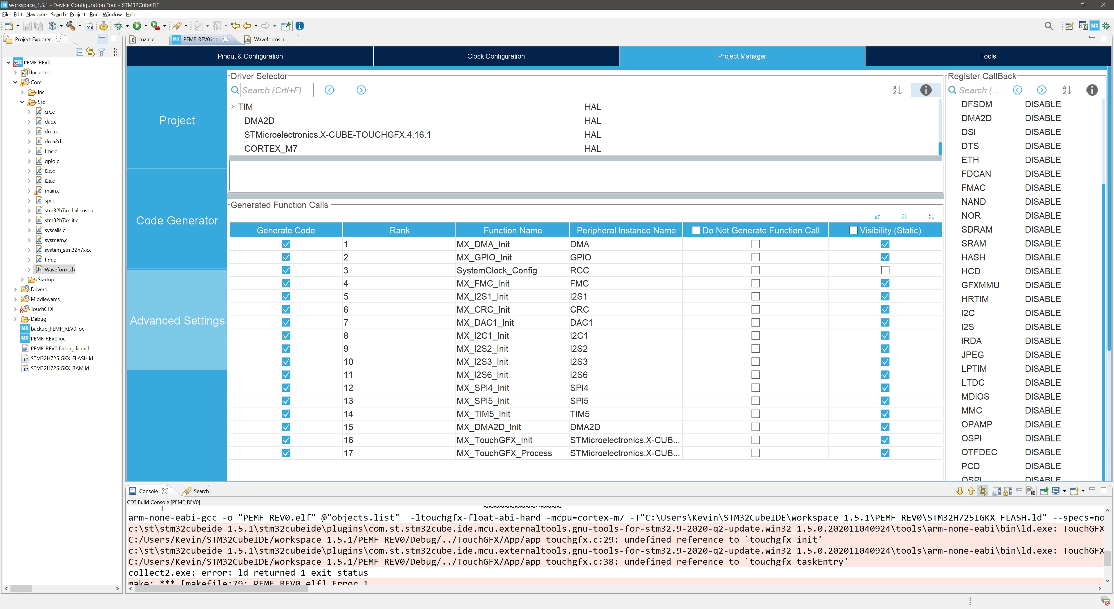

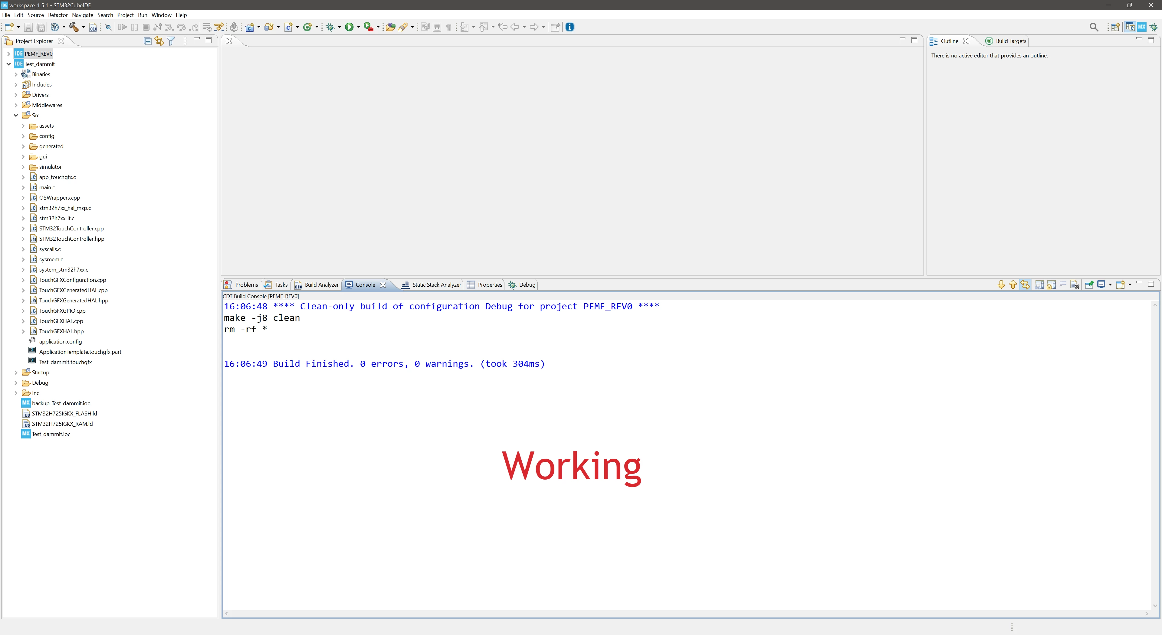

0693W00000AMIXvQAP.png0693W00000AMIXmQAP.pngRomain,
After reading all day/watching videos and almost giving up hope, I created a new blank project going through Mx first to generate files and that worked. Earlier I started with the STM32cubeIDE. Maybe that was the problem? Also I remember TouchGFX or MX being updated to next version (current one that is out now). This could also have caused a problem? Or simply my file structure was wrong because generating all the files from MX, then opening it in the STM32cubeIDE gave me a very different file structure... :face_with_tears_of_joy:
Romain DIELEMAN
April 23, 2021
I am happy to hear that it works now at least :grinning_face_with_sweat:
You are right concerning the path difference between creating a project from CubeMX or CubeIDE, it seems very likely that this could be the source of the error (which is then fixable as well, but just move on, no need for you to spend more time on it.
To be honest I always start my project from CubeMX for this reason (this is our process as well when we create new application templates since we wish to also support different toolchains/IDE), I need to force myself to start creating projects directly from CubeIDE, since most of the users like you do it, in order to try to face the same errors.

Something else I observed too. STM32CubeMX 6.1.1 is my version when I created opened this app independently and created the working version. When I accessed the MX from my STM32cubeIDE the version was 6.2.1...

I am facing the same issue in my device please guide me the reason why its not resolving I tried three or four times but its the same result every time.
Romain DIELEMAN
May 27, 2021
Could you give more information on your setup ? What version of TouchGFX/STM32CubeMX/STM32CubeIDE are you using ? What MCU are you using ? Are you using a custom board or a ST development kit ? Are you using an RTOS? Could you share your project or screenshots of your errors ?
/Romain

I'm facing the same exact problem as mentioned in this thread in the start.
Versions of software's
STM32CubeIDE 1.7.0
STM32CubeMX 6.3.0
TouchGFX 4.17.0
I'm using STM32H757I-eval board.
And I'm not using RTOS.
I have tried creating the project from the STM32CubeIDE and STM32CubeMX
But still I'm getting the same exact errors as the screenshot in the beginning.
I have tried all possible ways I could but I'm not able to solve the issues.
Please do provide me a solution for the same.
