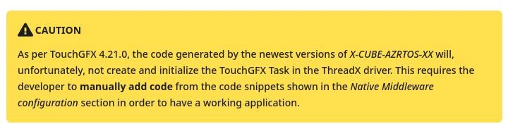

I have started a proof of concept project that runs ThreadX and TouchGFX on a custom QSPI display on STM32F7.
I noticed from the documentation at https://support.touchgfx.com/docs/development/touchgfx-hal-development/scenarios/scenarios-configure-rtos that the following warning is highlighted.

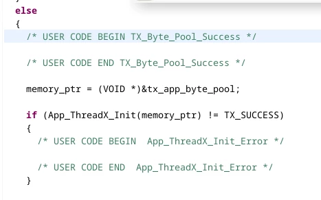

Now indeed when I generate the code from CubeMX the MX_TouchGFX_Init is not getting called from anywhere, and in the documentation it suggests to call it from app_azure_rtos.c in the tx_application_define method.
However in such method the main thread is already been initialized.
If i replace App_ThreadX_Init with MX_TouchGFX_Ini, I am getting a TX_POOL_ERROR.
What am I supposed to do to initialize TouchGFX?
Thank you

I was able to make some progresses and get some code that would init the TouchGFX:
However I still need to figure out how to convert a screen into a framebuffer and send it to my spi display.

Your startup code looks fine to me.
To answer you second question; if you have set up TouchGFX to use single or full framebuffer and place by allocation, your framebuffer will be allocated outside the OS memory by TouchGFX in /target/generated/TouchGFXGeneratedHAL.cpp.
