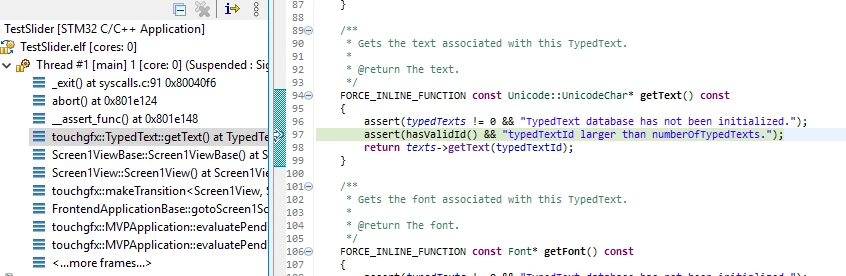

This problem has arised when creating a more complex program and I have narrow it down to a single test.project. I have created the usual project for the STM32F769 Disco using TouchGFX 4.20 Designer . I have set only one single TextArea, configured a wilcard to use the buffer with enough space and initial value of 0. The wildcard range is 0-9
Then, I have exported the source code and I have modified it in STM32CubeIDE 1.10.1 and HAL1.16 to increase a counter in Screen1View::handleTickEvent() with the following code
Unicode::snprintf(textArea1Buffer,TEXTAREA1_SIZE,"%u",ctr++);
textArea1.resizeToCurrentText();
textArea1.invalidate();
ctr is a uint32_t protected member in Scereen1View.hpp
The problem is:
- Executable generated by the simulator runs as expected.
- Elf compiled and flashed by the TouchGFX Designer runs in the target as expected.
- Elf compiled by STM32CubeIDE does not work.It crashes when initializing the TextArea1 in Screen1ViewBase
Unicode::snprintf(textArea1Buffer, TEXTAREA1_SIZE, "%s", touchgfx::TypedText(T___SINGLEUSE_YO0H).getText());
either by not passing an assertion in touchgfx::TypedText::getText() (assert(IsValidID...) or some other times (I cannot say when) by triggering the MemManage_Handler.

jtpgilejAuthor
Aug 3, 2023 10:49 AM UTC
Please, follow the link to get the zipped project.
I also enclose a capture of the stack when running the compiled version from STM32CubeIDE.
Thank you in advance.

Hello
Have you remember to update also external flash after CubeIDE build ? For some reason, external flash content is bit different compared the TGFX designer Target build and CudeIDE build. Empty or TGFX target build content on the external flash causes the assertion failure when running cudeIDE internal flash.
Br J.T
jtpgilejAuthor
Aug 4, 2023 7:43 AM UTC
You are right!
I have that in mind when I use the CubePrgrammer to restore the boards to their default demo, but I overlooked it in CubeIDE. Thank you for your help.
