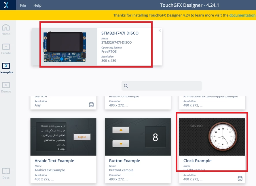

Could you please tell which "Clock Example"  you are referring to?
KenwangAuthor
October 7, 2024
I use this combination
