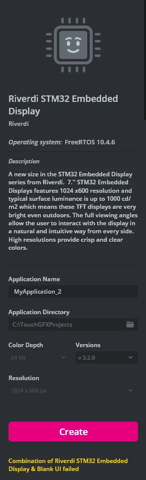

I simply wanted to create a new TouchGFX project for Riverdi STM32 Embedded Display.  It gave me "Combination of Riverdi STM32 Embedded Display & Blank UI failed" error all the time.
I've tried uninstall the legacy versions and re-install, but no luck.

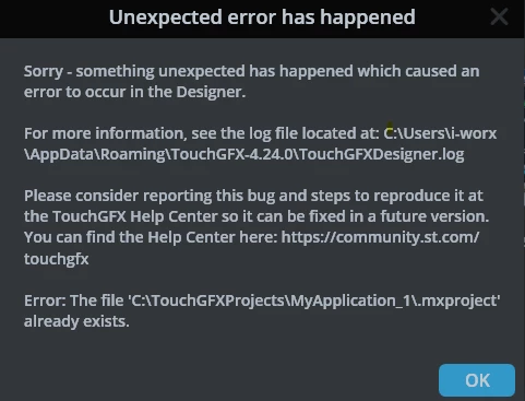

Please see error log attached.

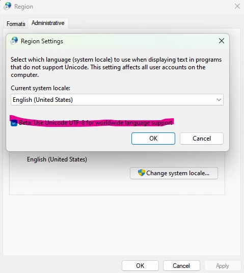

V4.22.0 and .1 gave failure while code generation:
C:/TouchGFX/4.22.0/env/MinGW/msys/1.0/Ruby30-x64/lib/ruby/3.0.0/win32/registry.rb:910:in `encode': U+7F51 to IBM437 in conversion from UTF-16LE to UTF-8 to IBM437 (Encoding::UndefinedConversionError)
Above checkbox fixed the encoding error.

    The checkbox resolved the project creation error.
    Running on target error might need to be discussed and resolved in other threads.

    Hello, I've just installed TouchGFX Designer and it gave me the same "Combination" error trying the Custom Trigger Action Example with the STM32H7B3I-DK demoboard (correct resolution). It gave me the same error for another valid example.
    Closing TouchGFX Designer and restarting the system solved the problem on the next instance of TouchGFX Designer in my case.

    Hello @Eric Z. ,
    Based on the error, it seems like you are trying to create a project in a directory that was previously used.
    Could you please create a project in a different directory? (the path should not contain spaces)
    And also, could you please try different projects? I wonder if it is specific to the Riverdi TBS or not
    Thank you
