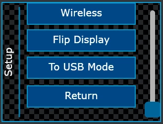

i have few problems with the new version of Touchgfx 4.22

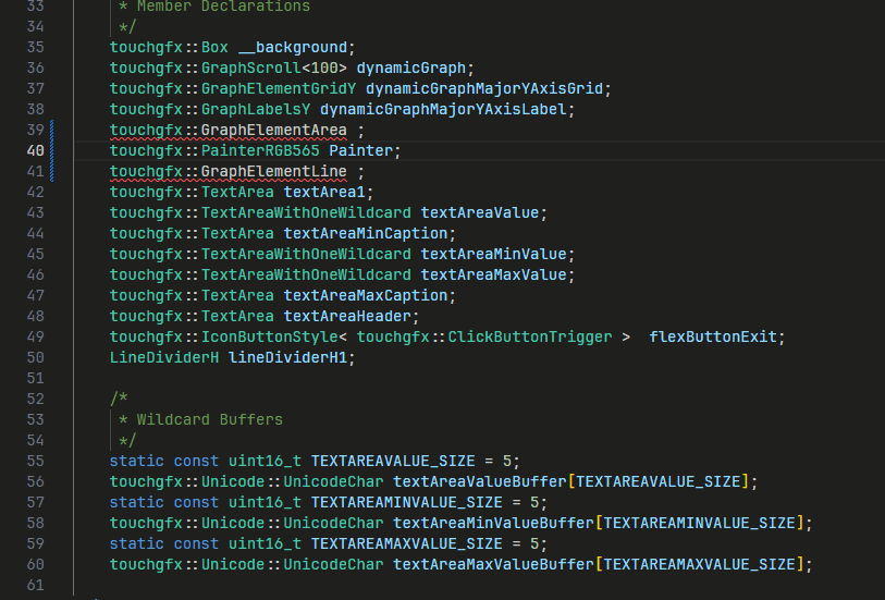

1. When using Dynamic Graph every time the code is generated the Base class is broken. This effect was also observed in previous versions.
If the Line / Array sequence is changed and restored again and the code is generated again then all is well.

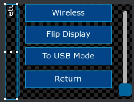

2. On Touchgfx 4.22 I have problem with vertical text
version 4.21.4
version 4.22
Greetings Boyan Panchev

Hello @Panchev68,
1) I cannot reproduce this problem with code generation, could you please share your project here ?
2) That's indeed something we need to investigate, I reported it.
