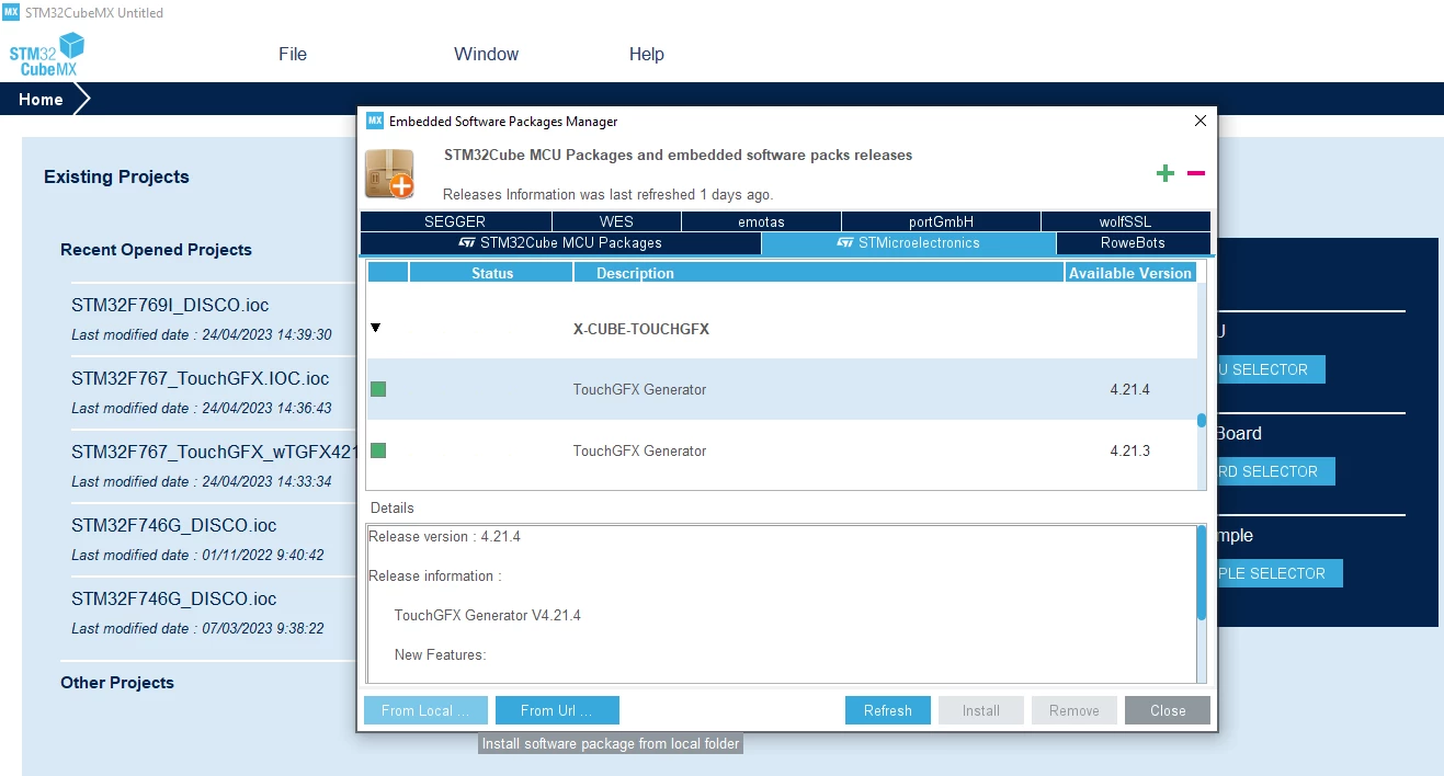

Attention : If X-CUBE-TOUCHGFX 4.21.4 is not available in STM32CubeMX software yet, please navigate to "Help > Manage embedded software packages > STMicroelectronics > X-CUBE-TOUCHGFX". Then click on "From Local ..." and navigate to the x-cube-touchgfx-4-21-4.zip file to install the new pack inside STM32CubeMX.
