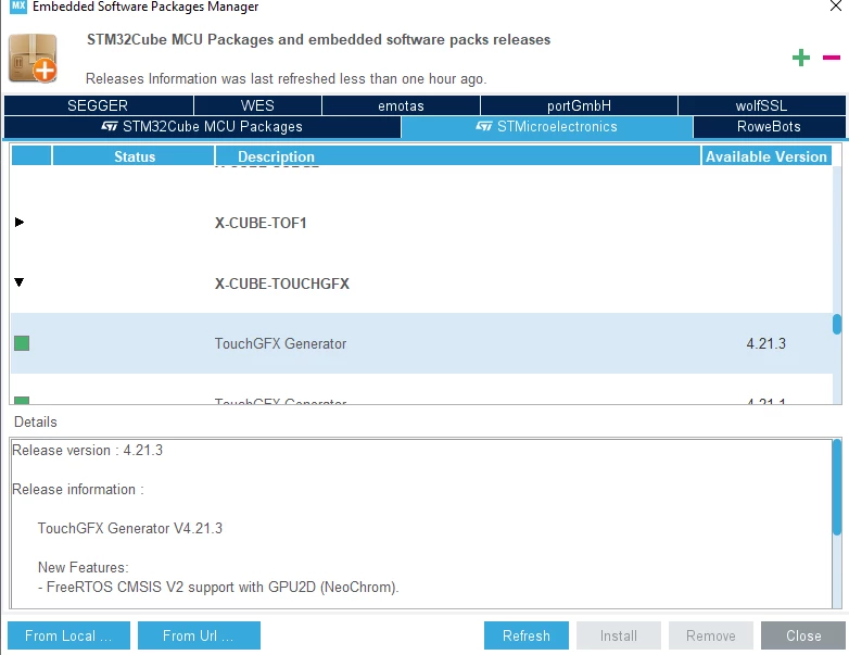

ACapo.1
Mar 15, 2023 3:55 PM UTC
Hi @JMYGI​
This doesn't seem to be available in "Embedded Software Packages Manager" in STM32CubeIDE, is there a way of manually installing this download into the IDE?
Thanks
Andy
Edit: No worries, I used the "From Local" button on the zip. All installed now.

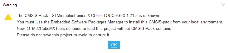

I have seen this anouncement and installed the updated TouchGFX Designer, opened my project (*.tgfx) and migrated it to the up-to-date-version. Didn't expect any problems with CubeMX, because it's just a patch-release. Now CubeMX won't work anymore, because this version is not available in the Package Manager yet (als @ACapo.1​ already said).
0693W00000aJBJaQAO.pngPlease release interdependent software packages at the same time, so this can not happen. When will the 4.21.3 be available in CubeMX?

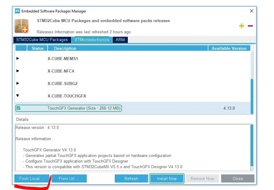

Romain DIELEMAN
Mar 17, 2023 7:45 AM UTC
Like Acop did, enable it by using the "From local" option in the "Manage Embedded Software Packages" option in STM32CubeMX like in the screenshot below. You need to navigate to where you have your en.STMicroelectronics.X-CUBE-TOUCHGFX.4.21.3.zip folder, so I guess your Download folder.
0693W00000aJBUsQAO.pngI am also surprised that it is not available in STM32CubeMX yet, I suppose it will arrive very soon. It is out of range of the TouchGFX team unfortunately.

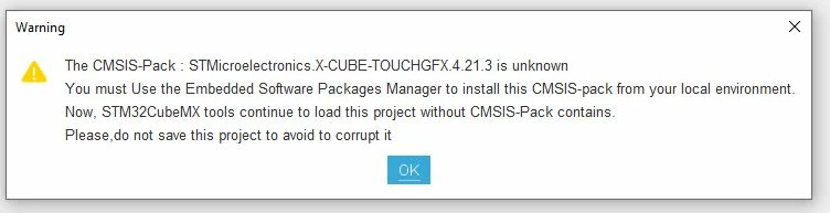

Mar 23, 2023 6:05 PM UTC
Hi Romain,
thanks for your post.
I reloaded TouchGFX 4.21.3 as you suggested. This brought no result. Both warnings are unchanged. It confirmed my guess that the problem is in the incomplete installation of CubeMX 6.8.0. Further more I checked whether there is a new .zip for CubeMX 6.8.0. Unfortunately it today (23.03.23) has exactly the same bit size as on 13.03.23. So the CubeMX-team did nothing up to now. For I am not the only victim please help to get them working. Without having installed the "CMSIS-Pack" CubeMX is useless. Please contact the supervisor of that team. To fix this mistake should not be a real problem for those people.
Thanks for your help.
Thilo
