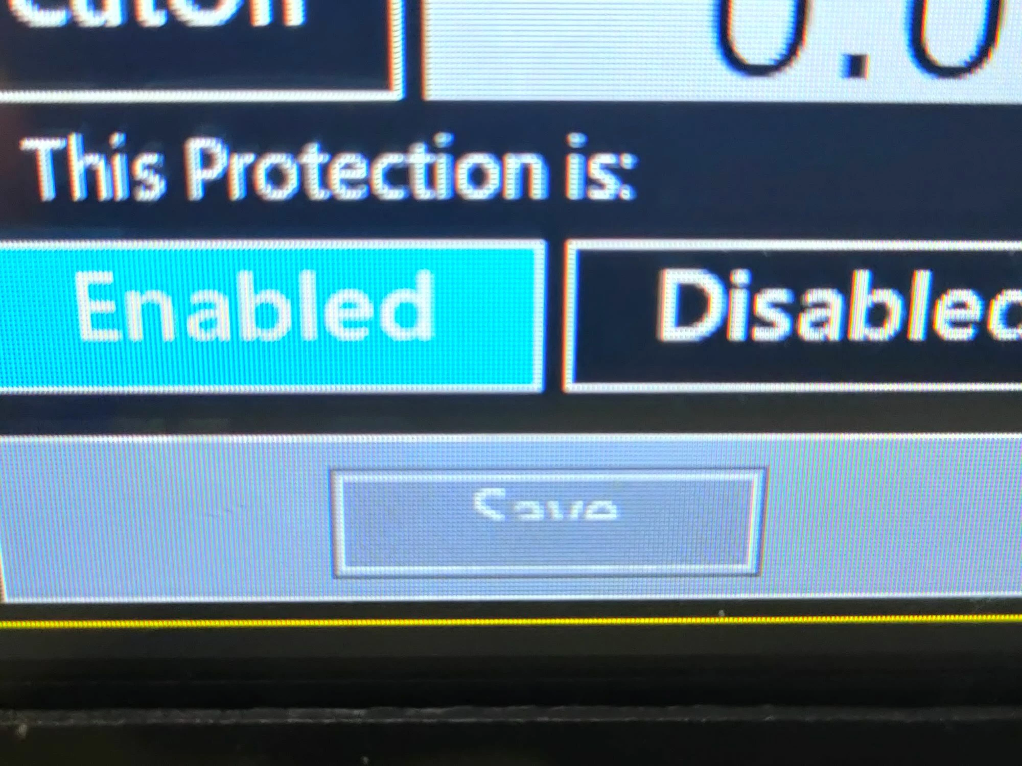

since i Updated to TouchGFX 4.21.0 (from 4.20.0) the LCD shows a visual artifact
it happens when rendering images in the L8_565 format (plain RBG_565 works) or text
i'm using a STM32 nucleo board with a STM32H7A3 processor
when i generated the code with CubeMX 6.6.1 and TouchGFX 4.20.0 it worked without artifacts
but after i updated to CubeMX 6.7.0 and TouchGFX 4.21.0 it started showing these artifacts:

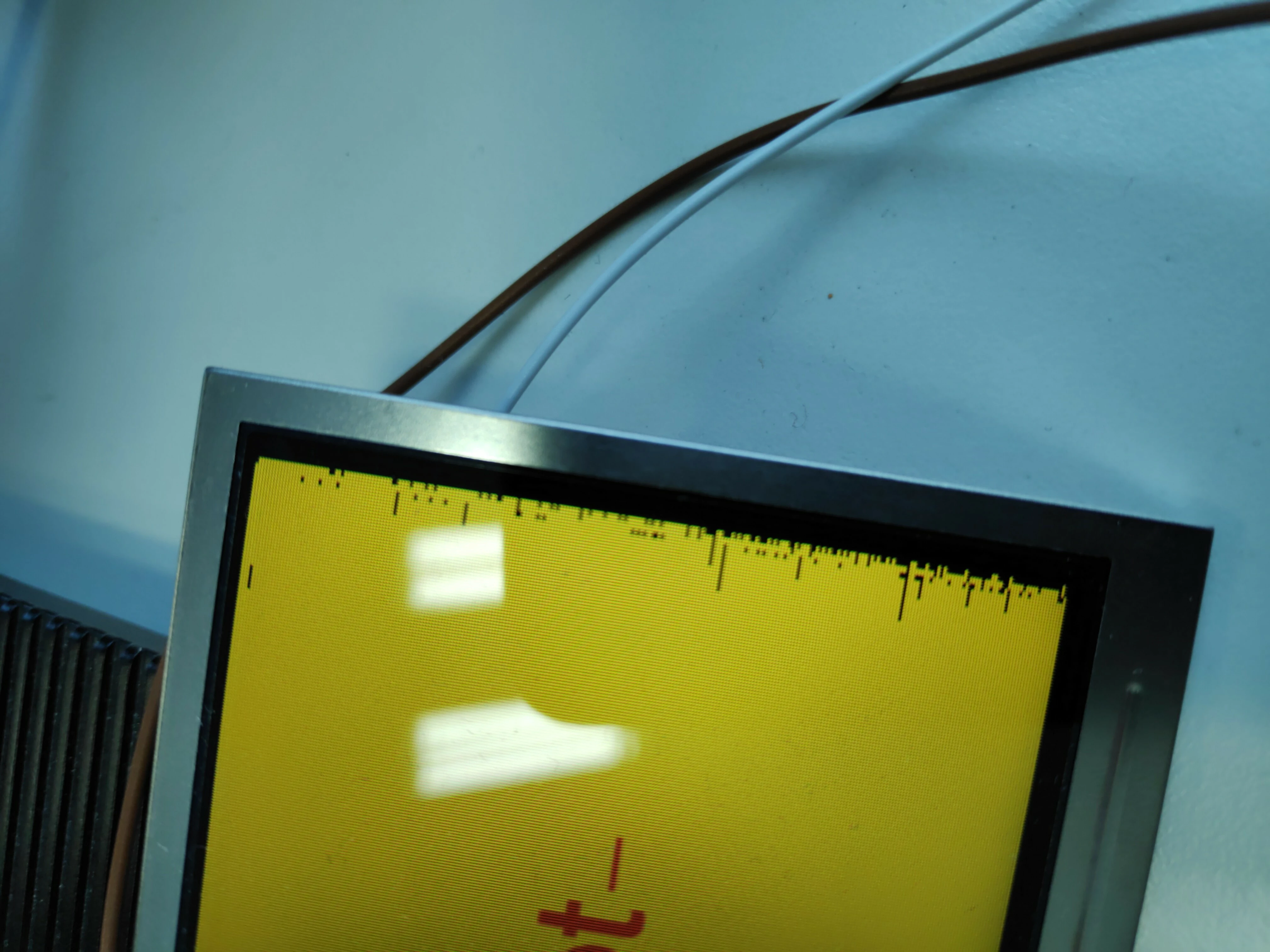

example 1: this full screen image should have a solid yellow background, it is revealed using a wipe transition from black to the image. The wipe transition leaves black artifacts on the right edge (transition goes from left to right)

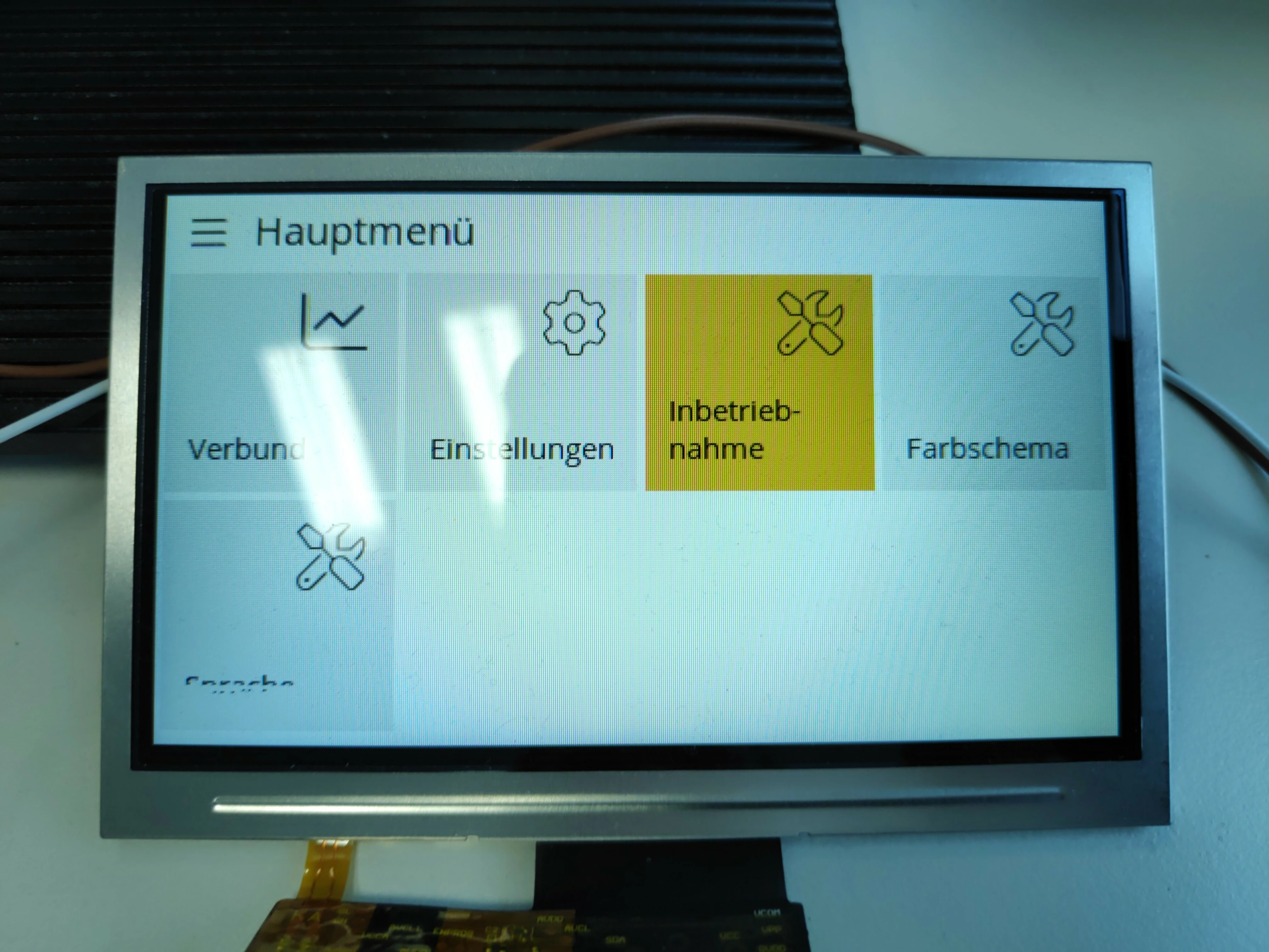

Example 2: the text on the last menu tile is sometimes cut in half, it should say "Sprache"

addendum: the problem with the full-screen image only occurs when using the L8_RGB565 format and not with the plain RGB565 format
So i assume that the problem occurs, if a lookup table (CLUT) is used. Since afaik Text rendering also used the color lookup table functionality

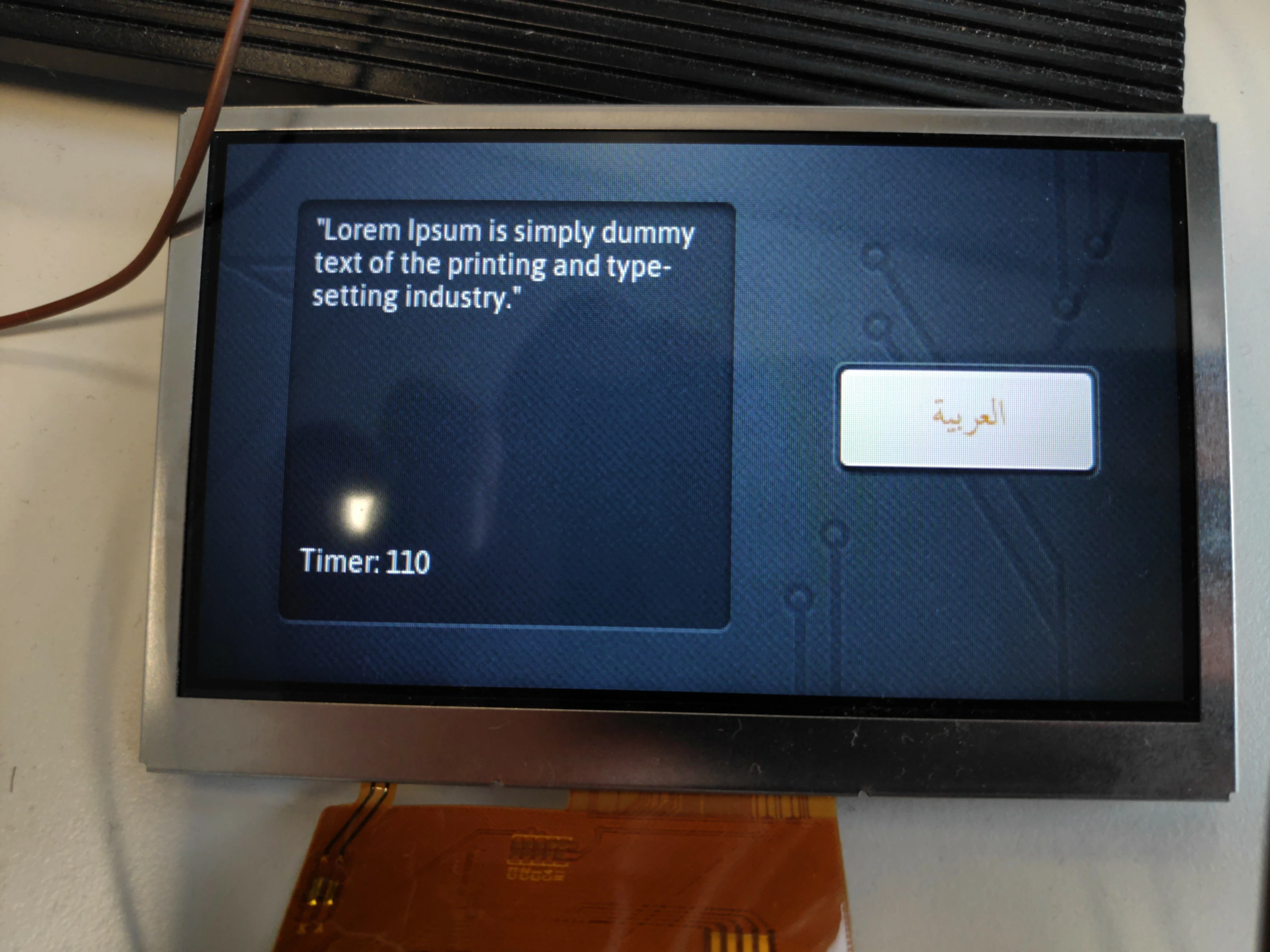

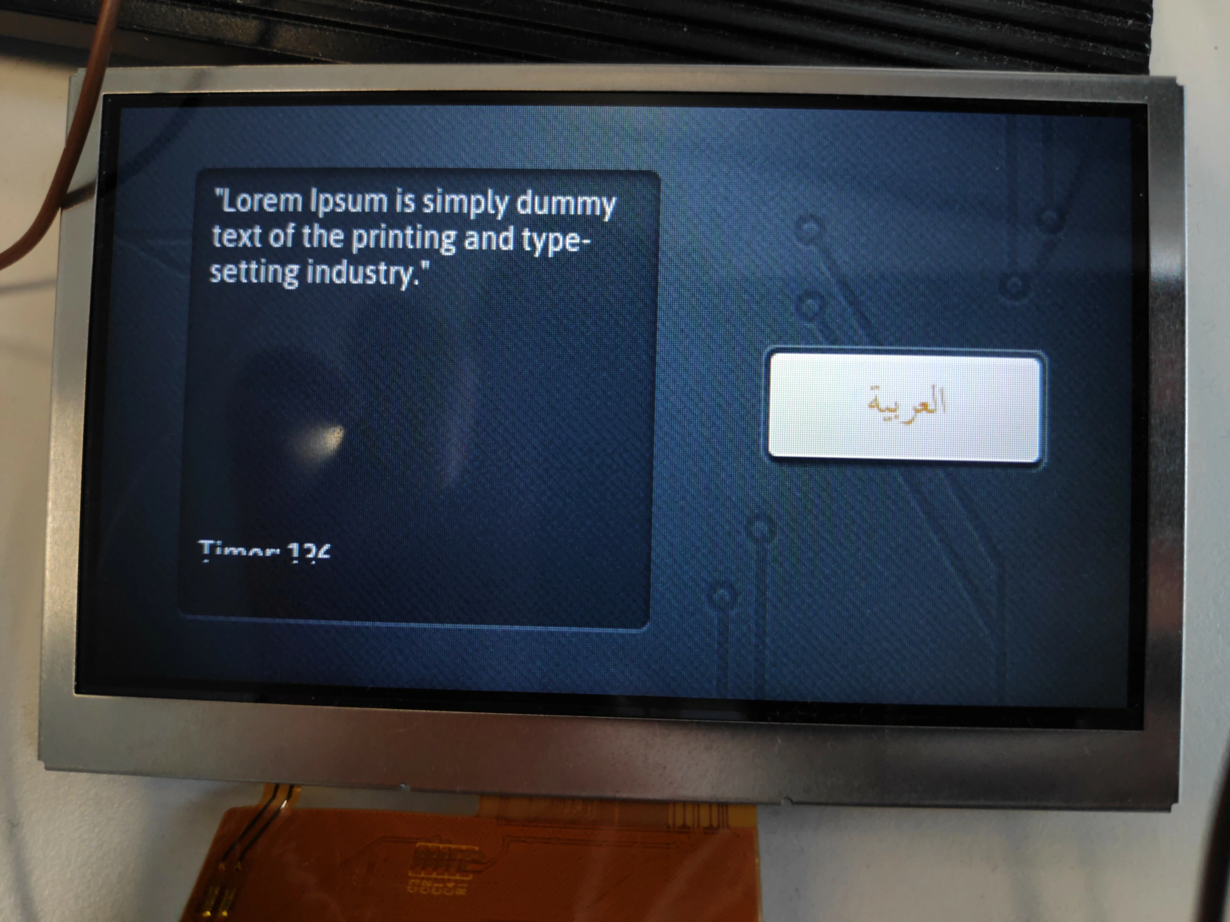

Photos of the example project:
sometimes the text is rendered correctly:
0693W00000Y8AxeQAF.jpgbut sometimes the text is cut off:
sadly we don't have another board to test it on

i have now reproduced the bug on the STM32H750B-DK and have attached the project
and i've noticed that the bug only occurs, if the CPU data cache is enabled.
So i think it's a data synchronization issue between the DMA2D and the CPU

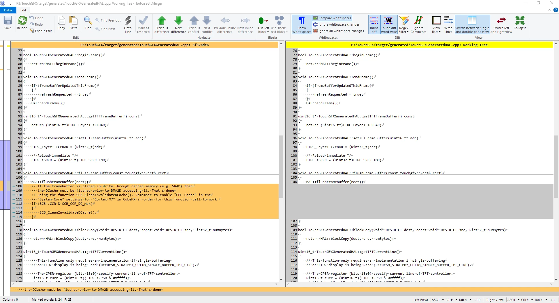

I've also noticed that a call to SCB_CleanInvalidateDCache() was deleted from TouchGFXGeneratedHAL when updating from 4.20 to 4.21:
this gives us two ways to avoid this issue:
  1. disable the DCache for the RAM
  2. re-add the call to invalidate the DCache (TouchGFXGeneratedHAL::InvalidateCache) in TouchGFXHAL::flushFrameBuffer()

If you don't need DCache that's fine to disable it, but having DCache shouldn't cause the issue I would expect.
And concerning the SCB_CleanInvalidateDCache funtion, there's no reason to call SCB_CleanInvalidateDCache() function in flushFrameBuffer(), we changed that because it was a mistake in first place. The SCB_CleanInvalidateDCache() function is useful only if we do software and hardware rendering, and it should be called only when we need to synchronize the data from the cache and RAM. We have on our support website an article talking about this subject, maybe you'll be interested to have a look at it.

the statemachine described there seems to be not working correctly.
The call to invalidate the cache in flushFrameBuffer might have masked that problem in earlier versions (4.20 and earlier).
In the TouchGFX versions since 4.21 the UI shows the artifacts mentioned above, if DCache is enabled.
our current workaround is to use the MPU to set the RAM to non-cacheable
EDIT: i think the problem occurs, because the DCache is set to write-back by default, but should be configured as write-through since the LTDC is always directly reading from RAM and might miss updated data that the CPU rendered into the DCache.
