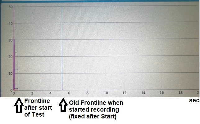

TouchGFX 4.20.0. Vertical Frontline Problem in Dynamic Graph Widget
Hello all,
I am using the Dynamic Graph to display incoming data over time. The frontline moves forward on the x-axis as expected.
Then the user presses the Start Button to record the data, I clear the graph and restart at 0. The vertical frontline also restarts from position x.
BUT: the previous frontline position is not removed in the graphics and stays there as a vertical non-moving line until the current frontline overwrites it.
How can I remove this "old" vertical frontline?
I have tried the following:
graphicVerticalFrontline.setVisible(false);
graphicVerticalFrontline.invalidate();
graphic.clear();
graphic.invalidate();
graphicVerticalFrontline.setVisible(true);
Has anybody an idea how to remove the old frontline?
BR GS

Yoann KLEIN
Jul 18, 2022 9:49 AM UTC
I tried to reproduce your issue, but it works fine for me.
I began with the Dynamic Graph Example available in TouchGFXDesigner.
Then, I added
graph.clear();
graph.invalidate();
in the handleTickEvent() method, in order to clear the graph content on a regular basis.
I also checked "Wrap and Overwrite" and "Vertical Frontline" options available in the Dynamic Graph Widget configuration.
In my project the Graph data and the Frontline are cleared correctly every 180 ticks.
You can find my project attached to this post.
