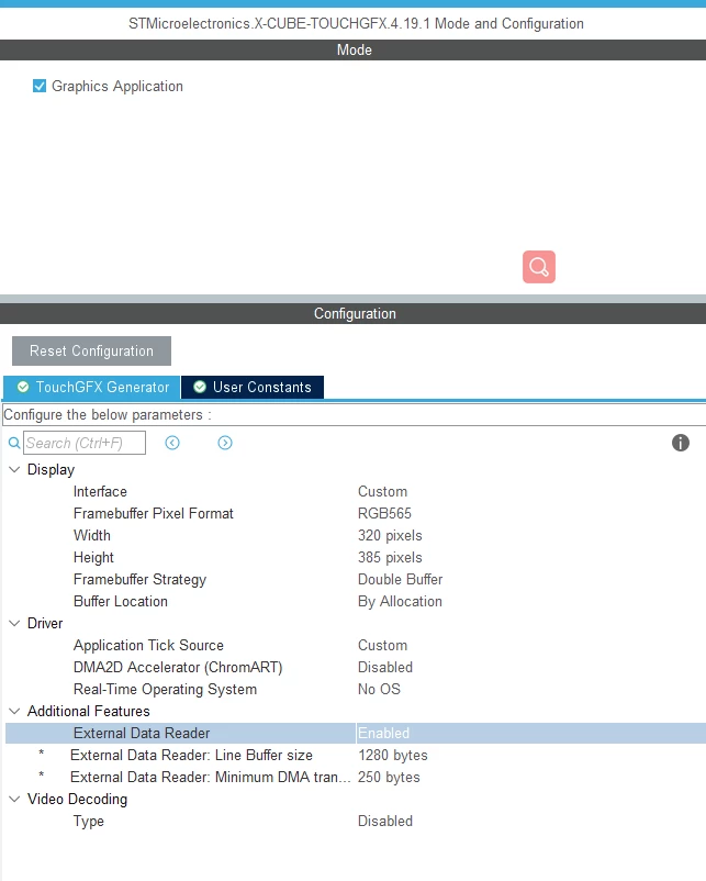

As the screen interface uses FSMC, we do not use the official example project, but use the Keil project generated by CubeMX. For the screen driver, we use FSMC+DMA to drive, and for RTOS, we use RT-Thread. The cubemx configuration is as follows:
0693W00000QKLSFQA5.pngBefore, we used frame cache to display images in Partial Buffer, which was normal. However, when we switched to Single Buffer or Double Buffer, various abnormal states appeared
