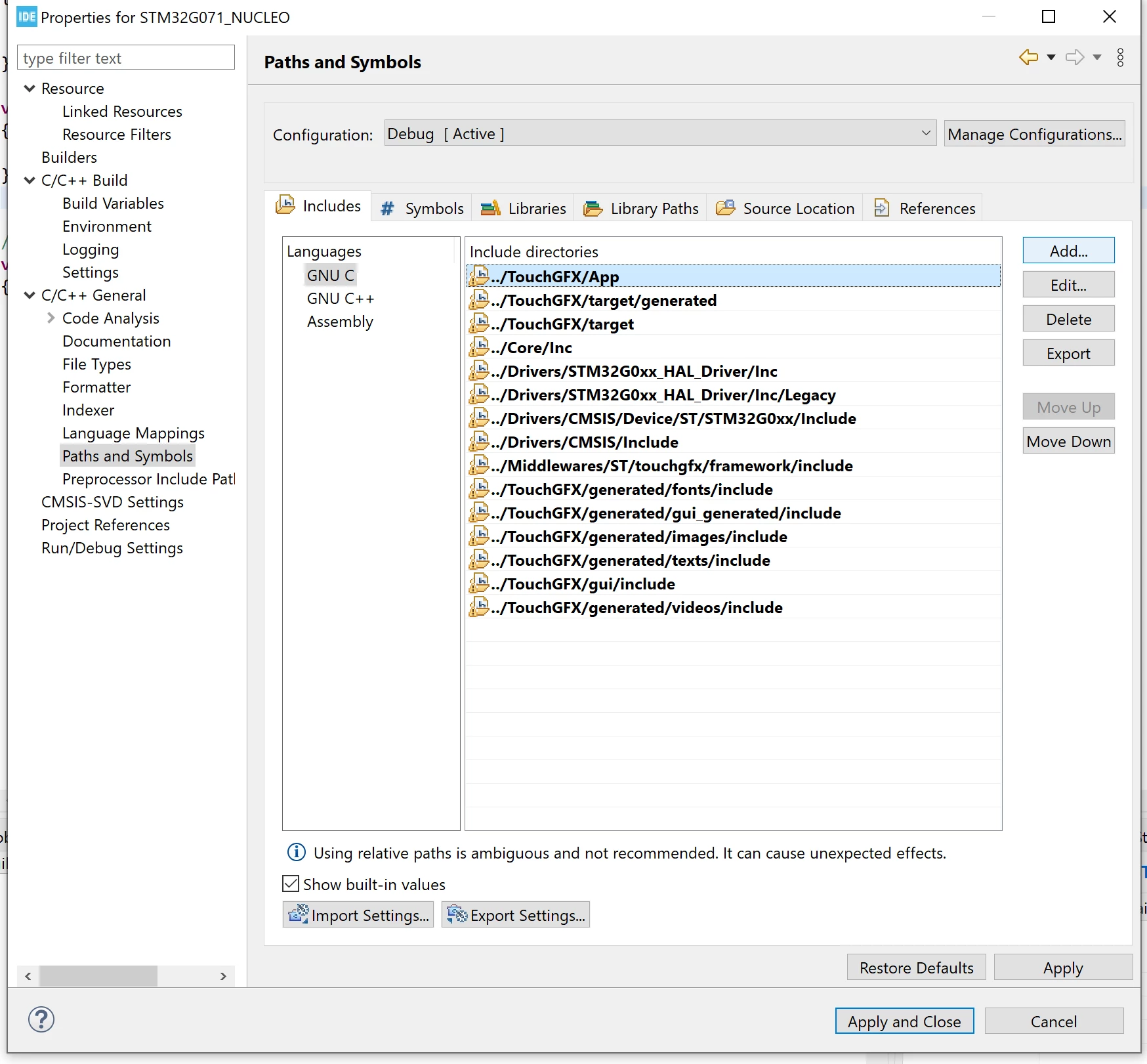

Hi there,
I am just starting touchGFX. I created a project in following steps:
  1. create IOC file.. enable touchGFX 4.20.0 , choose display as BW, 128*64, interface:custom, and generate code via STM32CubeMX for STM32CubeIDE.
  2. open .part file via touchGFX designer... choose blank templete to import.
  3. add widget: text area. Save and generate code in touchGFX designer.
  4. go back to STM32CubeIDE, open project. and refresh project.
  5. build project...
Then I got the compilation error in "../TouchGFX/target/generated/TouchGFXConfiguration.cpp:35:8: error: 'LCD1bpp' does not name a type
  35 | static LCD1bpp display;".
seems some header file is not included... so the class definition is not included... but I understand from the doc, all these generated files are not supposed to be modified... So I am asking for help: anything I did wrong here?

Hello @DHan.2​ ,
Did you try to add LCD1bpp.hpp file reference in your project ?
This file is located at Middlewares>ST>touchgfx>framework>include>platform>driver>lcd.
In STM32CubeIDE, open your project properties and go to the "Path and Symbols" tab.
Then, click the add button and browse to the folder I mentioned above.
Please let me know if that solved your problem or not.
/Yoann

Aug 16, 2022 7:52 AM UTC
Thanks. Yoann.
I add the include path as you mentioned above... still same error.

Are you also correctly calling this header file ?
In the include part of TouchGFXConfiguration.cpp there should be this :
" #include <platform/driver/lcd/LCD1bpp.hpp> "
/Yoann
