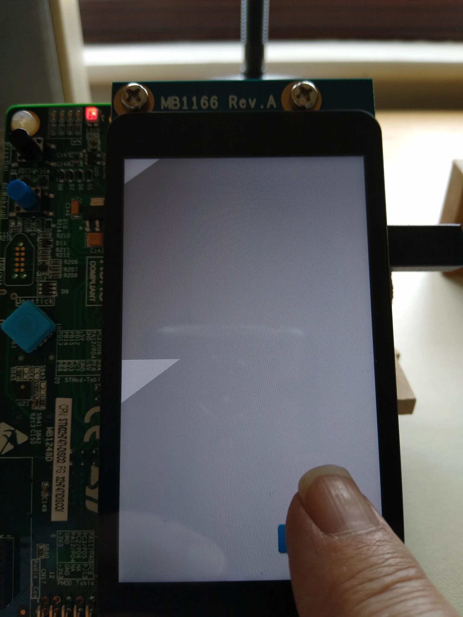

I am working with TouchGFX and an STM32H747I-DISCO. I have created a very simple project comprising two screens.
Each screen has a box covering the entire canvas (one set to white and the other to black) plus a single button in the bottom right corner.
I added an interaction for each screen so clicking the button swaps between screens.
When I create this project in TouchGFX 4.19.1 and program it into the STM32H747I-DISCO board, a triangular shaped artefact or glitch appears momentarily in the top left and mid left positions of the display (see attached image) on each screen change.
By comparison, I recreated the exact same project from scratch in an older version of TouchGFX (4.16.1) and that had no issue at either 16bpp or 24bpp.
Could you investigate what is going wrong. I am rather stuck if this cannot be resolved as the issue is quite noticeable and would not be acceptable in a finished product.

Osman SOYKURT
Jun 15, 2022 10:20 AM UTC
Hello Rob H,
Thanks for you report! Indeed there's a bug here with this STM32H747I-DISCO board. I'll keep you updated when we have a patch for that.
And yes, the compatibility between version 4.16.1 and 4.19.1 of TouchGFX Designer of this particular board is not optimal because it uses different version of the board (the one on v.4.19.1 uses dual core for example), so you won't be able to have the same project structure.

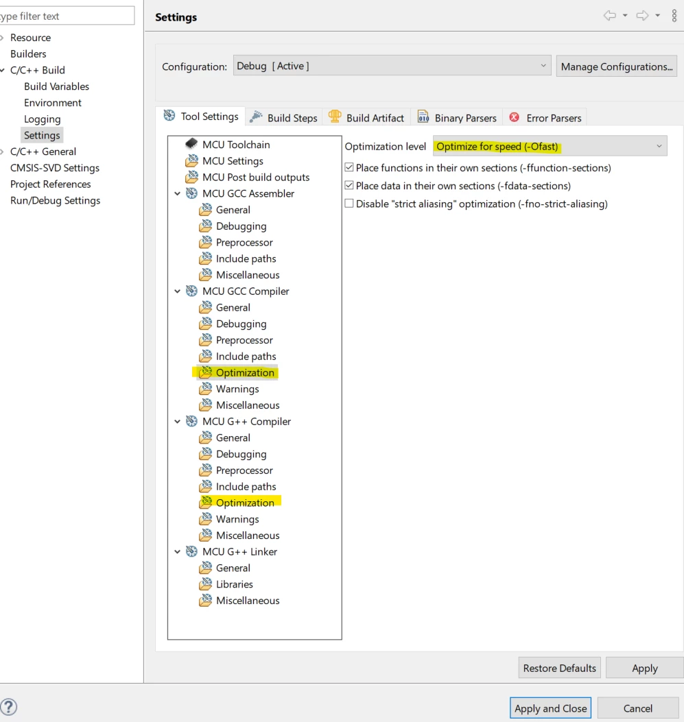

Osman SOYKURT
Jan 18, 2023 1:54 PM UTC
Hello Rob H,
We have investigated this bug and we think it's a speed issue. I can suggest you to use the optimize for speed (-Ofast) optimization in your project, that would do the job.
Best regards,
