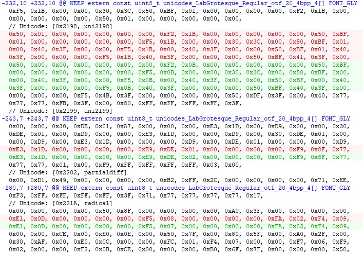

0693W00000QKD87QAH.pngI am adding one thing here, but the generated fonts are differents between 4.18.1 and 4.20.0. So all people storing fonts in external flash and do not expect to update it will be stucked again (this already appears somewhere between 4.13 and 4.18 as I remember, i wrote a ticket for that a few month ago, no solution was available).
