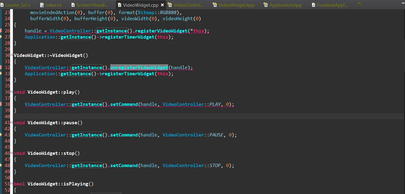

0693W00000FDpnoQAD.pngI have used last released TouchGFX 4.18 to add one .avi video from TouchGFX sample videos to my project but this project does not get compiled in STM32CubeIDE no way and it gives me an error that is listed below:
c:\st\stm32cubeide_1.7.0\stm32cubeide\plugins\com.st.stm32cube.ide.mcu.externaltools.gnu-tools-for-stm32.9-2020-q2-update.win32_2.0.0.202105311346\tools\arm-none-eabi\bin\ld.exe: ./VideoWidget.o: in function `touchgfx::VideoWidget::~VideoWidget()': C:/TouchGFXProjects/MyApplication_5/Middlewares/ST/touchgfx/framework/source/touchgfx/widgets/VideoWidget.cpp:32: undefined reference to `touchgfx::VideoController::getInstance()'
c:\st\stm32cubeide_1.7.0\stm32cubeide\plugins\com.st.stm32cube.ide.mcu.externaltools.gnu-tools-for-stm32.9-2020-q2-update.win32_2.0.0.202105311346\tools\arm-none-eabi\bin\ld.exe: ./VideoWidget.o: in function `touchgfx::VideoWidget::handleTickEvent()':
C:/TouchGFXProjects/MyApplication_5/Middlewares/ST/touchgfx/framework/source/touchgfx/widgets/VideoWidget.cpp:68: undefined reference to `touchgfx::VideoController::getInstance()'
c:\st\stm32cubeide_1.7.0\stm32cubeide\plugins\com.st.stm32cube.ide.mcu.externaltools.gnu-tools-for-stm32.9-2020-q2-update.win32_2.0.0.202105311346\tools\arm-none-eabi\bin\ld.exe: ./VideoWidget.o: in function `touchgfx::VideoWidget::draw(touchgfx::Rect const&) const':
C:/TouchGFXProjects/MyApplication_5/Middlewares/ST/touchgfx/framework/source/touchgfx/widgets/VideoWidget.cpp:104: undefined reference to `touchgfx::VideoController::getInstance()'
c:\st\stm32cubeide_1.7.0\stm32cubeide\plugins\com.st.stm32cube.ide.mcu.externaltools.gnu-tools-for-stm32.9-2020-q2-update.win32_2.0.0.202105311346\tools\arm-none-eabi\bin\ld.exe: ./VideoWidget.o: in function `touchgfx::VideoWidget::VideoWidget()':
C:/TouchGFXProjects/MyApplication_5/Middlewares/ST/touchgfx/framework/source/touchgfx/widgets/VideoWidget.cpp:26: undefined reference to `touchgfx::VideoController::getInstance()'
c:\st\stm32cubeide_1.7.0\stm32cubeide\plugins\com.st.stm32cube.ide.mcu.externaltools.gnu-tools-for-stm32.9-2020-q2-update.win32_2.0.0.202105311346\tools\arm-none-eabi\bin\ld.exe: ./VideoWidget.o: in function `touchgfx::VideoWidget::play()':
C:/TouchGFXProjects/MyApplication_5/Middlewares/ST/touchgfx/framework/source/touchgfx/widgets/VideoWidget.cpp:38: undefined reference to `touchgfx::VideoController::getInstance()'
c:\st\stm32cubeide_1.7.0\stm32cubeide\plugins\com.st.stm32cube.ide.mcu.externaltools.gnu-tools-for-stm32.9-2020-q2-update.win32_2.0.0.202105311346\tools\arm-none-eabi\bin\ld.exe: ./VideoWidget.o:C:/TouchGFXProjects/MyApplication_5/Middlewares/ST/touchgfx/framework/source/touchgfx/widgets/VideoWidget.cpp:63: more undefined references to `touchgfx::VideoController::getInstance()' follow
collect2.exe: error: ld returned 1 exit status
make: *** [makefile:89: STM32F746G_DISCO.elf] Error 1
and the function getInstance() witch error is because of that, is defined(declared) in the file " VideoController.hpp" under project root "Middlewares\ST\touchgfx\framework\include\touchgfx\hal" .
I have done nothing else than creating a TouchGFX project and then add it to STM32CubeIDE workspace.
Please help me. I did every thing to project but still does not work.

Is your project a custom project or are you using a TouchGFX Board Setup for one of the ST development boards available in TouchGFX ?
Have you set up Video Decoding in STM32CubeMX in TouchGFX Generator ? This step is necessary to work with the video widget.

Thanks you very much. I did the way you mentioned and the error is resolved. But now after compile and program the board i have just a noisy LCD with no specific picture on it. I think this version of touchGFX has a lot of bugs.
