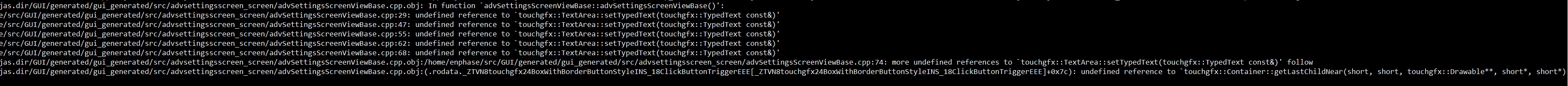

I recently upgraded my project from 4.16.1 to 4.18.1. After integrating the designer files in to my project build environment, I am facing build error with a designer generated file. See attachment. Obviously I cannot modify the generated files to address issue. Please suggest what I am missing.
Best answer by BGuth.1
Never mind. I missed copying files from ..\Middlewares\ST\touchgfx\lib\core\cortex_m7. Build is ok now.
