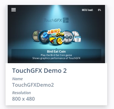

Ltony.1
Ltony.1Author
August 24, 2021
0693W00000DqAQKQA3.pngThanks!

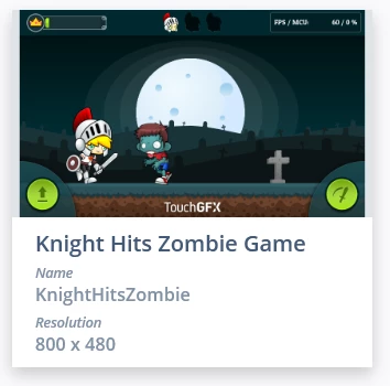

IDE: TouchGFX Designer directly.
The demo Knight Hits Zombie Game is OK.
Build the demo TouchGFX Demo2 failed.
Does the TouchGFX IDE 4.17.0 not support SPI Flash? (I built the Demo2 using 4.16.x and run on 747-Disco board successful.) The TouchGFX Demo2 needs external SPI Flash.
0693W00000DqAQPQA3.png​
